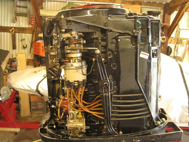

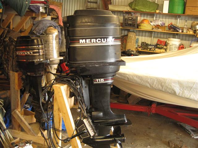

Hi guys! :-) I'm a little rusty, still not doing very well, but sure enjoy this forum.
Another thing that suggests this is an early 1400 at a glance is the smooth port exhaust cover, which was only used in '72 & '73 - I think.
The distributor eliminates it from being the Merc that originally wears the 115 decals it is sporting in your pix.
The new 1400 stepped down when the new 1500 was introduced in '73.
Then the 1500 was eliminated so that the people wanting 150hp would buy the newly intruded v6 150. That allowed Merc to bring back the 1400, which in '79 was actually as close to the old 1500 as you can get. It got power port pistons & adi ignition and was the beast of the inlines until about '82-'83 when prop rating and low dome pistons resulted in it hiding behind 115 decals, but still a brute.
