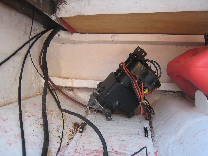

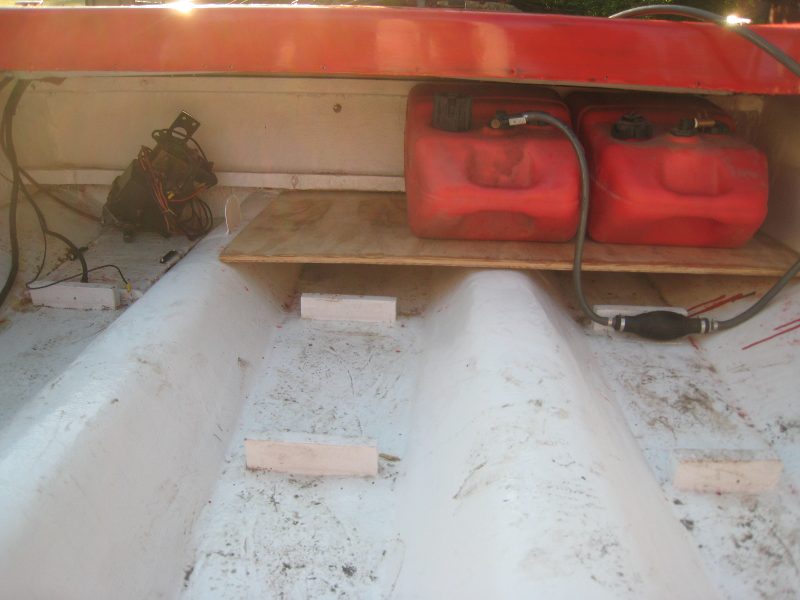

I cut a piece of 3/12 house electric cord this morning the same length as my trim hoses. If I mount the pump all the way to starboard, the jury is out on whether I can get the hoses to the rams. So what to do?

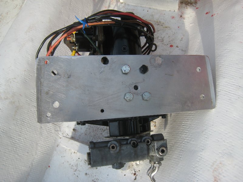

I had put the gas tanks in sideways to fit behind an imaginary rear seat, i.e. so they would be behind the back of the splashpan. If I turned them 90 degrees they stuck out past that edge, and would interfer with a future seat. What I had not though to do was lift them a bit over the cross brace behind them. Presto zippo, looks like this will work. Now I can glass in a picee of plywood betseen the two crossbraces (one holds the edge of the splashpan) and I will have room there to fit it in. I'll make another aluminum bracket to tie the pump to, so that I can easily mount it to the plywood without being some kind of contortionist. It's bad enough as it is!

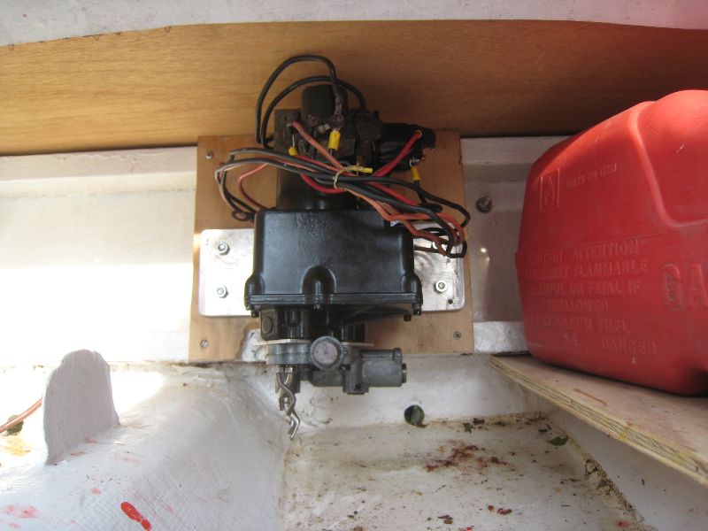

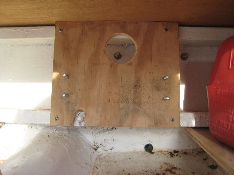

Trim pump mount, mock up 16 years 5 months ago #7211
This is gonna work. Glass it in tomorrow when it's a tad cooler. 80 here. Got stainless screws holding the plywood in place, will remove screws, install back with 5200, then mat and resin over it, top and bottom. Note the hole for accessing the lower motor nut. ;)

Re:Trim pump mount, change of plans 16 years 5 months ago #7243
Plywood glassed in, oil lines installed, hole cut in splashwell for oil line bracket thingie, holes drilled for mounting screws for said thingie, lines running through thingie. Having a donut (w/peanut butter!), helps me think. :)

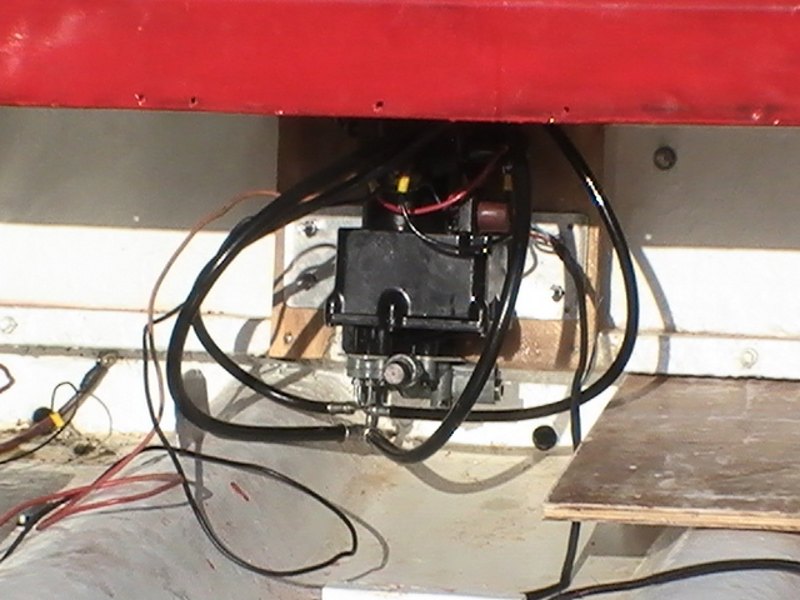

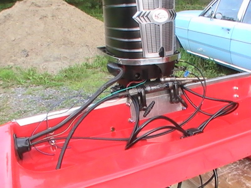

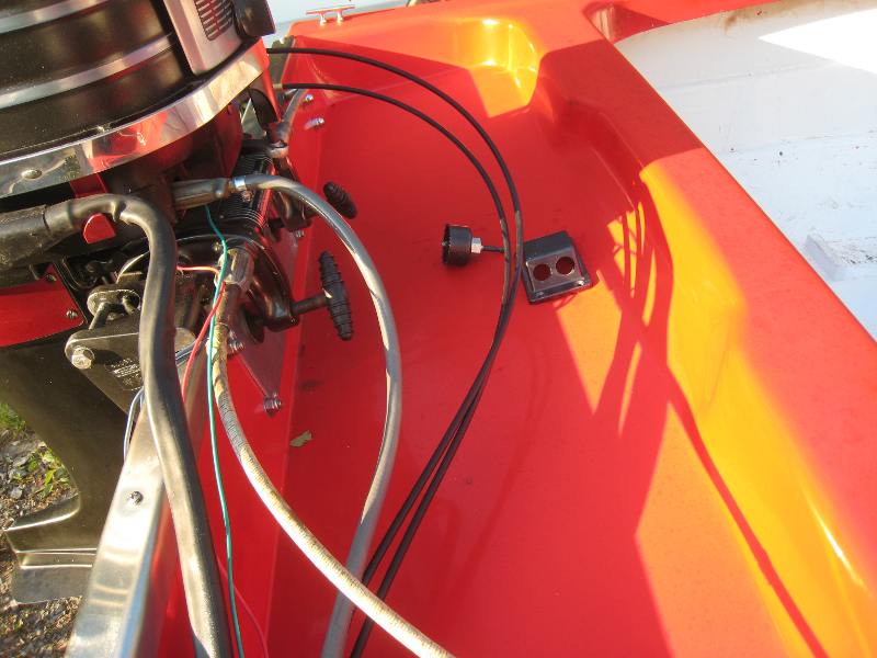

Re:Trim pump mount, change of plans 16 years 5 months ago #7279
Some stills of the pump mount, and of the stern. I covered my crummy looking steering cable and finished of all protruding bolts with acorn nuts. Still got some wiring to wrap with tape, maybe tomorrow. Details, details.
Frank
Re:Trim pump mount, change of plans 16 years 5 months ago #7281
It's coming together, Frank. All those little details add up to a lotta work, huh! Question: have you checked to make sure your elec harness has enough slack when the front of motor turns to the port side? It looks kinda tight, but maybe you have some slack under the splash pan?
