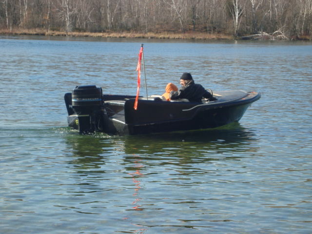

tested out this 81 50hp , runs great after replacing switch box,but it smokes out of the left side upper mount on the top of the driveshaft housing,I am thinking it is the gasket between the housing and powerhead. will this seal up after more use? or should I take it apart and replace the gasket? or maybe just tighten down the bolts?

Otto I don't know about your exhaust problem, but I'm glad to here you got the 50hp running. Just in time for ice fishing LOL.
