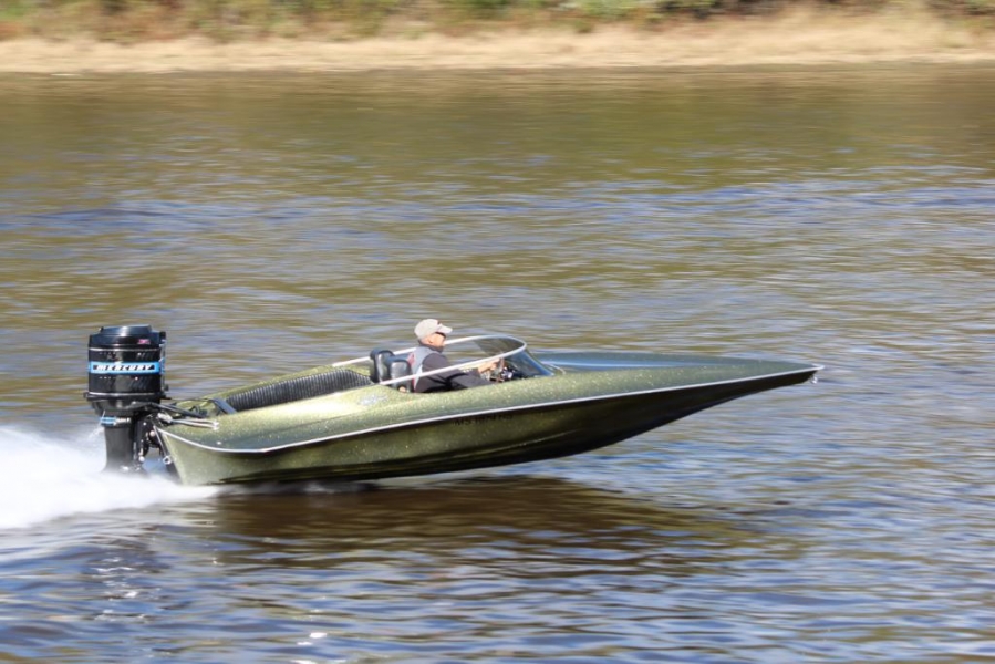

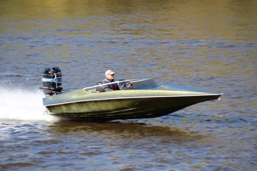

This is a picture of me driving the 74 Vector and the 74 Merc 1500 I restored last year. Pictures were taken at the CT river run last weekend put on by the Scream and Fly.com guys. They had someone on shore clicking off pics as we passed by...boy did they get a couple of perfect shots!
Boat does just over 68 gps on light wind chop. It scores 96 out of 100, deducts were wrong color steering cables (earlier ride guide were black) and the transom metal flake is not an exact match (only if ya look close) to the rest of the boat. I had to reflake the transom when I replaced the wood core. The rest of the gel is factory original with new clear applied. Instruments interior etc. all correct.
It's a balsa core boat and a complete PAIN to redo.
I just thought the 1500 at full tilt would be entertaining to all my Merc bretheren.

Awesome Randy, what prop were you running? RPM?
Re:74 1500 at speed 14 years 1 week ago #71280
  • 63g3
  • Posts: 465
  • Karma: 62
I have tried everything stainless...Choppers, cleavers, non thru hub thru hub etc.
The props that run the best are a 26 Cleaver over the hub exhaust which is good for just a tick over 69 gps and a 24 Laser II through hub exhaust for a few ticks over 68 gps.
The cleaver is near impossible to get on plane and the boat never feels good until 65 plus when trimmed, very limited chine walk so easy to handle while going fast but, regular cruising stinks with this prop. It gives an all speed business look with the boat on the trailer. The Laser II, which is what I am running in the pictures, is very mild mannered, out of the hole and while crusing at different speeds and trim angles, the boat is a pleasure and easy to drive for anyone. I was surprised the top end was as good as it is, minimal chine walk, and it holds the bow up nice. I am not hitting waves in the pictures that is how the prop holds the boat up. I think having the full hub gives a longer bullet to the gearcase and helps stability. It does look plain Jane on the trailer.
The motor spins both props to about 6300, I'm only up there for a minute or so at a time, doesn't sound like a lot of time but you've covered over a mile. I run 21 degrees total timing, I have .082 jets and only use 40:1 sythetic and premium gas. Motor seems to like this a lot, runs solid.
I also tried other 26 cleavers that where a touch slower than my "good one". The regular small ear chopper 26 pitch came in at few ticks over 66 but the boat was hard to handle, a lot more chine walk which I believe is why it ran slower, they sound cool at take off when the motor winds up and looks rad on the trailer though. I also tried a 26 Laser II but the motor would not spin it up past 5500 (?). I also tried a few vintage two blade 26 pitch stainless Merc elepahnt ears, these ran maybe 62 ish and the motor itself sounded way different, more wine was noticable, that is the right prop for correctness at a show only. Goes to show you just have to try a variety of props, some that are the "same" run different while others will give unexpected results and not all pitches of varying prop styles/era's tach out the same. Food for thought where prop selection is a common theme here.
