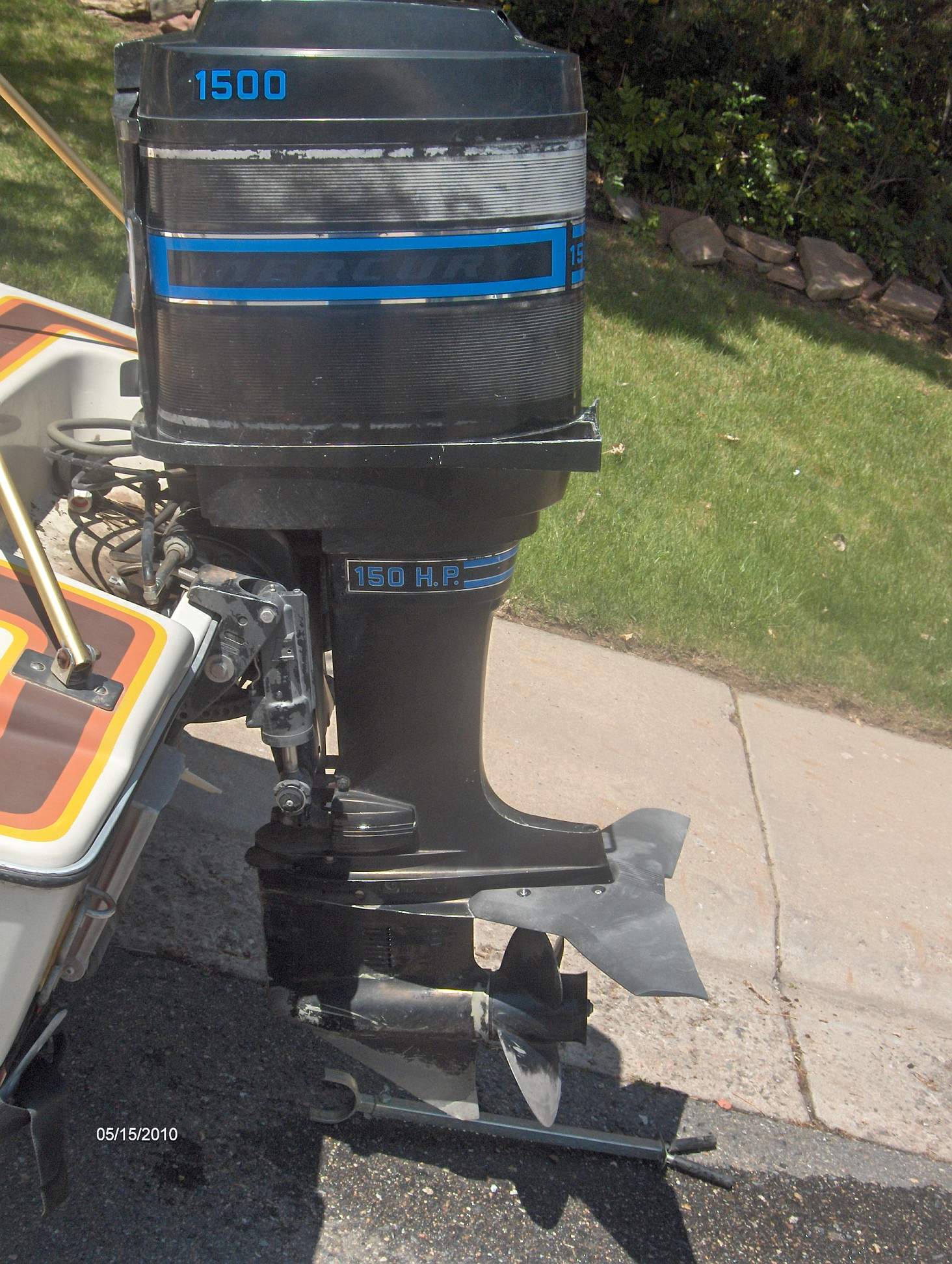

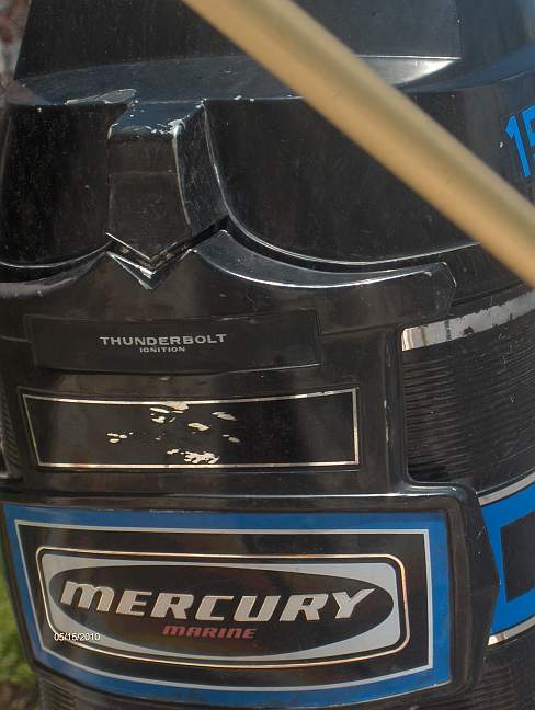

I have seen the Mercury cans of black spraypaint, and I assume they are for touching up the cowls.
Mine as you can see is pretty faded in places and would really look better if I could repaint it.
Advice? Is it really as easy as masking off the decals and spraypainting it carefully (of course away from the motor and boat)?

Side view...

The quality of the job (how well it looks and how long it lasts) on any paint job depends greatly on the preparation before any paint is applied. (Normally applying the paint is not as much work as prepping the project!) Any nicks, chips, peeling paint, etc. should be sanded smooth, and the entire surface sanded for better adhesion. Taping off the decals will probably leave a ridge, raised edge that may detract from the appearance of the finished job.
It's hard to do a "quickie" or "touch up" job and have it look decent when it's done. Plus, it makes it more difficult to do the job right later on, as there is more material to remove to make the whole thing look right. My suggestion would be enjoy your boat this summer, and wait until the off-season to do it right, unrushed. There's a good source for new decals posted here, we can find that for you if you would like. Just my two cents..... ;)

I agree with Mark. Get it serviced properly if you can't do it yourself, use it.... get to know it to be sure what you have is good.
Use good quality Gasoline not joe cheap gas at the corner station I burn 93 octane gasoline and only use Mercury TCW3 2 cycle motor oil 1 pint per 6 US Gallons NO ADDITIVES. NGK Plugs are good BUHW's are pretty standard. Get a can of power tune and follow the directions to the letter on the can.
If you want the motor to look pretty you can buff and wax it for the season. Wash it down real good using good soap and warm water to get the heavy dirt and debris off of it then begin to buff it out and wax it good.
For a good paint job these motors need to be taken down, blasted in a media blaster clean, degreased then you can begin priming and painting. The quickie paint jobs will look OK for a while too but how far you want to go with it is up to you.

I spent an enormous amount of time painting my old '63 Merc1000, and maybe a look-see at this link would help:
www.fiberglassics.com/glassic-forums/main-forum/progress-on-my-14t
Just follow along the thread, you'll see that the first thing I did was clean it real well, then remove labels and sand, clean again, then used etching primer (especially important to coat any bare aluminum before top coat). Only one coat is really necessary, but I did 2 or 3 in most cases for a good base. Then clean again, maybe 3 coats of color, clean again, maybe 2-3 coats of clear.
