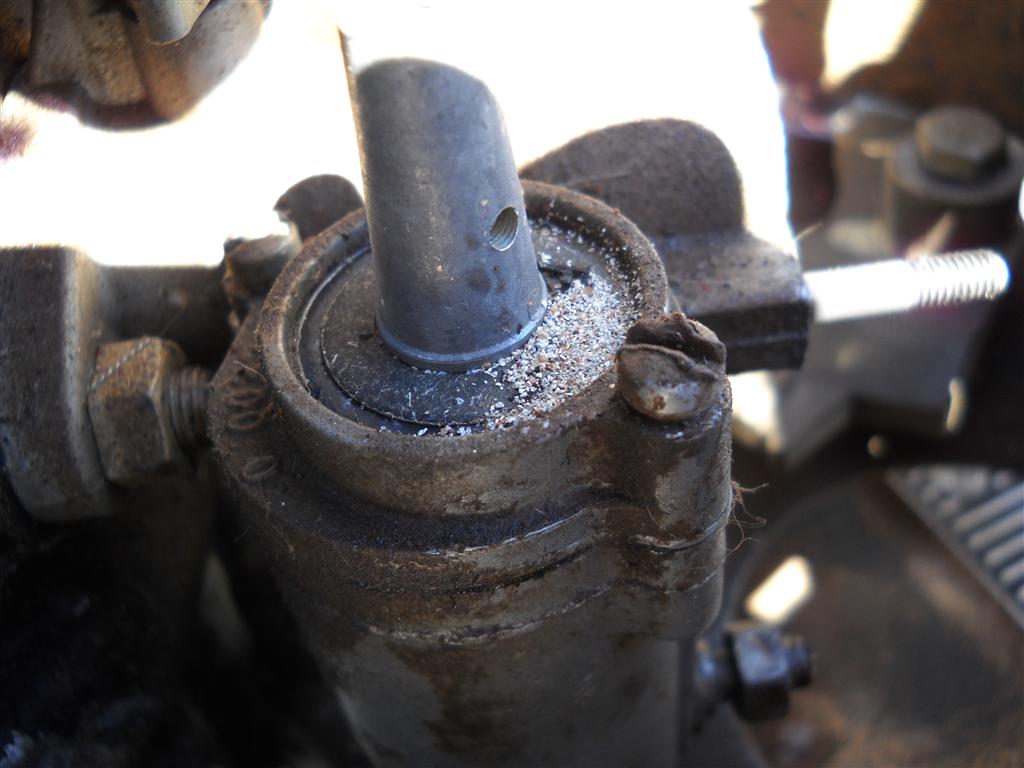

The lower carb, (see photo) didn't have a filter screen at all and the bowl cover was on backwards. I just put the tops back on, they look ok to me... :)
