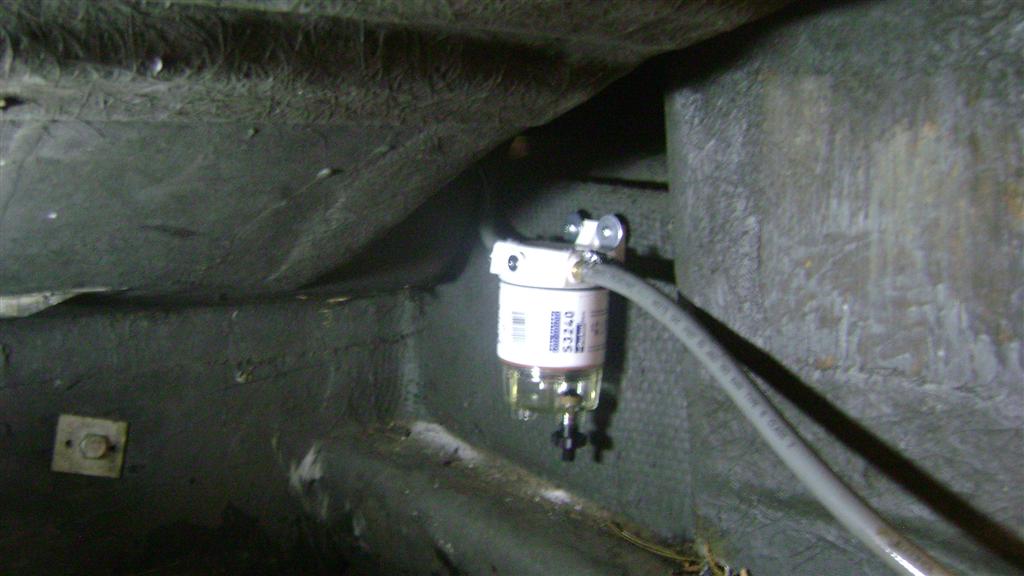

Re:Shakedown cruise with Mercury 1500 Inline 6 150hp 16 years 2 months ago #6982
Recently installed one of these, highly recommended especially with permanent fuel tanks.

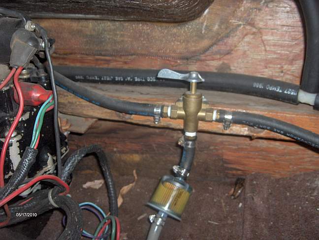

Here is a picture of the Purolator Filter I installed, it has a manual valve that you use to switch tanks.

What brand/model where you using Dave? The Racor unit works great on mine. (120 series made for marine applications.) Got the primer bulb between the tank and the separator, takes about ten pumps on the bulb to fill the filter and bowl from dry. Then thru the splashwell up to the fuel pump on the motor.
(The units without a clear bowl didn't make any sense to me, how can you tell if it fills up with water?)
I've been told it's NOT a good idea to run automotive filters, as they can filter the oil out of the gas!? Don't know if it's accurate, just passing along what I was told.

my filter is a moehler.

I sawed the old plastic filter open. Yugh. The inside was so varnished and yellow, and the filter was filthy. Its a good guess how long it had been since the last swap out. I'll keep a spare handy, I'm hoping my siphoning, fresh fuel, and filter swap will solve the fuel flow problem.
With all due respect to everyone trying to help here and you as well, Amigoid, until the carbs and fuel pumps are cleaned out and refreshed with new gaskets, diaphragms, filters, (rebuild kits), I don't believe this problem can be "adjusted" away or flushed out with fresh gas. If the old fuel filter was in that bad of a condition, the rest of the fuel system needs a thorough teardown inspection at the very least. I'd be willing to bet that the carbs and fuel pump were left with the same varnished gas in them, and I don't see any mention of that being addressed yet. I don't know the mechanic(s) you're (at Valentine's?) using, but it sure sounds to me like he (they) are not covering the basics here.
We ALL want you to be able to go out and enjoy your boat as soon and as safe as possible, while spending as little $ as you can to do so. I sincerely hope I haven't offended anyone, I just don't want to see Amigoid score a piston or cylinder ruining this motor by trying to run it on less than sufficient amounts of gas/oil. Try the idle mix adjustments as described by the knowledgeable mechanics above, but if that doesn't fix it, please consider listening to the "old guys at the lake" and finding another mechanic. I'll shut up now.

I agree completely. I have sent it back to Valentines, with instructions to replace the impeller, recheck the carbs and also check the condition of the fuel pump including the check vales and diaphram and replace if needed.
While I did not flatly state that it is their last chance to do it right, I did imply it.
One of the first things i did when i brought the boat home was siphon out the old gas from both tanks. I had the boat tilted to make sure I got it all, and the gas looked and smelled clean and in hindsight like the new gas I added. If there was any old gas, its long since gone. I poured a lot of the old gas in my Volvo, its been running fine.
The seller told me he winterized the engine and I think he mentioned putting stabilizer in the gas, but I took no chances.
As for the rest, we are past the point of trying to do this without getting into expensive engine work. I have told them I want the engine working, and they need to do whats nessasary to get to that.
I'm taking the group's advice and will get a water pressure gauge, and get the tach working.

Great news, the mechanic is sure found the problem!
It was a combination of problems. The lowest carb was leaking, and the fuel pump had a tear in the diaphram. He rebuilt it and fixed a broken check valve in the squeeze bulb. Due to the large number of last minute boaters he can't do a check run with me until next week but in the meantime I'm going to pick up the boat and try once again this weekend. If this fails, it goes back for a full overhaul and a check ride.

it is amazing how bad a 4.95 cent diaphragm kit will ruin your day.

The motor started briskly. It idled well, and except for a couple of early stalls when we opened up the throttle, it finally accellerated like we expected it to.
Unsure if the speedo can be trusted, but it said we were doing 35.
There is still some problems at WOT but I will take the mechanic out next week to fine tune it. We are taking it out this weekend for more runs tomorrow evening and maybe kneeboarding on Saturday.
The diapham had 3-4 cracks in places. I can post a pic if you are interested.
