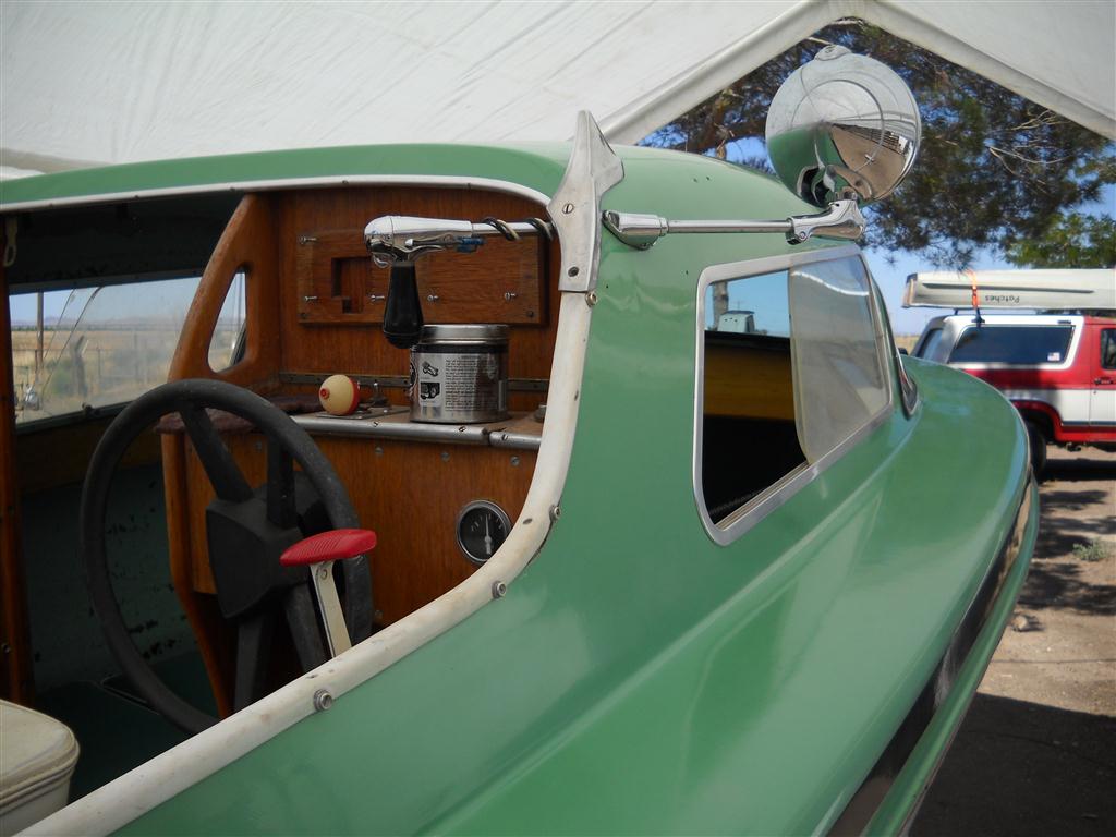

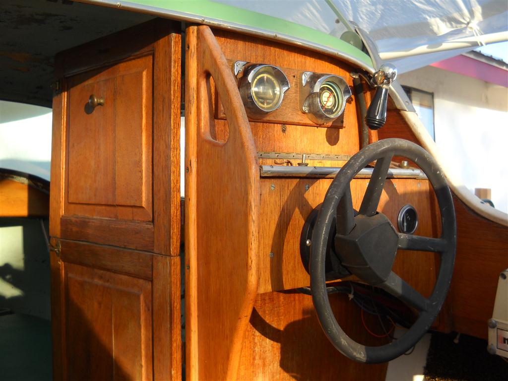

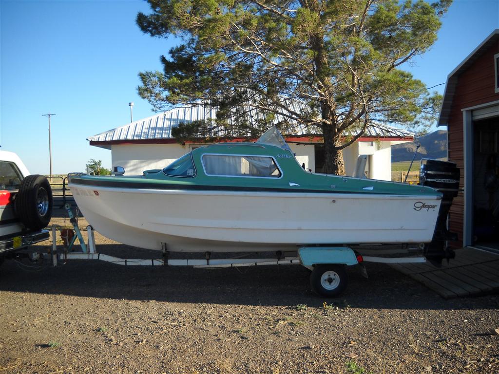

Hi Dean, yes it's a Delmar, remarkably complete and in nice shape for a 59. Hasn't been on the water since some time in the 1990s. I bought it as a long term project. I've owned quite a few boats in my lifetime and currently have a 12 foot Sea Nymph for the smaller lakes in my area. I'm really on the fence about the Mercury powerplant. It seems to run OK, but the obsolete parts are a problem. Also my location puts a limit on available used motors and shops that can work on older stuff. Maybe I'll feel better after that test run.
One of the other forum folks sent me an email with lots of good info on trying to match up a modern flo-torq prop to my setup. There are a lot of variables in prop size and pitch, so I'm not sure how I would tackle that. Trial and error could get expensive, but it sure would be nice to have that setup on my motor.
Here are a couple pics of the Delmar. Nice little cruiser.

Nice looking Delmar Norm.
