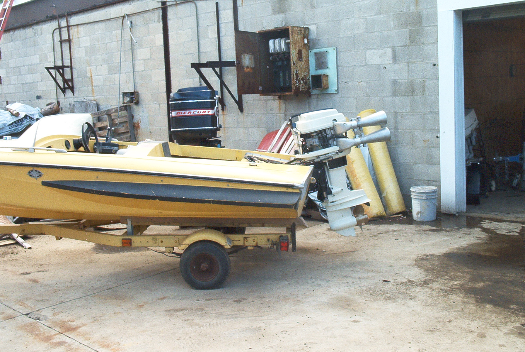

Re:Why do Mercury's have a louder exhaust than omc's 14 years 2 weeks ago #71264
  • Robby321
  • Robby321's Avatar
  • Posts: 902
  • Karma: 42
  • Thank you received: 10
Here ya go..
