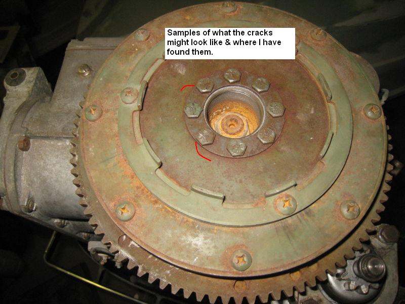

could be a bad cap or fuel issue. ping could be a cracked flex plate.just reaching check basics first.

Hello Dave, and thanks for the response. I'm in the process of stripping things apart and I'll go over all the basics plus some. I have new carb rebuild kits for the 650, but I still have to get some floats. I've never set the float height on something like this, but the instructions go over it, so i should be ok. You mentioned a possible cracked flex plate creating the pinging noise. Would you be talking about the reed plates? Sorry, but I've not heard of that name before. (still a greenhorn...)

Re:New (old) previous member from old forum... 16 years 5 months ago #6983
The flexplate is part of the flywheel assy. There is a centre hub which bolts to the crank & an outer ring with the starter ring gear & magnets on it. The plate that connects the two is the flex plate.
Re:New (old) previous member from old forum... 16 years 5 months ago #7004
I have attached a picture of where to find cracks in the flex plate.
Thom
Re:New (old) previous member from old forum... 16 years 5 months ago #7012
to check the flex plate tap it with a wrench it should be a nice ring to it not dead sound.sometimes you cant see the cracks.
