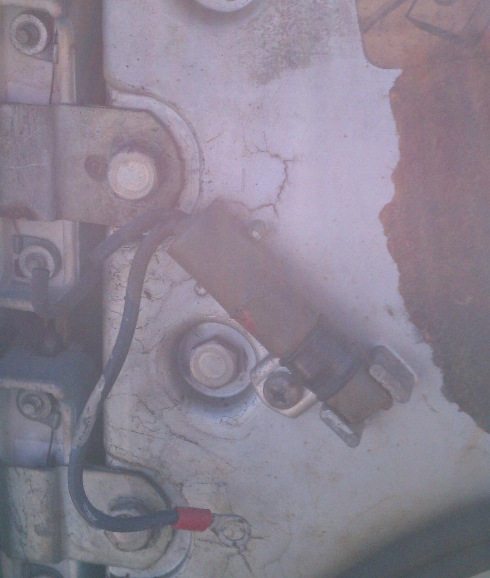

this is on the side of my mark 78. It has been disconnected.
Re: What is this? 14 years 2 months ago #68757
mercury switch. shuts the motor down when tilted. they were a problem especialy that one the replacements were better. not needed to run.
