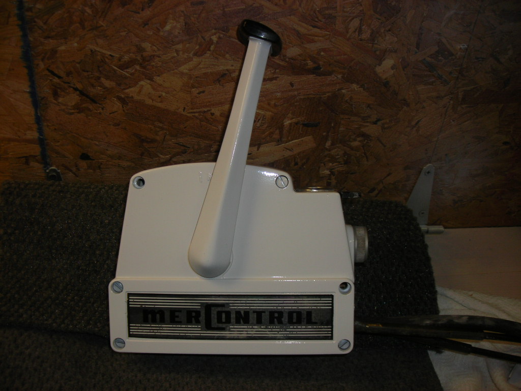

i replaced the shifter on my 62-700 with a later date mercontrol. it shifts into forward and reverse fairly easy, but is a bear to move when i want to throttle up or down. any idea what could be wrong. ron

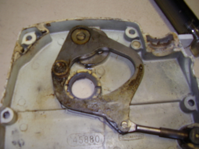

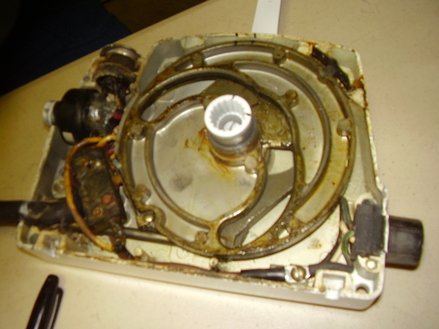

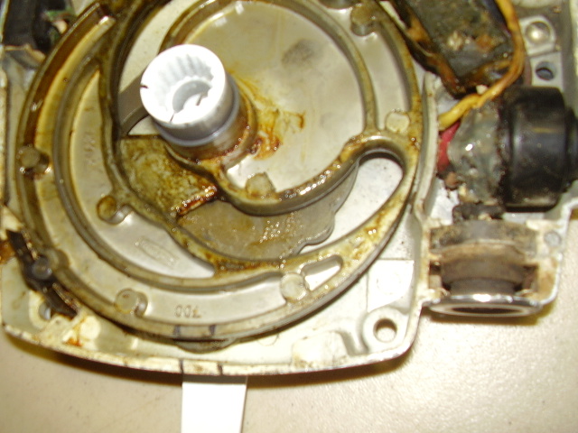

ron ,we totaly took apart the same kind of control on the sunray,it could be many things but for us it was just old cables,after we put the new cables on it worked perfectly.
but be careful taking it apart,there is alot going on in there,lol,we took pics and marked the position of all the moving parts with a sharpie so it would go back together exactly like it was.

Hi Ron,
I had similar issues with my old mercontrol box. I was very hesitant to open it up after seeing pictures of what it looked like on the inside. YIKES – scary in there. The previous posts here are great. Certainly good advice to check out before opening it up. I did open mine up and paid close attention to it each step. I will be happy to talk to you about it as I talk way faster then I can type. I did find a slightly worn bushing that I replaced that and greased it up inside. All that helped, but only a little. I replaced my cables and that was it – smooth easy movements after that. Call me if you want 540 798-3819
