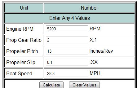

Re:Thanks for help - still have low RPMs 13 years 7 months ago #68085
There are a number of prop calculators on the net, I posted a snip of one using your numbers.
The charts that Merc printed were very optimistic. Sounds to me that your tach is OK, pick the prop that moved you 30 plus mph.
