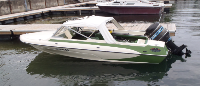

so i sold my 1960 14foot cutter calypso :( that had a lower unite with severe water intrusion damages and upped my game with a 1973 Glastron V173 Bayflite. SWEEEEEEET boat :woohoo: with a 115HP mercury tower of power that runs like a dream. the serial number on the transom clamp(mount) is #7018822, anyone know what year it is? just wanna know its weight, redline RPMs some tunning specs etc. thanx in advance guys.
Re:new (to me) boat with a merc, what year??? 14 years 2 months ago #67263
That serial number isn't coming up on any of the engine parts search sites. The blue bands were from the early seventies I believe, but we've seen folks change them before to make 'em look period correct. Hopefully one of the "real" Merc gurus can help..... :unsure:
GOOD looking Glastron BTW!

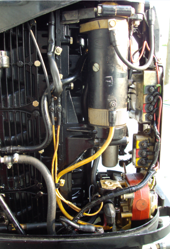

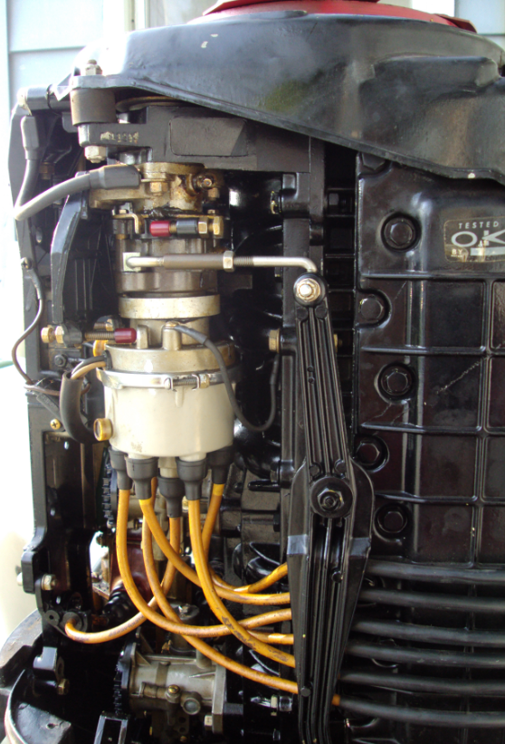

heres the pretty beast without covers on
Re:new (to me) boat with a merc, what year??? 14 years 2 months ago #67514
You didnt attach a photo delirius. Please try again.

Re:new (to me) boat with a merc, what year??? 14 years 2 months ago #67535
  • delirious
  • delirious's Avatar Topic Author
  • Posts: 49
  • Karma: 1
round two??? lol

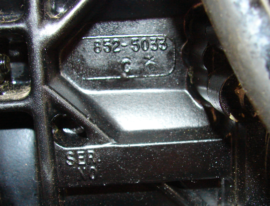

If you would please look for the serial number on the block. It should be just to the left of your fuel pump. Lots of times its on a small non painted part of the motor. Let me know what that number is.
Also please tell me if your transom clamps have thumb screws, bolt head thrumb screws or NO thumb screws(direct bolt on)

it has bolts on the bottom of the mount and and thumb screws at the top...this is what i found on the block
Re:new (to me) boat with a merc, what year??? 14 years 2 months ago #67585
Well shoot. It looks like your block does not have the serial numbers stamped by the Ser No area.
Well Id say your motor is all from 1973. I dont know why your serial number starts with a 7? Possibly a Canada model?
If your mid was from the mid 80's it would not have thumb screws.
Your block does have a interesting stamp. That C. That C I thought was only on 1500's, but I guess I am wrong.

I wonder if a service dealer/shop replaced the block on the motor with a factory replacement somewhere along the line, hence the lack of serial number?

If you ever have time to pull an intake cover off the side of the motor, look and see if it has power port pistons.
I have a sneaky suspision that you have a 1500 powerhead replacement on your 1150.
Conrad
Re:new (to me) boat with a merc, what year??? 14 years 2 months ago #67666
That would explain the "C", and the 21P prop. (19P is as big as I can swing with 115HP). Might have to adjust your speed guestimate up a tad, Delirius!
