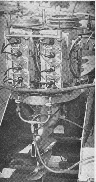

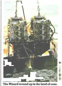

Ya can side by side them too..(Merc twin V6 blocks, single L/U..the "Wizard")..but that thought a REAL TALL STACK 8C?
I WANT ONE!Damn, do the exhaust right, and a sound, well be ..a.."WTF is THAT!"

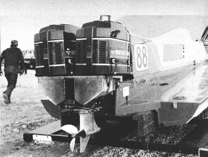

Here ya go.."Mark55's on a single D Quicky tower" .
Re:8 Cyl. Merc. 13 years 7 months ago #67302
The only way to do it without lots and lots of mods is the second pic Robby posted. Mount them beside each other and gear drive them to your drive shaft.
Problem with stacking them is many. Cooling water and exhaust dump wild out the bottom of these motors. How would you controll that ? Would also be hard to build a coupler to the top of the drive shaft. You could attach to the flywheel, but it would surely spin a key almost instantly.
If you want to cut the blocks and weld them togther that would be awesome. timing two mags together should be possible if they were fixed to each other somehow.
The first stack 6 was made by welding smaller motors together at the mercury factory.
Conrad
