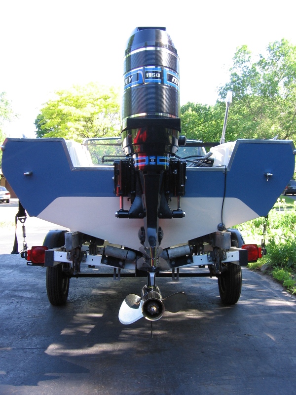

My birthday, (no.74), is soon--send me a Laser II 20" or 21" for my Merc 1000 so I can go fast!!!! (Ha!ha!) Bill bought prop shown here as it did not work well on the Merc 1000.
Jim Savage

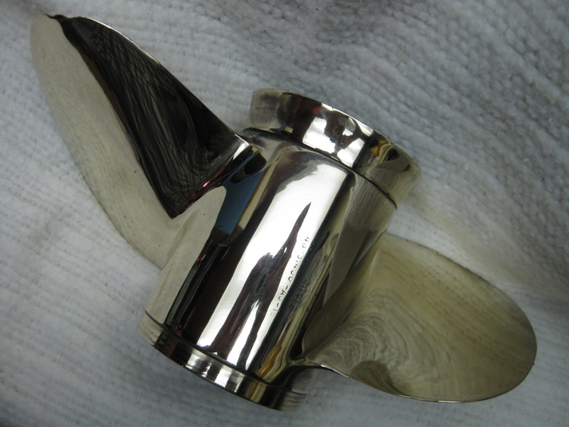

I am a believer in 2 blade bronze props under certain conditions. First, the bronze props are not raked and do not provide bow lift. Second, they need cupping to bite out of the hole and while turning sharply.
My Glastron V-153 with a 115 HP Mercury ran 53.5 MPH GPS with a 2 blade 21" pitch bronze Quicksilver prop, quicker than other stainless steel props by far. The blades are razor sharp. But get the right part number when getting the 21" pitch, as Mercury had older designs that were not efficient. Get 48-49630-21.
