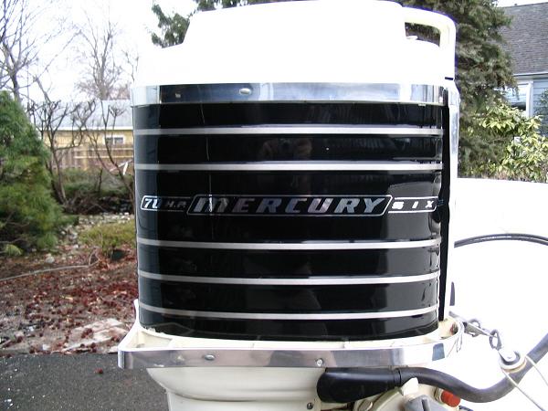

Re:1961 700 wrap 16 years 5 months ago #6658
62 700
Re:1961 700 wrap 16 years 5 months ago #6668
IMHO All those pics look like my 62 700. My 61 700 looks like the one on this site ....Tom
store.eastcoastmarineservice.com/category_s/811.htm

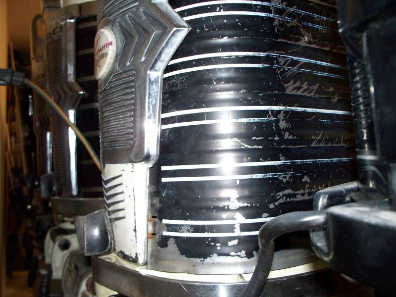

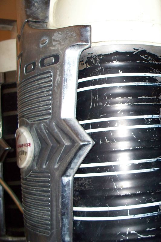

Re:1961 700 wrap 16 years 5 months ago #6761
I have a 61 Merc 700 on the rack , I will try and get some pics tommorow for you as Im headed out shortly here but as I recall they are painted stripes ....

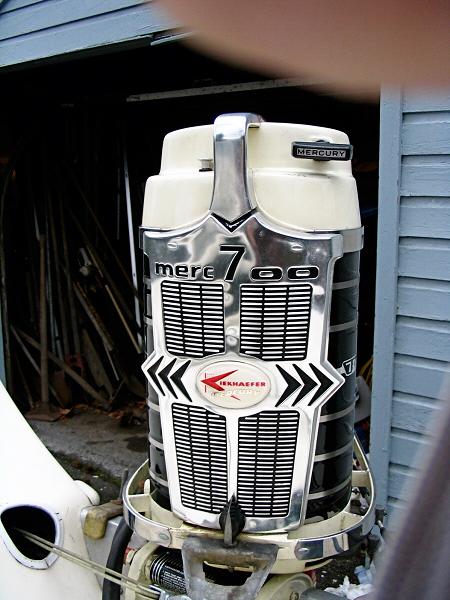

I wonder if this 700FGS is a 1961 model??
I forgot about it until I saw some of the other posts that showed this style face plate.
I can't get to the serial number plate without lifting the beast up and away from the wall, but if some one recognizes this one as a '61 let Darrell know please.
Thom
Re:1961 700 wrap 16 years 5 months ago #6781
Thoms pics of his wrap are the same as mine , except his are better then mine , mine are pretty faded !
Re:1961 700 wrap 16 years 5 months ago #6793
Thom, that is a 61 allright. Also the last year for the pot metal face I think....Tom
