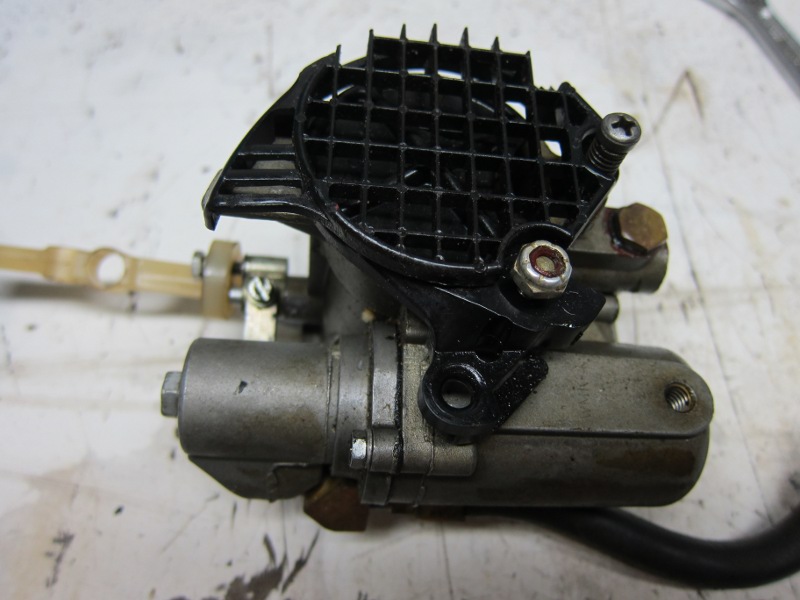

I am about to try rebuilding my own carbs. Never done this before, so wonder if there are any tips you folks might have. These are Tillotson carbs and look fairly simple. Between instructions and diagrams in the merc shop manual and included with my Sierra Marine kits, looks pretty straightforward. If I didn't have both, I would have questions.
Kit instructions say to disassemble carb only enough to permit a thorough cleaning - what does that mean?
Here's one of the victims...
Thanks for any help, thoughts or ideas.
Frank
