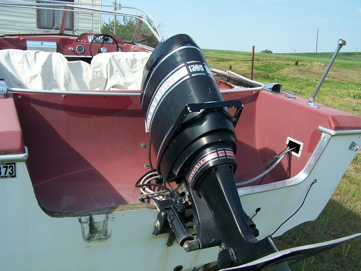

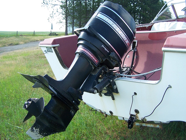

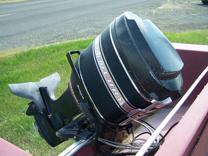

Here is the old girl! :ohmy:
I will post some more shots when I get her home and wiped down and hangin' with her brothers!
Oh yeah, I took one of the four wheelers home and changed oil/ filter,put in a new battery, removed and cleaned the carb, new plug, fuel lines and gave her a few shots of grease. Changed fluids in the front and rear diffs., and she runs like a champ. One down, one to go!!!!!!!!!!!!!!!!!!

Littlefin, you don't want it. It ain't white.
Neil, what is the boat and is that a good top on it.Skip.

It is a Fiberform. I never even looked at what shape the to is in.

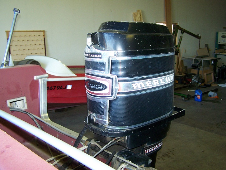

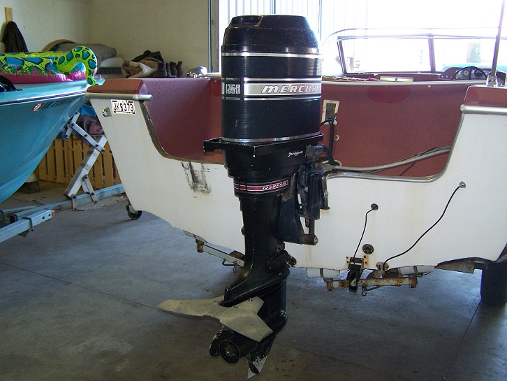

I got her home yesterday and did a comp. test. 0 on No.1. 130 on 2. 128 on three. Did not go any further. Looks like a base hit instead of a home run. T/T works great. So looks like I got a parts motor and T/T for the cost of a couple tuneups. Works for me! :)

Heck, Neil the tilt & trim are worth what you have into it.
