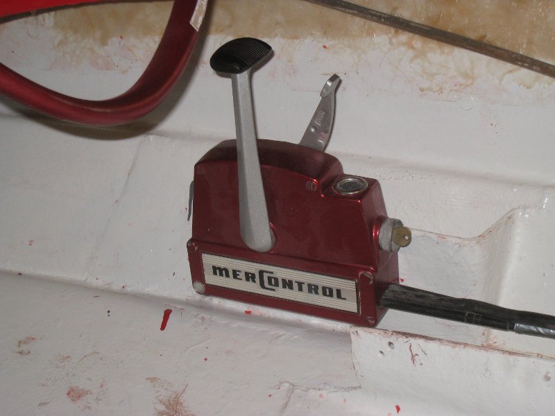

Replacing control cables 16 years 5 months ago #6532
Please see the pic below of my control box. I believe it is a '71 full gear shift box. Can anyone tell me where the shift/throttle lever needs to be when hooking up the motor? It sounds from the manual like I need the control lever straight up and the idle lever down all the way?
The directions say to move the throttle lever on the engine forward to throttle stop (idle position) and hold there while adjusting the barrel so that the distributor is held lightly against the idle screw. Can someone maybe interpret this for my with a couple pics? I sure would appreciate it!
Thanks,
Frank
Re:Cable replacement? 16 years 5 months ago #6533
Frank, I believe you need the throttle lever in neutral, looks like that's where it is in the pic. Move the fast idle lever down, (off). Back at the motor you want the throttle linkage with the carb shutters closed, the gear shift lever in neutral, and the distributor resting against the idle stop. THEN move the Main Throttle control lever full forward to check for fully open butterflies, and forward gear engagement. The distributor should also turn against the full throttle stop. Return to neutral and make sure she shifts back on the gear lever.
When adjusting the gear shift cable, they caution against shifting into reverse without the engine running, can damage the linkage or something. I've found you can, just be carefull. May need to turn the motor or prop by hand to line up the gears when doing so.

Re:Cable replacement? 16 years 5 months ago #6550
I went through this just recently. It caused me fits with a single lever box on my '61 Merc 500. Saw this and thought that it might help.This is from "John's Mercury" site.I've just been through this......use the pre 72 (if I remember correctly) OMC cables with no ends.
Take off the plastic threaded OMC anchor nut and tread on the merc barrel (you may have to drill and retap the merc barrel - but it works).
If you are adapting to the two lever merc box.....they will work fine with enough throw.
If you are adapting to the oval style single lever Merc box - I found that the nylon rack will will travel off the end of the OMC brass tube and jam when it tries to travel back over the end. I solved this by adding 2" to the tube (cut brass end off the old cable and solder togather with a 1/4" brass sleeve and taper the ends of the sleeve so the nylon rack moves freely over the conector sleeve).
Hope this helps.
Re:Cable replacement? 16 years 5 months ago #6554
MarkS is correct Frank, engine in N warm up throttle lever down, main handle upright like your picture. This was the standard controller from the mid 60's through the 70's. Make sure when you adjust the throttle cable the linkage is just touching the stop, you may need to re adjust this after you have adjusted your idle speed on the motor. Again MarkS is correct re. moving the controller lever to astern YOU MUST TURN THE PROPSHAFT (or the flywheel) or you can damage stuff.
Re. fitting the cables in the controller, they are very easy to do but as another contributer mentioned, watch the detent roller, it can jump out. Look out for wear on the gear selecting 'quadrant' where the small tooth on the centre 'wheel' engages. Source a replacement(s) if either the tooth or the slot in the quadrant is worn. Lubricate this area well & lubricate the detent roller. Hopefully no one from the bugger-up team has been in before you so it will be correctly assembled when you open it up. They really are very simple, with only three main parts. I have never had a problem with them and found them simple to sort out, but I do know people that find them difficult.

Re:Cable replacement? 16 years 5 months ago #6868
Apparently the way I hooked it up with my old cables was the way it needs to get hooked up guys. It just didn't seem right to me, but I looked at all your comments, and ended up hooking the throttle cable in the same position I had it before. Motor started right up, though it took me a bit to figure I was revving it up in gear. I moved the throttle to neutral, revved it a bit with the idle control, then moved it into forward, back to neutral, and into reverse. No problems, everything seems to work the way it is intended to. My new pee tube I put in the top of the powerhead to feed out just below the cowl also worked. If I can figure out how to get the video I did out of my camera and into youtube, I'll add a video later.
