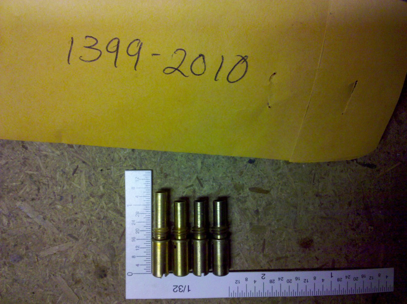

So I went to the parts store. I checked out three different nozzles. P/N 2179 seems to be the first one they gave me, it was an exact match, these were used on some of the Merc 850s. P/N 2535 is found on all the other KC series carbs (Merc 900, later 1000, and 1100), and is much larger in both diameter and length, with more threads too. And just to be sure, I had them pull a P/N 1739, used in the earlier Merc 800 and 850s, this one was more the size of the 2179.
My guess is that they have mixed up the 2179 into the 2010 bins, since he checked the 2010 and they mach the 2179s.
I'm including a picture of my nozzle (on the left) with 2179s, if you have some KC1A nozzles, give them a measure. The scale is hard to read but the long nozzles are 1 3/16 inch. The shorter are 1 1/16.
Maybe I'm the one with the odd ball parts?
