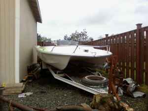

Danny,
Here's a 15C waiting for new love!
Maybe you can share this with the PC guys.
portland.craigslist.org/nco/boa/1736122837.html
I have attached an E-D-B-D picture, but there are better pixs in the CL ad.
Thom

Thanks, Dr.
I had been tracking that one for awhile on Craigslist..
Problem is we do not have many in our owners group in the
Oregon area. There are several folks that would love to
buy this boat, but its too costly to transport.
Danny Leger
