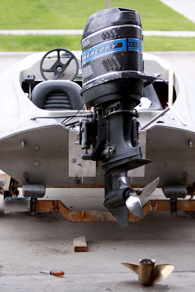

For kicks I put my 1500J wrap on my 1250 today while installing dual cable steering. Make some more runs in the morning. Steering is awesome!!!
Stability mods so far. Jack Plate, Dual Cable Steer, New Swivel Pin, Cleaver Prop, Solid Motor Mounts. All will come to gether to make me safe and happy I hope.
Ill report my luck if it dont rain tomorrow.
Conrad

Well its video, not good video but video of it today. Not quite 62mph with more left. Each time in the video its just coming up to 60ish then I back out. It has some left in it. Just to the right of where I was videoing the wind was wrapping around and causing decent sized waves so I couldnt do a full WOT pass.
Conrad

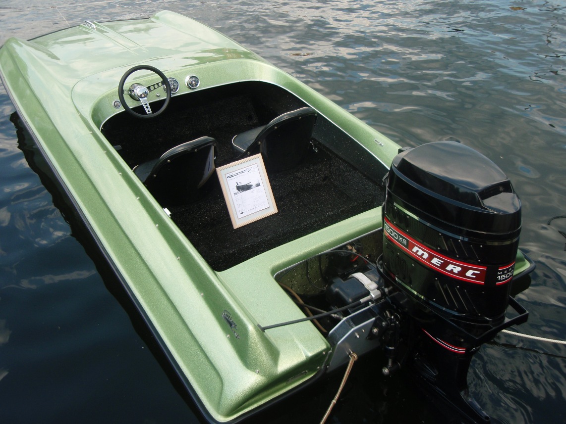

Here is the Switzer equivalent to the Contender. This is a 69 Shooting Star with a 76 XS and a SSM lower. Motor is high on a built up factory transom with factory tie bars. Does about 82 to 84 depending on wind ripple/direction. like yours this DOES NOT TURN either!!!
I love your video, nice hole shot! It takes quite a while for me to plane, the prop used is about 8 inches in dia, 17 pitch 1:1 ratio lower, you crank it to 5000 and let it sit there and then it will finally plane off. Bounces like hell till 50 or so and starts to fly the bow at about 65 then picks up speed quick till just over the 80 mph mark. Funny I was going to put on 1250 cowls on the XS for the correct year look you went the other way, XS cowls on a 1250!
Keep the old "fast glass" alive and screamin'
Randy

Randy did they rate the Shooting star for 125-150 hp? My contender is only rated for 85. Not sure I want to go much faster than high 60's with this thing. I have a 1500 J block 1975(the cowls you see on the 1250) but man this thing at 70ish would be haul'n I cannot imagine 80 mph in a boat like this.
Conrad
Ill get more video when I get it out next time.
