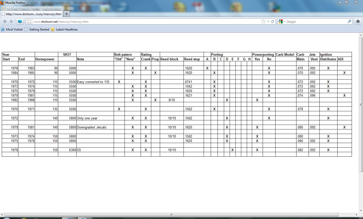

Re: HP increase for the inline 115 Merc 14 years 6 months ago #60858
Conrad, here is a chart that shows some of the differences. You are correct they changed in 82 to prop rated.
Re: HP increase for the inline 115 Merc 14 years 6 months ago #60862
Dave cool chart. What do your A,B,C etc porting specs mean? Or is it irrelevant your just showing the ones with the same?
Conrad

Re: HP increase for the inline 115 Merc 14 years 6 months ago #60937
They are irrelevant, just convenient grouping for port maps that have the same dimensions. Arne Kjetel put this together when he was researching port maps. I just knew where to find it.
