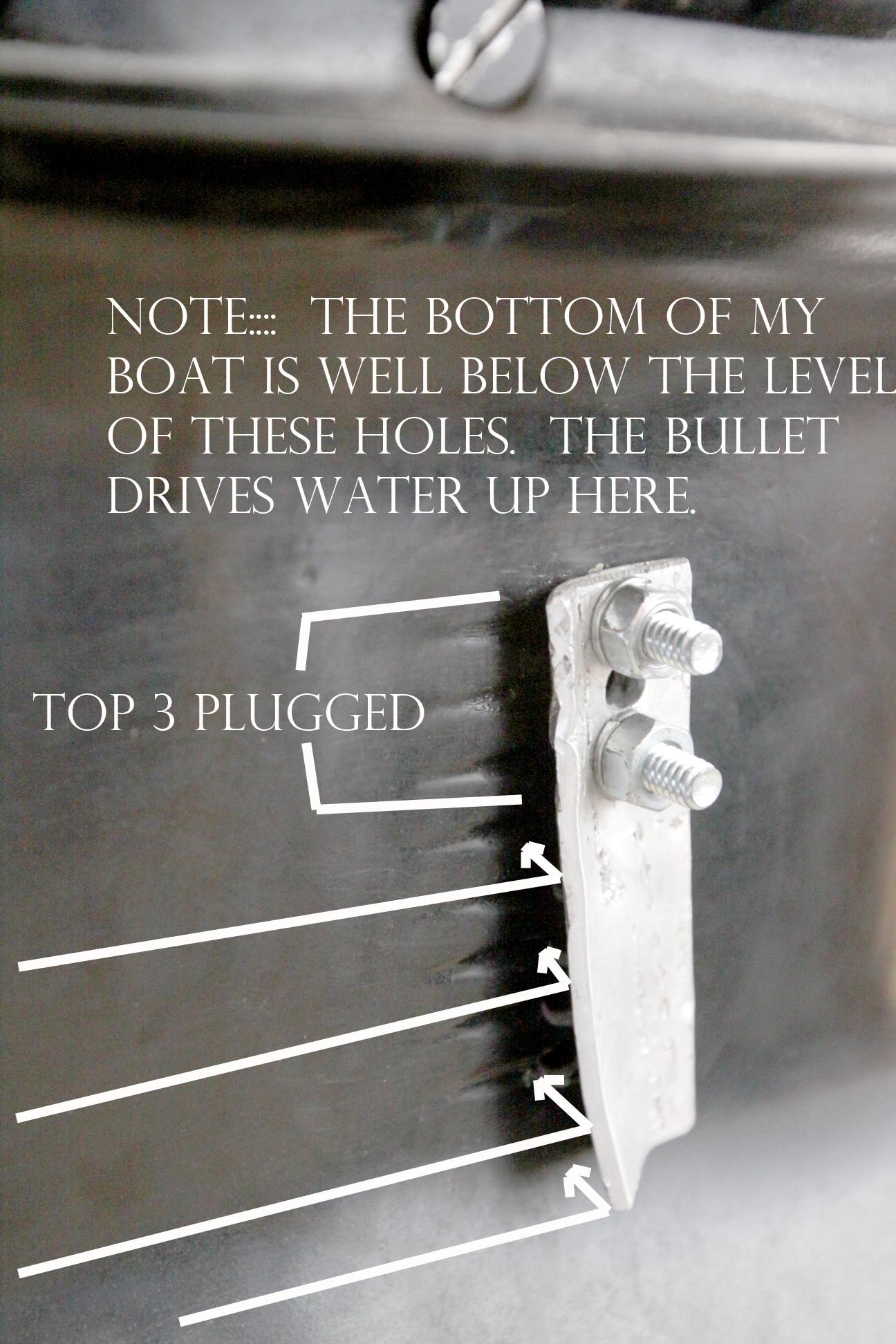

Re:Low water pickup? 14 years 6 months ago #60527
This is my basic set up. 1/4 inch thru bolts hold it togeteher and block the top 3 holes.

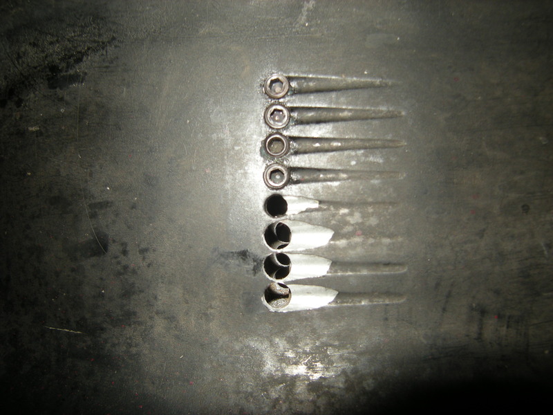

Re:Low water pickup? 14 years 6 months ago #60537
Frank,
Yes what your buddy has done will work and get you up a couple of inches at least. I did the same thing before adding scoops. I actuall only used RTV BLUE silicone sealer to block off the top 3 or 4 holes. Squeeze it in there and smooth it off, once dry it holds really well.
After I got past the 3-4 inches up mark just blocking off the top holes did not work 100 percent of the time. It also depends on how the water comes off the back of your boat. Some boats get by without scoops and others need it.
I would get good pressure for a little bit without scoops and then without warning it would fall down nearly flat.
The scoops put VERY good pressure out when running. I get close to 20 lbs of pressure running 75 mph. Lots of that is ram pressure feed.
Let me look for a close up photo. But for now blocking off the top 3-4 holes will help if you go up a few inches. enlarging the remaining ones a tiny bit does not hurt. But you dont need to go crazy. What your buddy did is fine but max hole size before they run into each other.
Let me look for more pics.
Once you get your 1350 on your boat and a good prop you might be surprised what it will do. Once you get the boat free from the water it will walk right up to some serious speeds.
Conrad
Re:Low water pickup? 14 years 6 months ago #60538
This is a bit closer.

Re:Low water pickup? 14 years 6 months ago #60561
How thick is that aluminum Conrad? I want to make some of those babies.

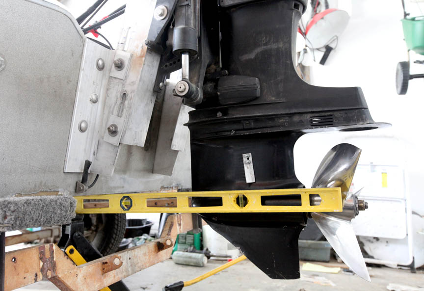

Frank, a few things to consider.... Conrad's gearcase is newer, slimmer, more hydrodynamic. Water coming off the bullet will flow differently. Scoops may or may not help. I agree with plugging the top 3 holes, but suggest testing that before scooping. And if you don't have one yet, a water pressure gauge is a MUST when jacking a motor. Finally, start saving for a chopper prop- you'll need one... or a few.... and a foot throttle...
Re:Low water pickup? 14 years 6 months ago #60619
Boy Kerry, if I can't figure out why I'm having centering and fitment problems, I'll leave the jack plate off and just mount the motor. I need my boat for the water!
The water pressure gauge isn't a big deal, but a new prop is a big deal right now. I'm holding off on a foot pedal for now. I'm just glad I installed hydraulic steering last summer - that was pricey. Plus I dropped about a grand into the trailer this year, but that's done. Next year she gets new fenders, and that's about all I can do for the trailer.
Pics soon.
Frank
Re:Low water pickup? 14 years 6 months ago #60781

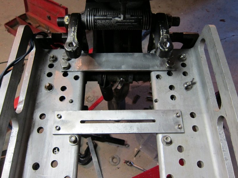

Re:Low water pickup? 14 years 6 months ago #60782
No problem Kerry. Over the last 4 days I have lost so much time screwing around with these special clamps I bought for 50 bucks. I ditched them this morning and am going to use my original clamps. Everything seems to work again, so maybe tonight I can progress a bit farther.
Once I get this baby on my boat, I'll worry about plugging holes in the LU and running a water pressure gauge. I'll get one in the next few days. I am not gonna get a foot pedal, as this is never gonna be a drag boat. New prop is a distinct possibility, but I need to get everything back together and see what happens in terms of rpm first. Once I get the boat ready for the water, then I can start working again on the 1350!
Thanks for the help, I'll keep ya posted.
Frank
Re:Low water pickup? 14 years 6 months ago #60785
Not sure what your plan is. But the thumb screws I believe are still needed on that design to support the load. The extra trim bracket bolts add stability to the trim brackets.
Others can chime in if I am wrong.
