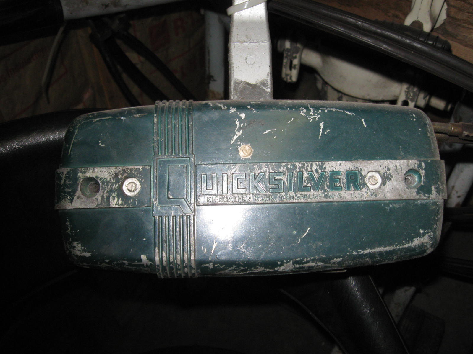

** This engine comes with a "Quicksilver" dual handle control box.
It works but is it "technically" correct for this 59 motor with a 59 Playmaster boat? Or should I look for a Mk 58 only controller?
Re:1959 Mercury MK58A 45 Add a starter /controller ? 14 years 6 months ago #60442
Yes the controll is correct for the motor, better in crinkle finish black would be better.
to convert you need a starter flywheel wiring harness internal, and external,choke and starter solonoid and choke plunger and J bracket for the external harness.all bolt on except you will have to drill a hole for the wiring harness in the cowl.
switches can be mounted in the dash.
