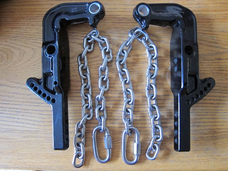

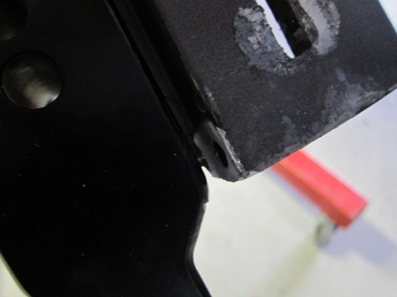

These clamps are very cool. They are special merc clamps that were made to mount mercs to jack plates and such, or at least I think that's the deal. They will also make both my power trim & tilt and new hydraulic steering work just fine with the power lift I'm putting on (hopefully) this weekend.
Also in the pic are some new stainless break-away chains I got in the mail today. I need to drill a couple 1/2" holes to mount them to the brake actuator. They're gonna look sharp compared to the rusty ones I used to have!

Re:Cool clamps 14 years 6 months ago #59932
Great score Frank!
Re:Cool clamps 14 years 6 months ago #59936
Thanks Bob. And thanks to Tim Calmes, who had those clamps and sold them to me!

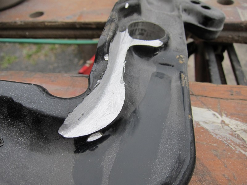

Clamp problems 14 years 6 months ago #60193

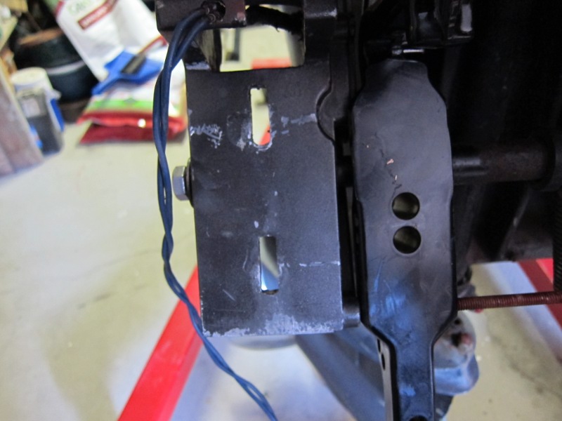

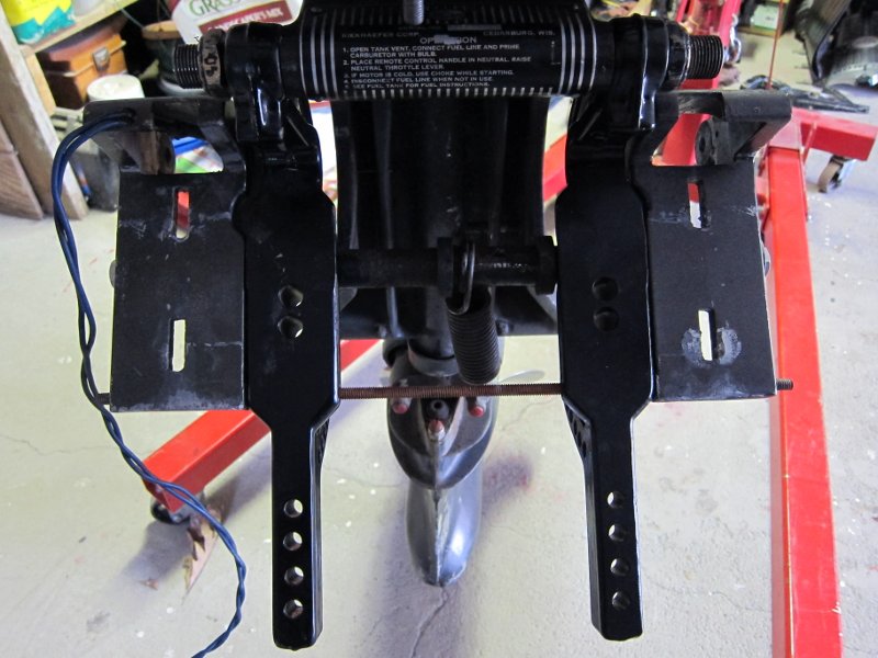

Can't get the starboard trim bracket on.
Port bracket, no problem.

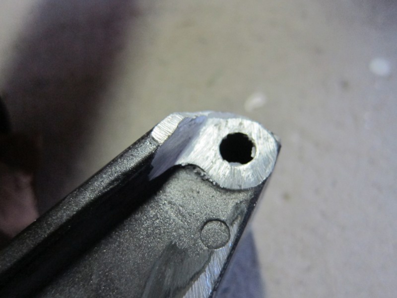

Also, because new clamps are thicker around center hole (was 7/8", I drilled out to 1" to fit the center shaft), can't use the old thick washer/bushings things.
Any ideas would be real helpful and greatly appreciated!
Frank
Fixed! 14 years 6 months ago #60255
No ideas forthcoming, so I got out my 4 1/2" angle grinder and now everything fits...

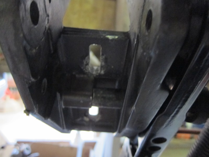

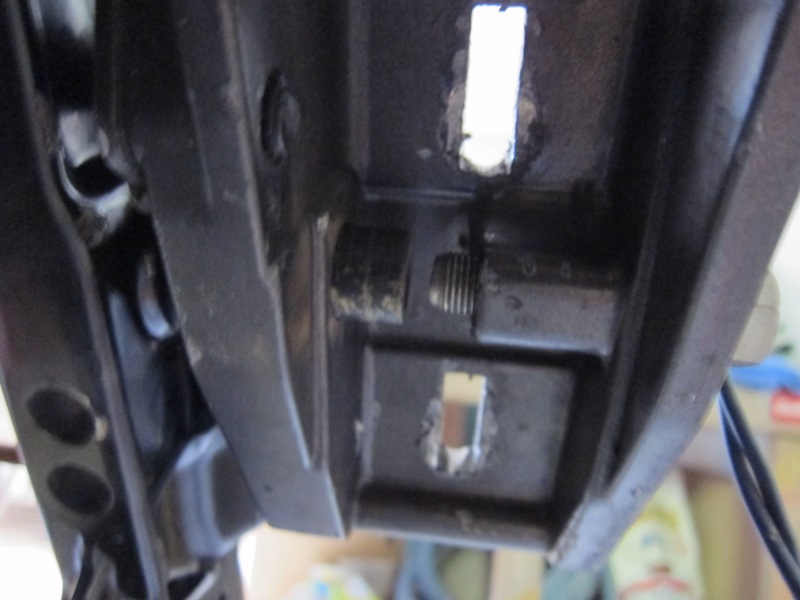

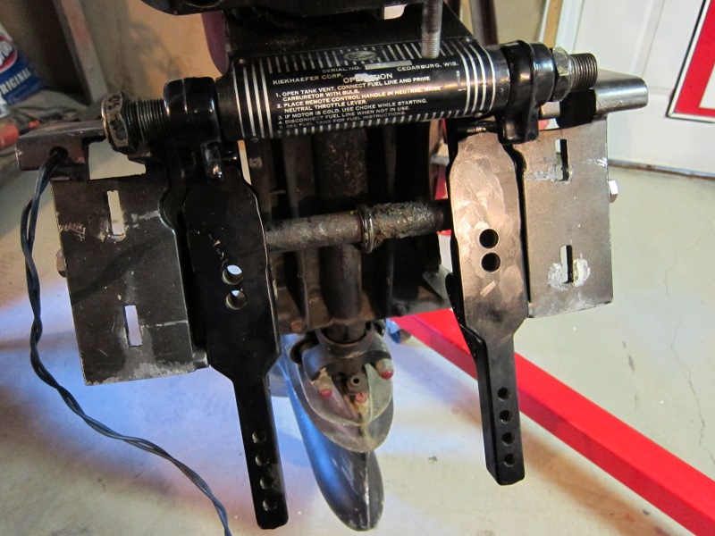

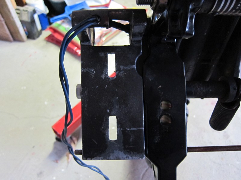

"Cool" clamps would not work, and trust me, I spent oodles of time trying to get them to work. Basically the problem was every time I tightened everything up, it was locking the tilt up. Very frustrating. So 50 bucks, and a weekend of effort all for naught.
I went back to square one, and last night with a few minutes in-between puppy duties got holes drilled for the top of the old clamps, so now I have bolts top and bottom on the clamps, top and bottom of the PT&T brackets, and the clamps si8tting directly on top of the jack plate. I need some more stainless bolts of specific sizes, will remove everything, cut the clamps off where the old t-handle screws went through, clean everything up, and maybe give them a coat or two of paint, then reassemble. If I don't get this stuff done soon, I won't have much of a boating season. Having a 3 month old puppy steals a lot of time from my shop projects.
Frank
Re:Cool clamps 14 years 6 months ago #60901

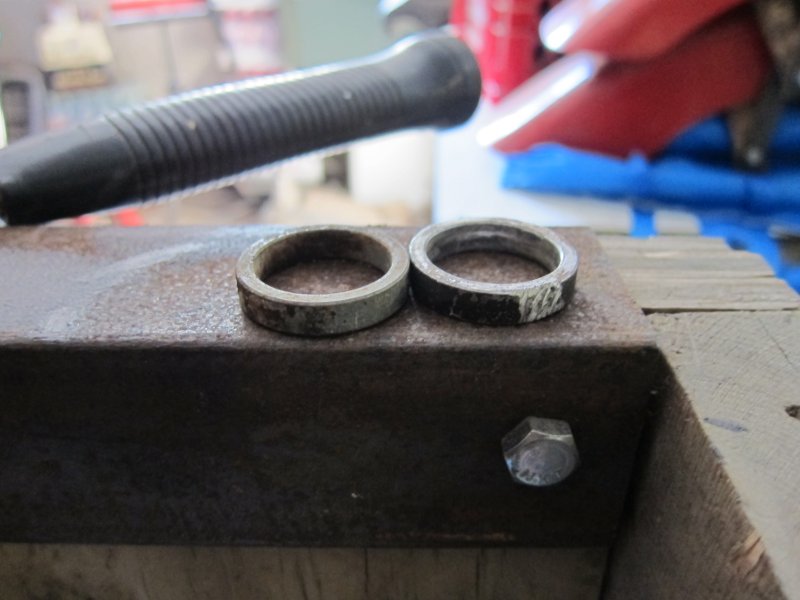

Did you get the the cross tube from the guy you purchased them from? Or did you have to pull your cross tube from your 1000 clamps and use it? (the tube that supports the halves and the the big bolts thred into to hold the trim brackets on)
Im just guessing here. But Im guessing you are using the 1000 cross tube in those newer style clamps possibly and the 1000 tube may be short and when you tighten it all down it sucks in the middle/ bottom of the halves and binds the mech. Also the bottom 1/4 all thred should have a spacer tube over top inside to set the space between the halves.
Conrad
Re:Cool clamps 14 years 6 months ago #60907
I did not get a cross tube with the clamps Conrad. Didn't know I needed one, and the fellow I got them from must not have known I would have problems. I haven't told him about it yet. But I bet you are correct, and that was my problem.
I never had a spacer tube over the all-thread. That's a capital idea. I'm pretty sure the instructions merc offered for adapting their early PT&T did not suggest that. They did suggest the threaded rod. I could look when I get home. Otherwise I could pick up some 1/4" i.d. tubing and cut it to length. That would a big help I think. Thanks Conrad!
Frank
Re:Cool clamps 14 years 6 months ago #60908
Im looking at a set of clamps on a mid like your "cool clamps" And the cross tube is the same lwidth as the older style but it has a different shoulder dimention. And the plastic shims are different as well. Now that you have drilled out the center hole to fit the old style center shaft, I think you may be screwed. Because the newer style shaft that you should have gotten with your clamps is smaller.
Sorry to be the bearer of bad news... I think if you would have had the correct cross center bar it would have went together just fine.
Conrad
PS all my mercs with power trim have a 1/4 inch spacer tube ont he bottom bolt to keep the spread correct when tightening down.
Conrad
Re:Cool clamps 14 years 6 months ago #60909
Conrad, you are not the bearer of bad news. I already figured out I threw 50 bucks down the proverbial drain. So it goes. Never done any of this stuff before, so I learn as I go. Thankfully it was only 50 bucks! It's the time consumed that bothers me, but that's water over the dam.
I like that spacer idea. Maybe I do have one around. If not, I will pick one up before the weekend if I don't have some already in the shop. Everything has to come apart again anyways so I can do my clamp trimming, clean the clamps up when I'm done, and give them a coat or two of black.
Onward!
Frank
Re:Cool clamps 14 years 6 months ago #60910
If I was you I would see if the gentleman has the cross bar you need. Tell him your situation and have him send it to you.
That way you can look at hem side by side and you might find that you can modify a spacer to fill the gap you honed out.
Thats what Id be doing. They might not be lost yet.
Conrad

Frank your always welcome to come make a spacer on the lathe.
