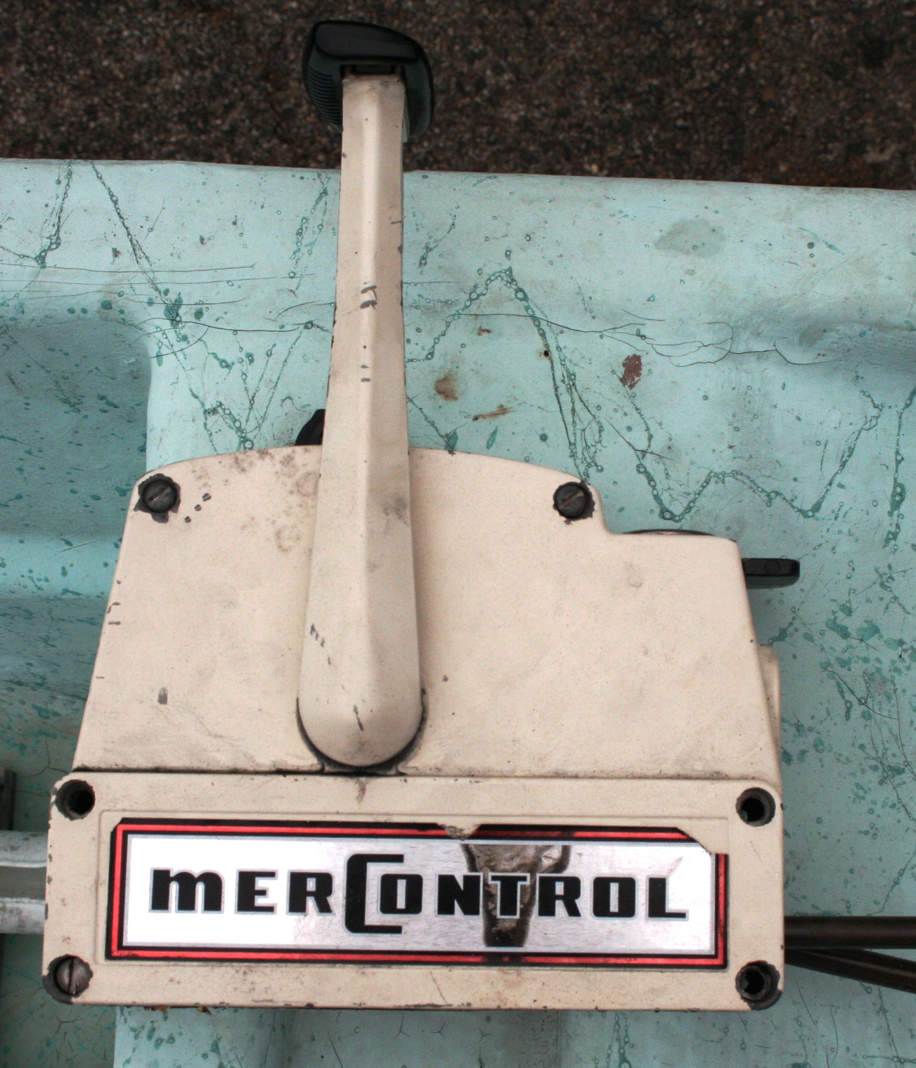

Hey guys,
Had to do a little ignition switch tinkering on my '70 1350 and opened up the control box to replace\repair a few things. Everything in the box looked good otherwise and I cleaned and lubed all the mechanical parts inside. Running through my function check, the 'warm up' lever is coming out of its stowed position when advancing the shift\throttle lever to full throttle.
The ball detent for the warm up lever that helps hold it in place seems to be working properly and I don't see anything else obviously wrong... Any idea on what could be causing this and how to remedy it?

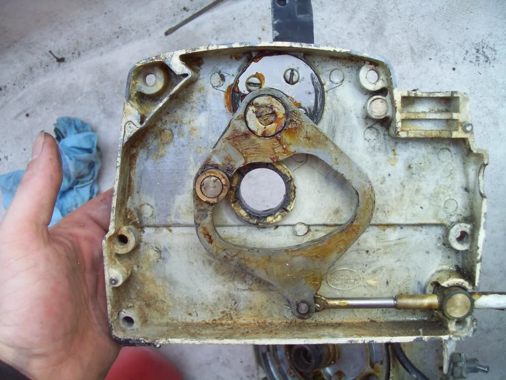

I have 2 1970 Mercontrol units like yours (I think). One I use and the other is for parts. I had the same problem. If the throttle lever is hard to push it will raise the WUL. The harder to push the harder it will try and engage the WUL. If the WUL is engaged you cannot push the throttle beyond a certain point. I replaced the warm-up lever detent as well.
PLACES TO LOOK
I've noticed if the handle is not fully engaged with the toothed wheel there will be slack and things will bind. Get any dirt or grime out so it fits tight. These are simple units but hard to diagnose!!! Also where your ignition wires sit between the 2 cables you might check for side to side play (if it's not snug). I don't have ignition cables so I use a custom made stopper in place of the wires to keep them spaced apart. You might try taking it apart and just putting it back together again... sort of a "reboot." After a lot of tinkering I got mine working smoothly.

Here's a pic of the WUL cam. Make sure the unit shells fit together snugly after having it apart. There are 4 main nylon bushings... make sure you have them all:-)
