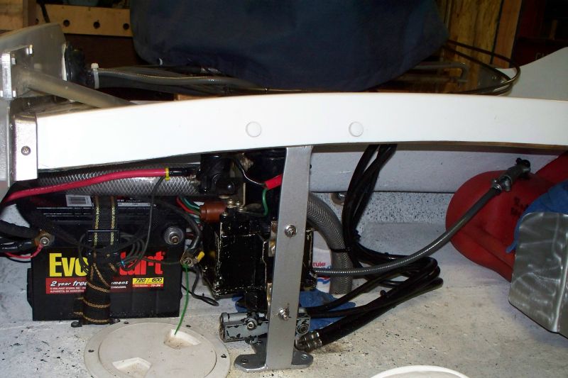

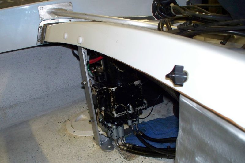

I'll post a picture later showing how I 'stuffed' the trim pump under the splash well of my G-3. Maybe it will inspire some 'out of the box' thinking for your completely different, but equally unique set up.

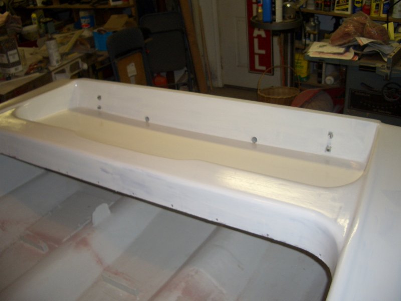

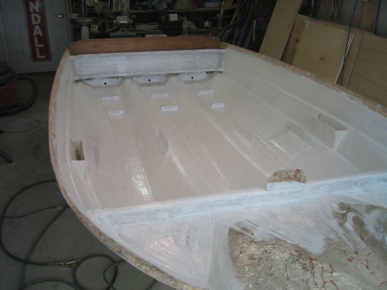

My splash pan is mounted, glassed in and painted Doc, no problem there! Buy I do not have a floor to bolt or screw anything to like you do on yer gee three. My floor is the hull. Not having a floor makes walking around in the boat a bit dicey, but then again, weight is a speed boat's enemy, and not having a regular floor is gonna help me out there.

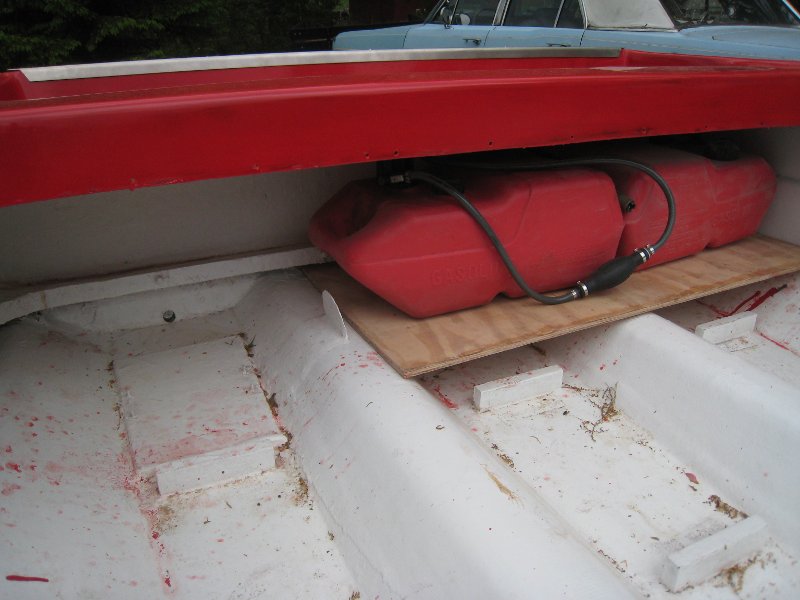

I cut out a piece of 1/8 aluminum plate last night to mount inside the transom where the clamps go. It's 11 1/4 X 3 3/4, though I may cut the length down a bit. I need to find a counter sink tool that will work with aluminum, then hopefully today pick up a piece of .080 or .125 plate for the exterior where the motor rests against the transom. Then I can stick the motor on. I'll be doing all my center measurements while mounting these transom plates. My goal is just to get the motor on the boat by the weekend, then I'll start screwing around with how I'm gonna be able to mount that trim pump. I've got some ideas, but can't figure it out till I get the gas tanks in. I have a glassed piece of marine plywood (somewhere!) that stretches across the middle and port tunnels to set the tanks on. I know where the battery goes, I got a piece of marine plywood glassed to the hull/floor on the starboard side, and glassed in the machine screws to hold tie=down straps (see the pic). I should have a better handle on this by Sunday.

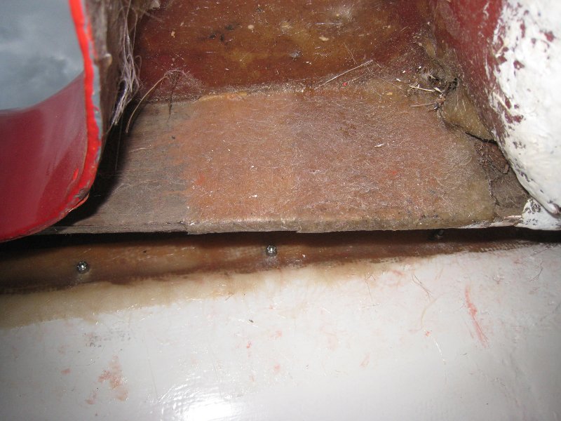

Mounting PT&T pump 16 years 6 months ago #6082

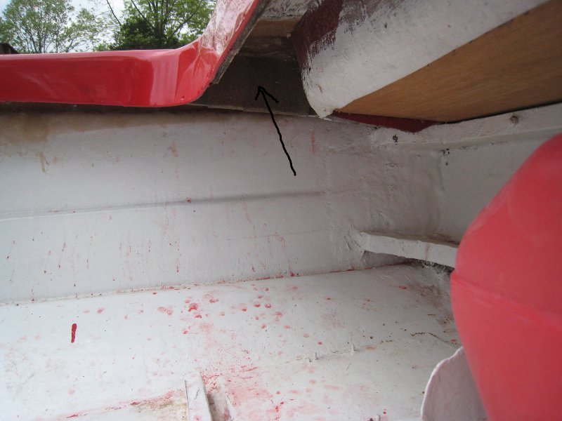

Here's the deal. Can only get the tanks in sideways, other wise they stick out and I can't get a back seat in. Can't lift the battery to put it in the boat because of my back. Will get my son to do it later today. Looks like the only place I could mount the PT&T pump is off the starboard side, see arrow in pic.
In the last pic, you can see the nyloks and flat washers on 2 of my #8 oval head stainless machine screws I put the rub rail on with after two layers of matt and resin on the shoebox seam. All the Phillips oval heads are clocked too. :)

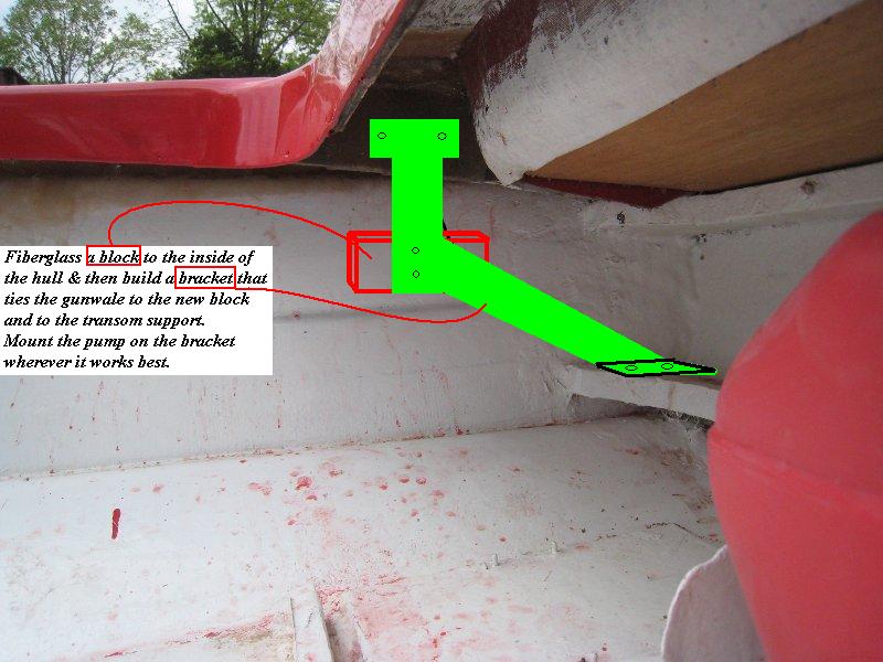

Re:Mounting PT&T pump 16 years 6 months ago #6097
What about something like this?
I'll bet somebody can run with this basic idea and make it better.
Thom

When my kid gets home, we'll put the battery in and check it out. Thanks Doc, I'll keep ya posted.

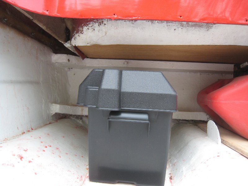

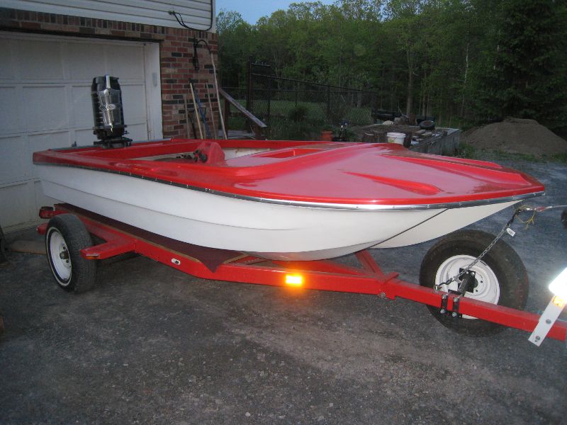

I got kind of tied up last night mounting my merc. Gregg picked up a battery box for me (I'm told it's a legal requirement for boats in NY nowadays), and we set it in the spot I built for the battery. Getting my trim pump in here is gonna be a challenge, but we'll figure it out. Any suggestions would be greatly appreciated!
By the way, my thanks to Dave Bernard for the suggestion on centering the motor. I think using trinagulation as he suggested, I got it within 1/64" of center.

I like Dr Frankenmerc's idea but I was also wondering instead of crowding everything into the lazzerette of the boat with fuel, battery and hydraulics why not try to work some magic with the rear seat. I am sure the back of the seat will need to flip down to access the lazzerette for the fuel tanks but I would imagine if you crowd the space it will be difficult not only to mount things but also to work on things. Maybe move the battery to under the seat at least and save the space behind it to run the hydraulics and set the fuel tank's. Try a tank either side of the stern put the hydraulics center and under the rear bench seat center the battery.
An acid proof plastic battery box is required everywhere I thought. It only makes sense to anchor the battery and its container box real good to keep it safe from falling over. You don't want battery acid in your bilge. Its too bad you didn't put a fuel tank up forward under the deck like a 12 or 18 gallon. That would have allowed more breathing room at the stern for battery and etc...........
She looks good with that Merc on her. Glad to see it. Your hard work is about to pay you back! Get the tilt rams on. I am surprised they got to you so quick. I shipped them UPS ground. Those came off of a fresh water Merc 800 I have so they should work no problem.
