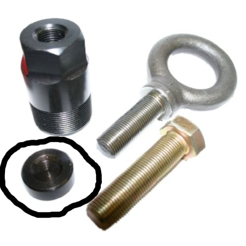

I have bought a couple merc flywheel pullers/lift rings over the years, but can't seem to keep (i.e. "find") the little nub that goes under the puller bolt. Is that a big deal? Can I just use the bolt as is, or will that not work? Or use something else like the nub, similar, but what? Any ideas?

Re: Pulling old merc flywheels - question 14 years 7 months ago #58323
Frank you need that washer/thrust button. I hozed my flywheel puller by not using it. Its there to save the threds on the end of your bolt and save the top of your crank. I ruined my bolt because the threds got all mashed from pushing on the crank.
Now I cannot get the bolt out of the puller body :( And no way to cut it off clean again inside.
I have lost that damn thing too about a hundred times. Next time I get it all together Im putting it all in a tupperware container.

Re:Pulling old merc flywheels - question 14 years 7 months ago #58325
After I posted, I was thinking the last thing I want to do is damage the top of the crank Conrad, let alone the puller bolt, so yeah, I need to do something. First task is to get everything backed out. My impact wrench stopped working on me right after I had tightened everything up, so the first "trick" will be to see if I can get things apart. The next trick will be to figure out what I might use that I have around that would be hardened and do the job without damaging anything. I've got some ideas, so we'll see. Right now it's the parts motor, but even though it looks like the powerhead is beat from the outside, there's a chance stuff inside is good, so I just want to be careful.

Re:Pulling old merc flywheels - question 14 years 7 months ago #58328
grind the bolt into a tapper and leave a nut on the crank. should work fine.
Conrad
cit the head off make a slot and use screwdriver to run it all the way down and use a new bolt as discribed above.

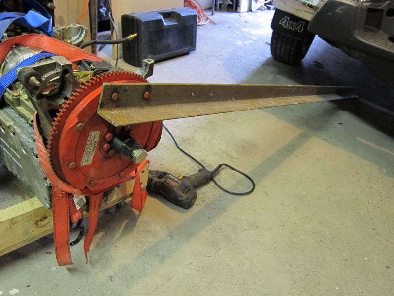

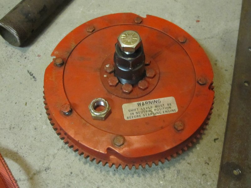

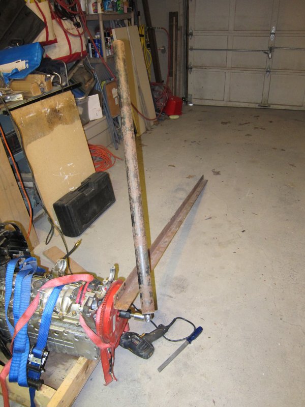

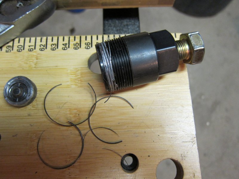

Fun & games pulling an old merc flywheel 14 years 7 months ago #58381
So far I've destroyed both my flywheel adapters for the lift ring/pullers. First one got destroyed last night when I didn't have a bushing between the bolt and top of crank. I was able to get it off this morning with a little help from a piece of angle iron and my pick-up...
Once I got that out, it was obvious the threads were gone from the adapter. It was REAL difficult getting the 5/8 bolt out, but I did, then used a thread restorer to get the bolt back in shape.
Because the motor was lying down, I used some gorilla tape to hold the bushing in Jesse made for me yesterday and got ready to go at it with my other adapter. Because I was I was now trying to turn it clockwise, I didn't need my truck, just the concrete floor...
With my 1/2" breaker bar, 15/16 socket and cheater pipe I started to turn the bolt clockwise. Boy, it was hard, but I kept at it till it seemed like it was getting easier. Boy, I thought, that's great, it's coming off! Nope.
I got thinking about how I can get the flywheel off some other way. Then I thought I'd look at another in-line 6 flywheel, maybe it would give me an idea. Sure enough. I'm an idiot, and should not be let near motors of any kind. I had not removed the nut from the end of the crank. This is very embarrassing, but maybe my admission will help another poor soul.
I was able to get an adapter threaded in, and presto zippo, done...

Re:Pulling old merc flywheels - question 14 years 7 months ago #58737
Thanks Tim. As it turned out, it taught me a good lesson! My friend Jesse showed me a good way to hold the flywheel - a 1" strap with a hook and 16-18" piece of wood that is of a thickness that fits in the side of the flywheel. I hook the strap to one of the top mounts (like the starter mount), wrap it around the flywheel, loop it around the stick, then wrap it around the flywheel and the other end of the stick real tight, tie it off, and turn (or hold) away. that's more a two person thing, but if you're by yourself, the angle iron works just fine.
If you have a place for a chain hoist to hang, you can't beat them. I used to, but not in this house. I had to buy an engine hoist. Got mine at Pep Boys years ago, paid $110 for it, and use it all the time.
Good luck!
Frank
