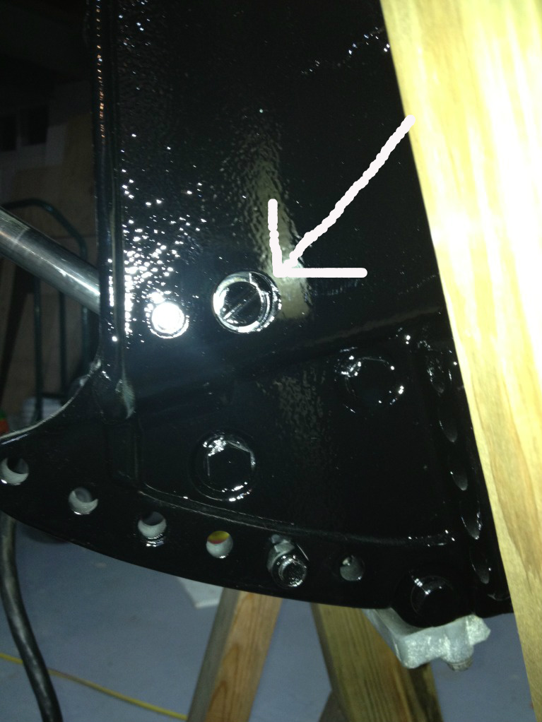

I figure it is simple enough to swap the PTT fluid, but when in doubt, ask!
I suspect this is where I drain the fluid
And this is where I add it (I'd have this open when draining the fluid so as to break the vacuum)
Do I just fill it till I see the fluid?

Peter in this photo it should be the release valve. Do not remove the screw. It is about a 100 dollar part.
Re:PT&T questions 14 years 7 months ago #58167
so I am not sure what you are saying
Do I just loosen that screw to let the fluid out? And just need to make sure I don't take it all the way out? Or is there another valve that I am not seeing?

that screw should be plastic. You only turn it (counter clockwise if mem serves me right) to raise or lower the motor should the motor fail or you need to bleed the system.
At some point tomorrow or tuesday I will go look at one I have in the barn and locate what you are looking for.
