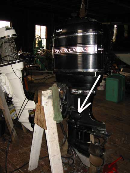

I have had some people suggest I run solid mounts in this 1350 I'm getting. There are upper ones and lower ones. What do these solid mounts replace and where on an inline are they?

I will show where on Saturday Frank

The upper ones are on top of the leg or a few inches under the block.I was looking at them as well but never did it.There is a vibration that will occur vs the rubber mounts.I did not want any premature" stress cracks" popping up on the transom due to the vibration. I believe with the way the Cats track,straight, that there is no plus to buying them for what we use them for.If you had a squirlley hull and were planning on 65+ mph then I would install them. If your mind is made up,plan on tearing the motor down to get at them and spending more money.You will not gain any speed with them on your hull.

I run solid mounts on both of my G3s, It cured alot of hi spd issues I had in reggie, but didnt help much with ugly Peg, The bow of Reggie would do a figure 8 and the stern would just go side to side,"chine walk" solids made it a real fun ride, Peg on the other hand needs more help......like a strait hull!
And yes I have some viberation, I only knoticed it @ and just above Idle, now I dont even notice it at all. The mounts I pulled from the 85hp where all eatin up from fuel and where very sloppy. The 1250 mounts where dry but brittle and again very loose.
So even if you dont go solid you might want to replace with some new ones any way. dont forget to ck the swivel for slop too.

MY 1250 had lots of swivel wear. It did not have bushings so I swapped in a better mid assembly
My 1500 was wore but had plastic bushings that are still available online.
My boat as well you could watch the noze circle back and forth at WOT at the motor moved ever so slightly back and forth.
Those motors have to be close to rock solid to run fast and behave comfortably.
And yes the powerhead and mid need to be dissasembled to get them in there.
