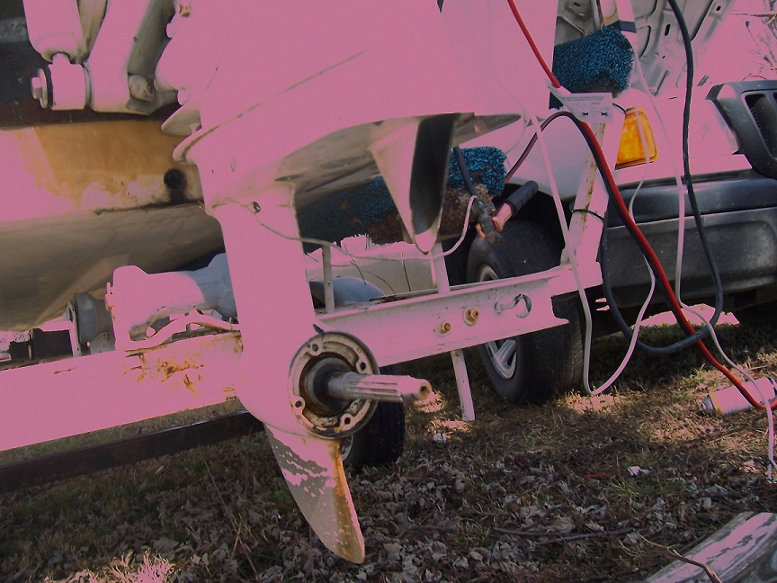

Today I finally go everything adjusted as per Master service manual; timing, carb idle, throttle stops, etc. jumping from my ranger, battery is 700 CCA. Control wiring I jumped through the exterior harness. Black ignition, yellow forward start. First time with all the plugs out and one plug grounded. The motor spun well and had spark at the plug. Replaced plugs and primed motor. Not enough power in starter to spin. Then I noticed gas was pouring from the opening behind the water inlet screen ( water return port?). I assume this is bad. Given my limited knowledge on outboards I think fuel getting into the cooling passages is not a good thing. Open for suggestions on next plan of action. By the way motor is a '59 Mk 78AE. THX Daniel

your description of where the fuel is leaking confuses me, can you post a picture

I can't get my camera to work. It is the large triangle housed opening hanging from the cavataion plate just in back of water inlet screen

work on your carbs etc, thats excess fuel leaving the flooded cylinder and exiting the exhaust snout....no worries

I did get a pic. The housing seen from rear behind the intake and above the prop shaft

Forgot I had to shrick pic to < 800. Never started it before, Don't know how long it sat. When I took the plugs out they smelled like gas and had black residue llike it had been run rich. Will try to shrink the pic. I thought this was the water exit port from the engine, could be wrong would not be the first time. How coud fuel get into there.
