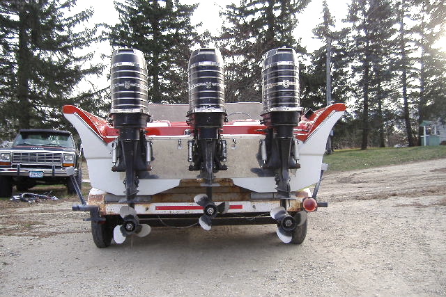

You will see in my picture of my Powercat that there are 3 merc 1000s on it. Now when I desided to do the triples I went and looked up weight. My 2 1985 115s that were on the boat weighed 315 each thus 630 lbs. I looked up the weight of a 1963 Merc 1000 and it was 198 lbs. So I gained 70hp and lost 36 lbs. Now as for comments about these weighing 250 or 295 thats way off. I can pick up my engine and carry it accrossed the shop and I weigh 135. If they were that heavy I could not do that lol. When we move one of our 1100SS both my son and I have to carry it so I would say 250 is a good number, the newer the engine the heavier they got.
Cowboy

That is a pretty impressive set-up you got there. I'm sure you get a lot of comments at the boat launch. Nice wide boat too, but would have to be to hold those nice Merc's. How did you figure out which way the props turn, or at least the one in the middle. Or do they all rotate in the same direction? The weight of these motors probably will always be a topic of discussion or debate.
