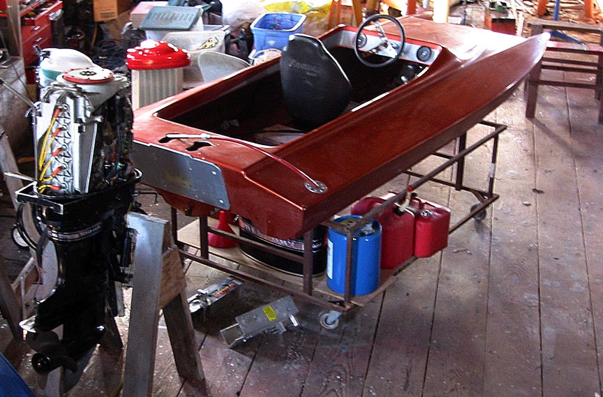

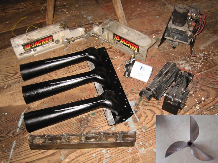

I have found the last of the parts I needed to put this tunnel hull together... fast, loud & obnoxious
I will most likely need another $500 in bolts and bits that I havent seen coming as all projects do but Im ready to start the overhaul on the motor....wish I had a Speedmaster lower unit
Im getting excited about this project

Also think about carbs. If you run stock carbs/jets keep a close eye on your plugs. The pipes will pull hard and possibly require bigger jets than factory.

Also it would be interesting to set up and run this boat motor combo WITHOUT pipes first. See what it will do. Then add the pipes and see if there is a performance gain. Big pain I know, but interesting.
Would be hard to not put them on right away.....
If you use the cut lower cowling you could swap them on and off in an hour I bet.

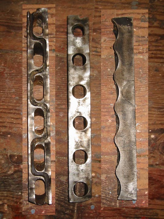

Do you have a better pic of the interface block between the pipes and the block?

Dave
here is the filler block close up you wanted to see
Re:last of the parts 14 years 9 months ago #55854
Thanks, I have seen drawings for the filler plate, and I understand its purpose, just having trouble creating the 3d image in my head. Like Conrad said, too bad you are so far away. I am not sure I understand the fitment of the three pieces...gotta let it dwell some more.
I have design software to create tuned pipes and emulate the results, I would like to experiment on the inline 6 just for fun.

Dave
I can make you a video of it being assembled if that will help ?
