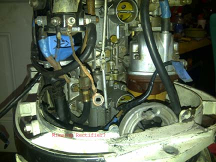

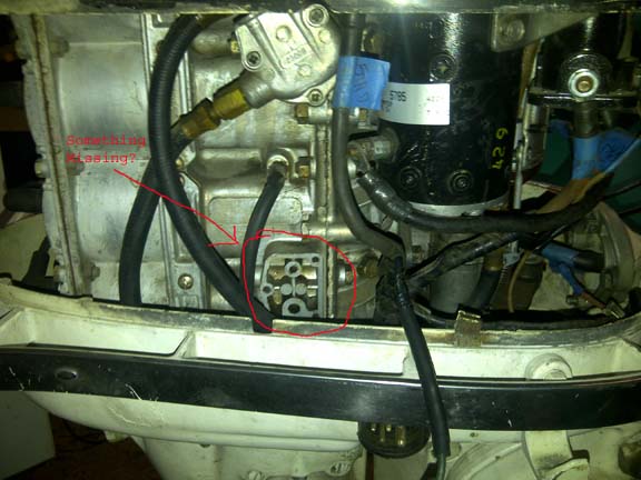

Went out to the garage with the manual and cracked open the cowl to look at the electrical and think I might have a missing part.
The manual indicated a rectifier should be in there somewhere. I seem to recall finding info about an aftermarket unit...
Is the first pic where the aftermarket rectifier should go?
Cheers,
Rob

no you are not missing a rectifier you have a starter only model.that ground wire goes to one of the solonoid mounting bolts.
that mount for a second fuel pump is not used.
