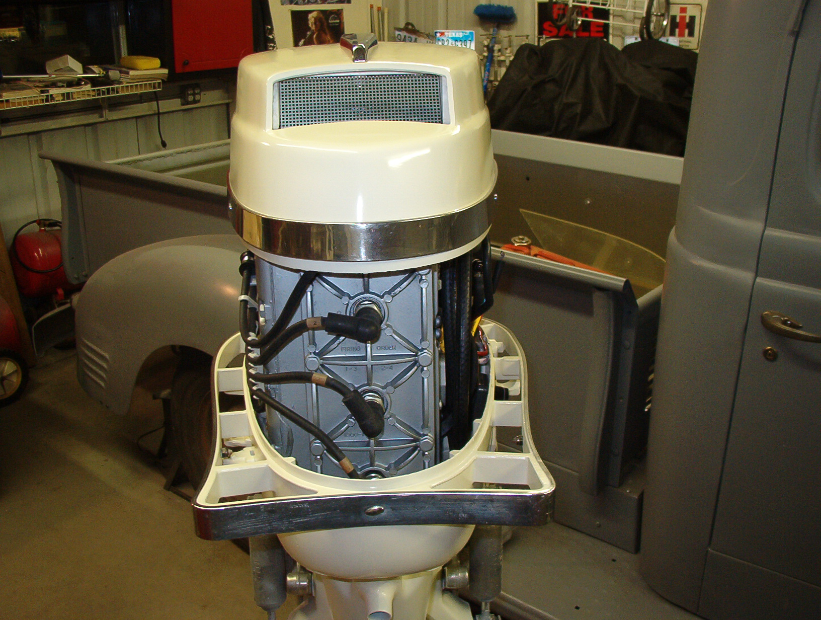

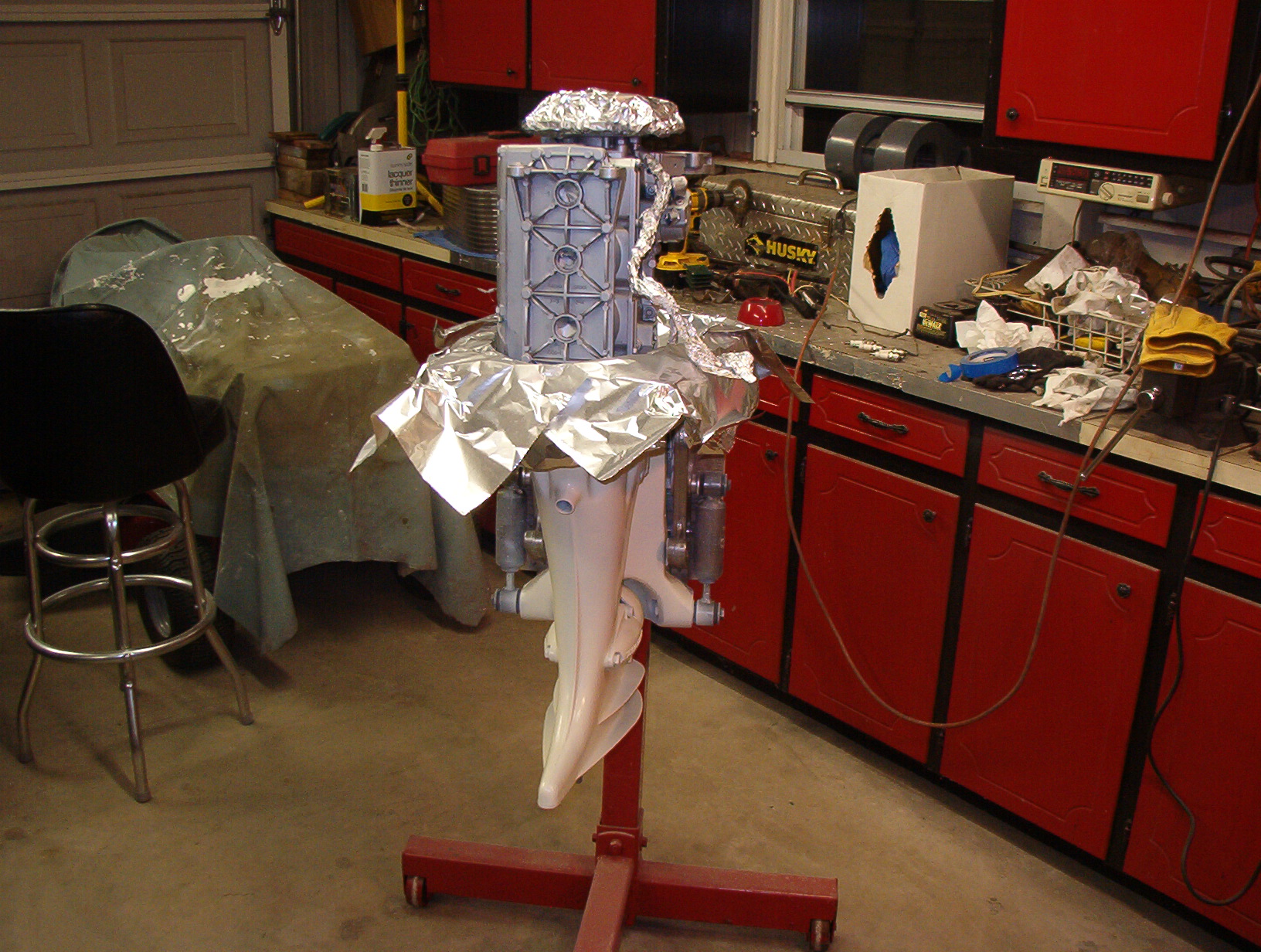

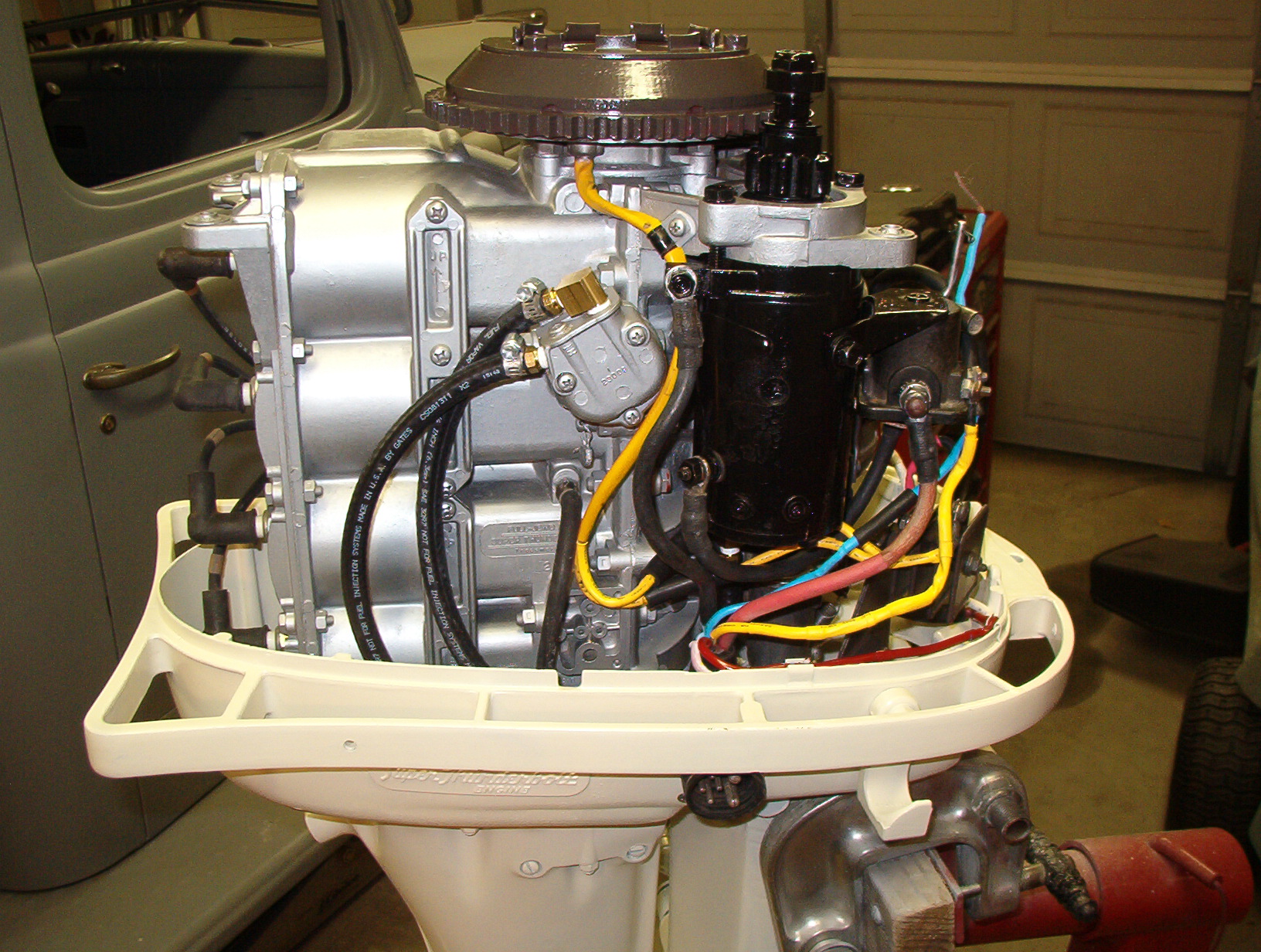

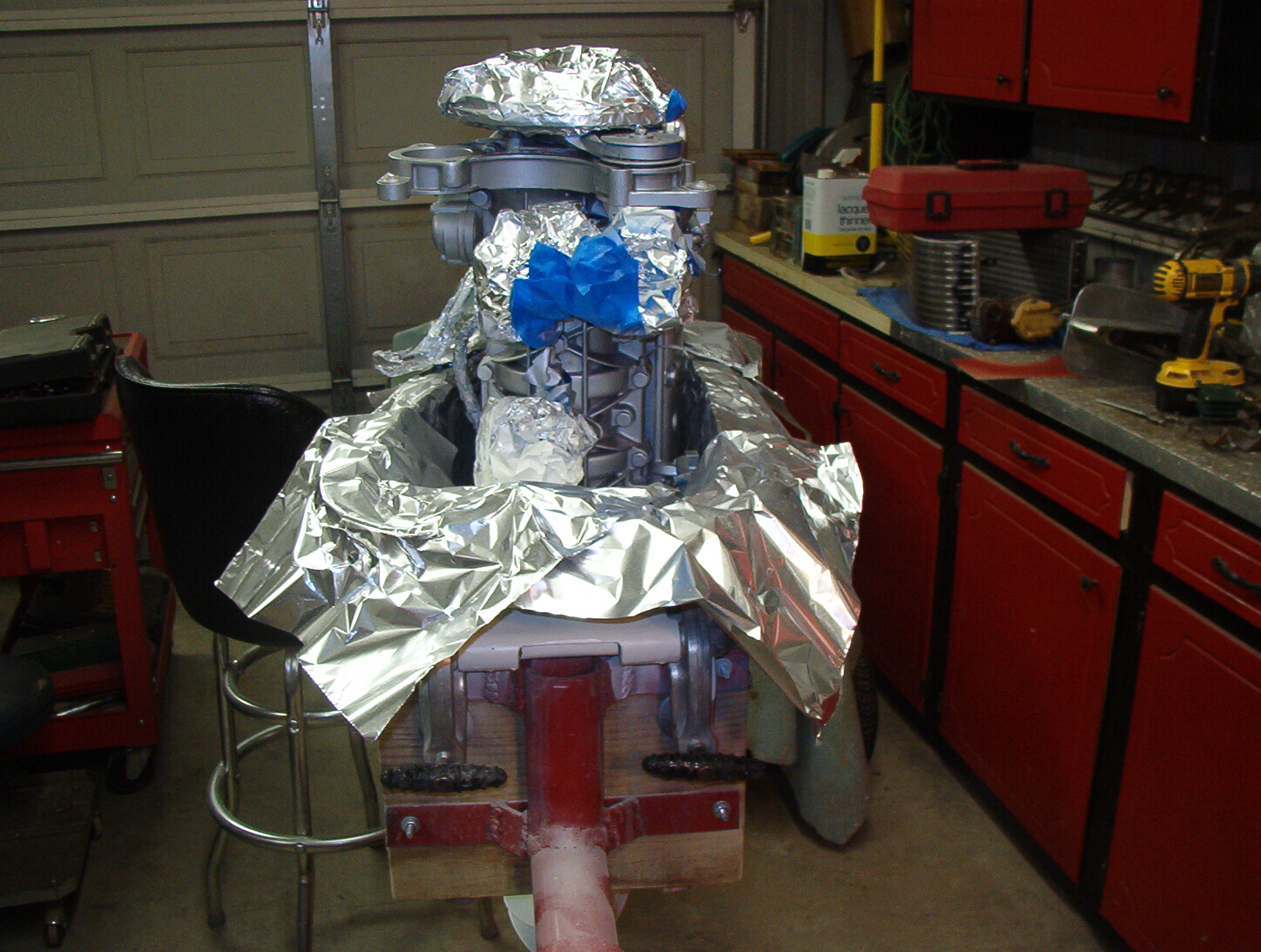

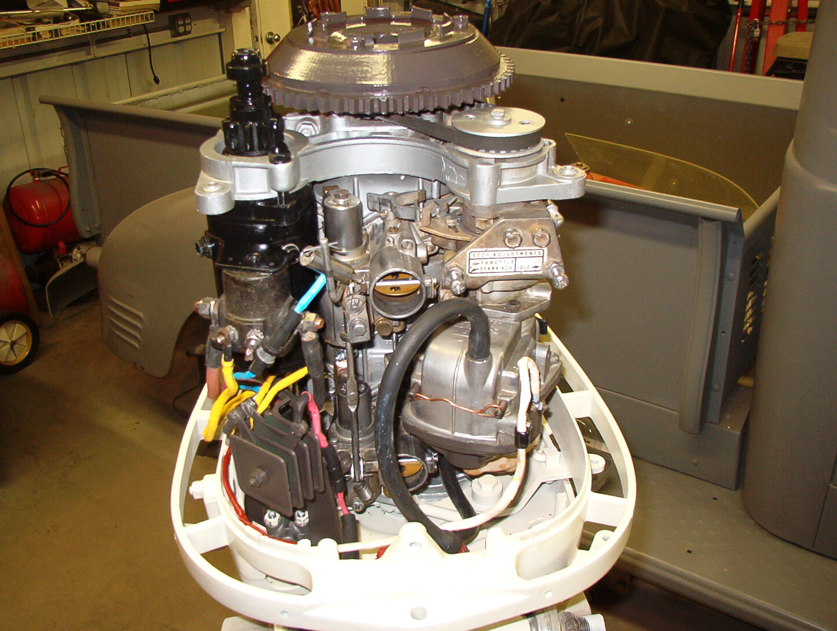

Thought some of yall might like the pics.of progress I'm making on the Merc 400. Alum. foil works great on masking, painted all the Wilbelton White first,then the engine color. Putting everything back on tomorrow if I get the fuel lines made.
Milton
Re:Making Progress on Merc 400 14 years 9 months ago #54943
Looking good there. That will be one fine looking motor when you get done with it.That paint you used is a good match to the original color. Lots of rebuilders use that color. Keep posting pics as you go along. Keep up the good work, Skip.

Looks great Milton.
Looks like that is not the only project in that shop. :cheer:

did you replace any gaskets or seals? gonna look good.

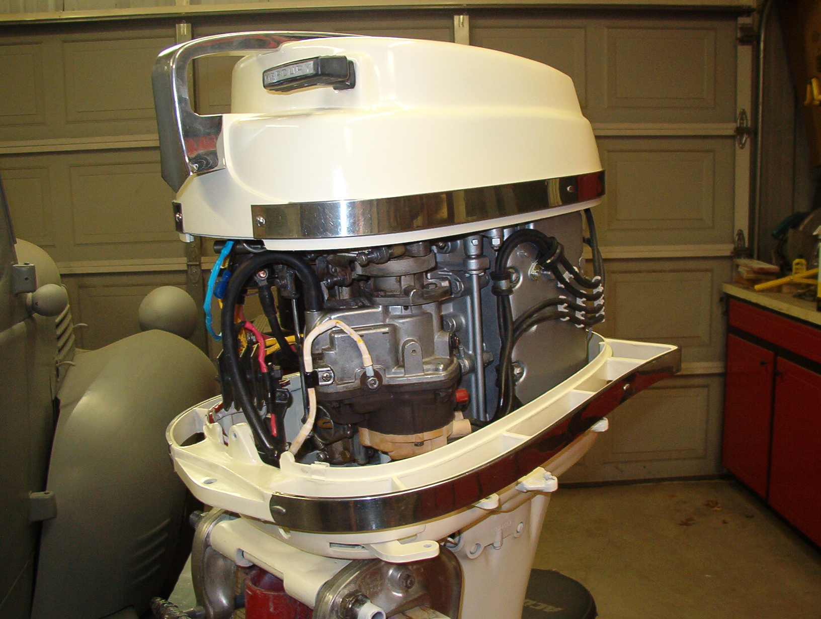

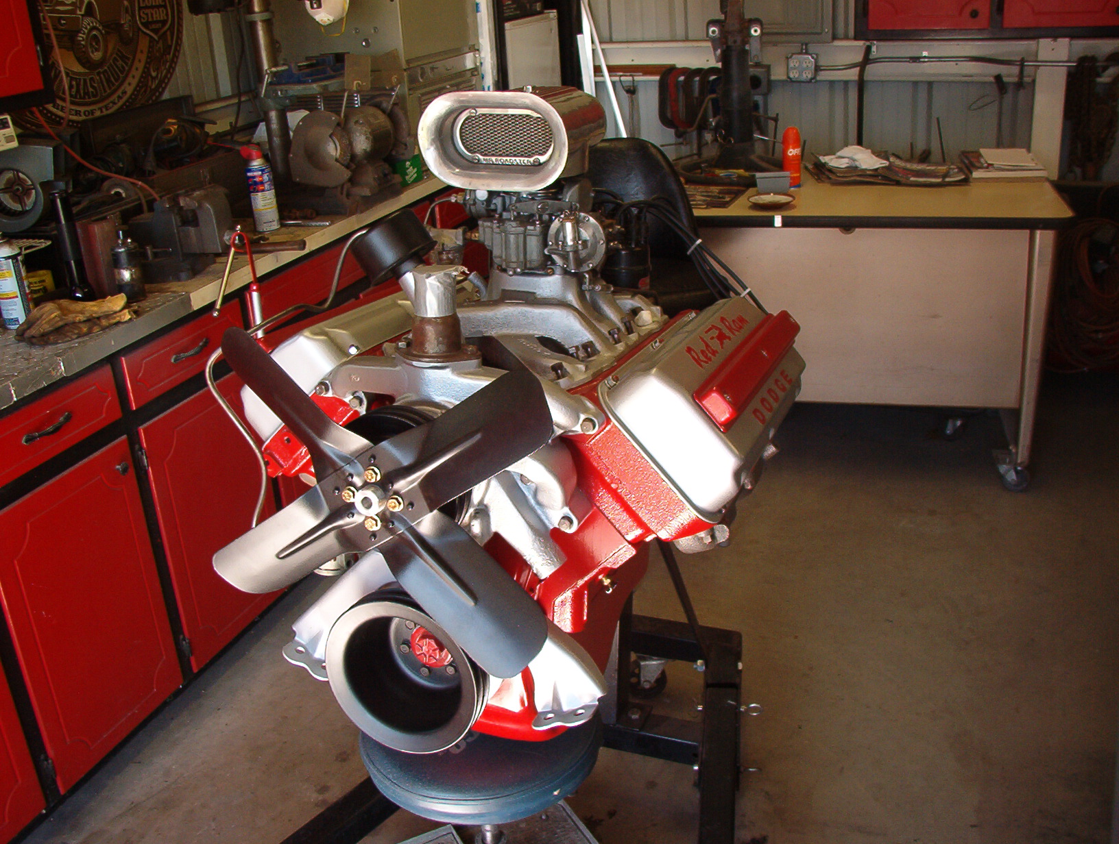

Got everything back on The Merc 400 motor wise. Gonna try to finish the hood tomorrow. Still have to tackle the water pump.

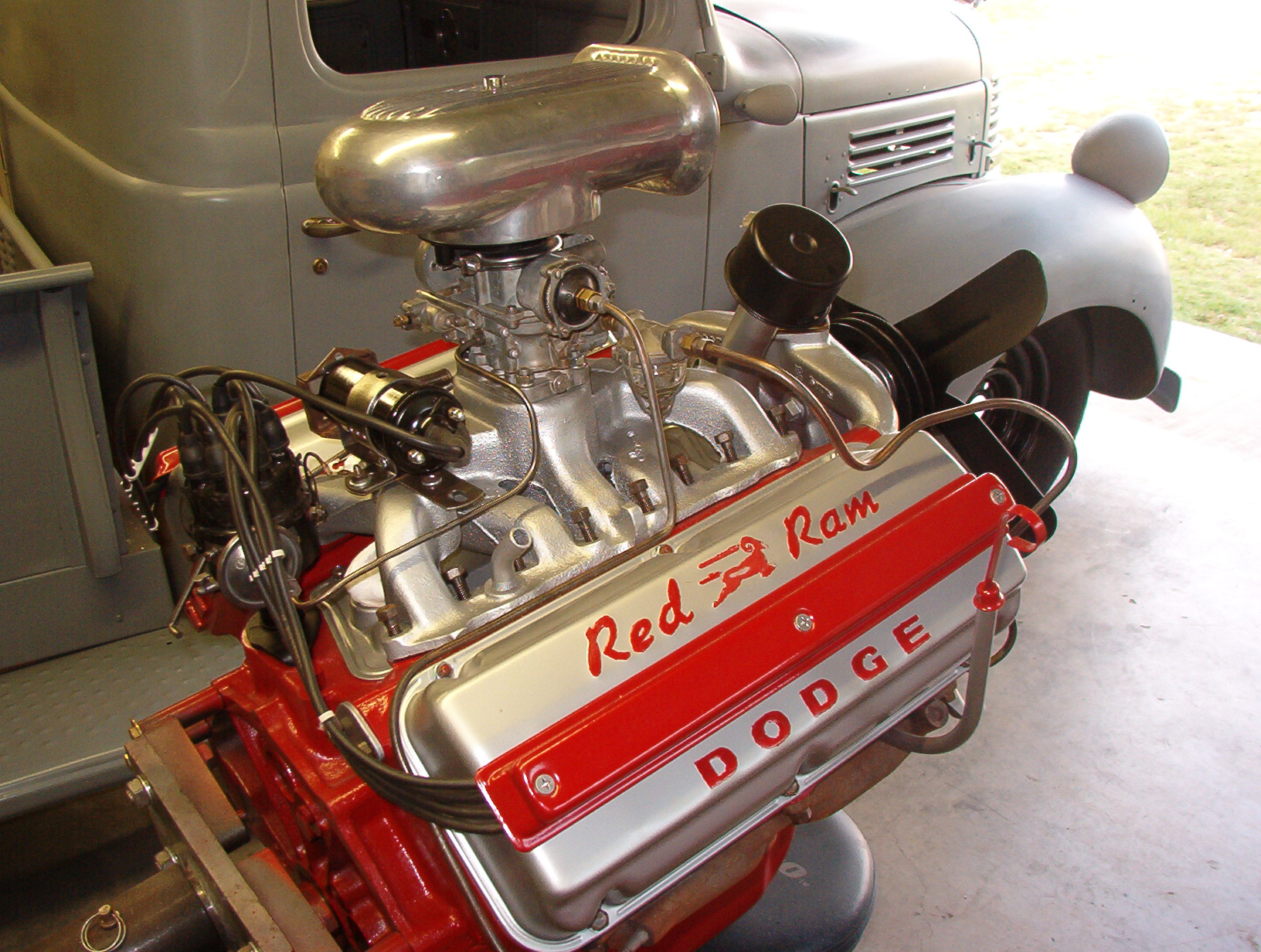

Thought I'd throw in a pic.of the Dodge 241 Red Ram Hemi ( 1953-1st V8 by, 1st year for Dodge Hemi) that's going in my 46 Dodge pickup.

had a 54 coronet w/ a 241 hemi. 2 speed auto.

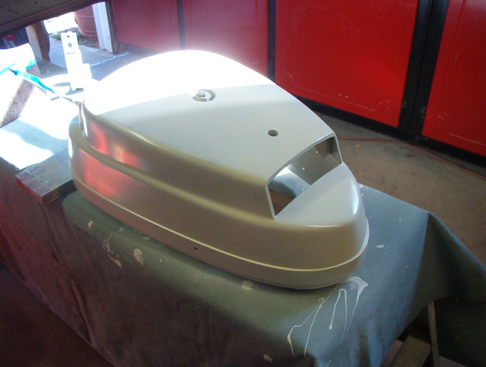

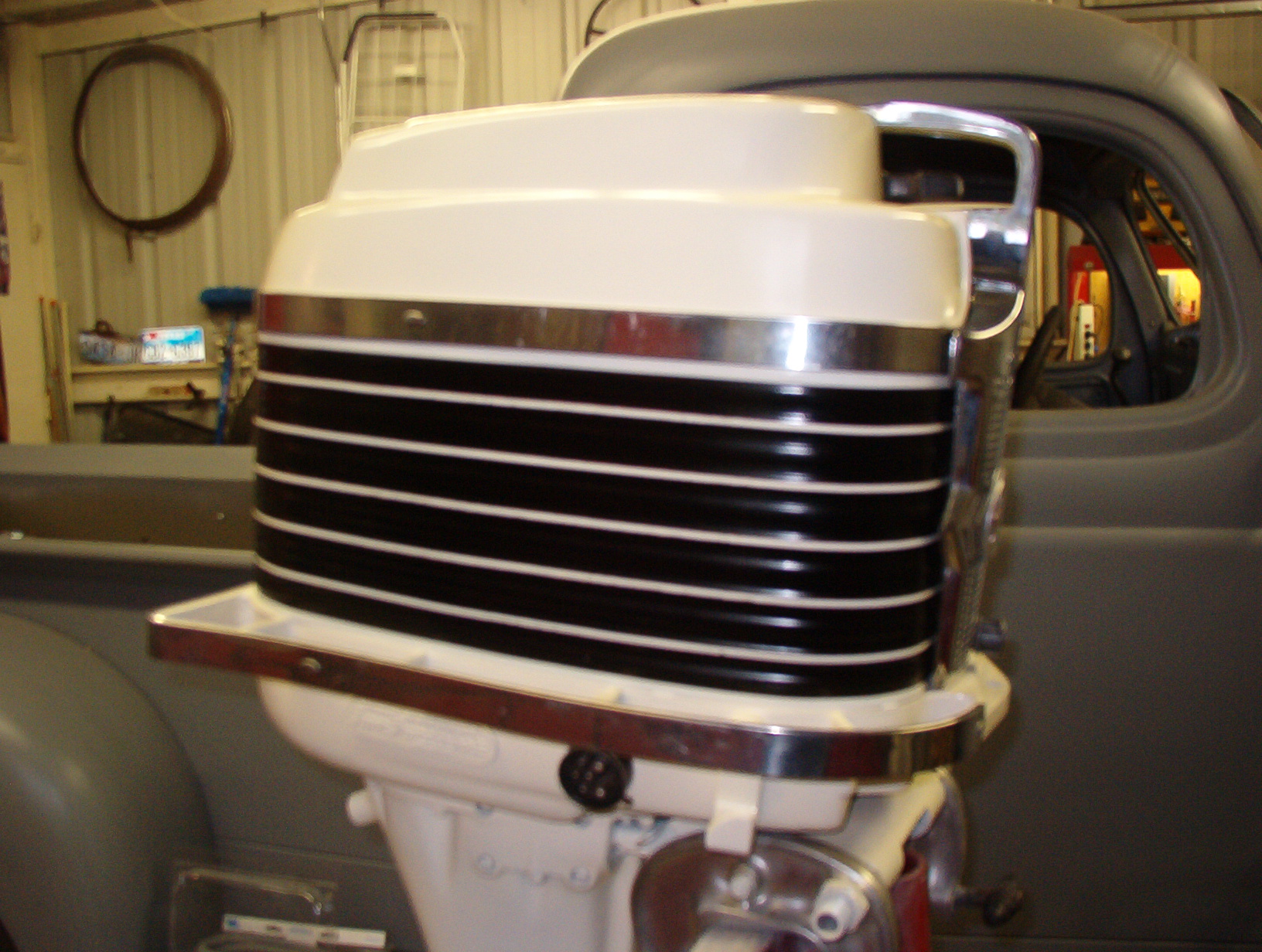

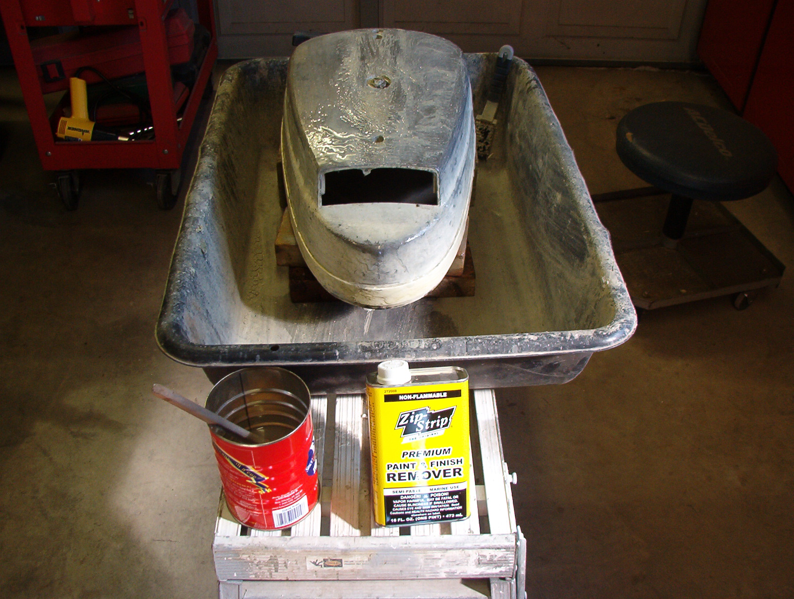

Stripped the hood this morning, got it primed,painted, and clearcoated. Got all the trim back on, turned out nice. Gonna start on the engine cover tomorrow, wish me luck. Gotta strip, work out a few dings, then start on paint.
P.S. Any tips on getting the white stripes looking good?
Was thinking about painting all white, masking off with black 1/8" tape, then the black (what color black?) then removing tape. Will that work?
Thanks in advance, Milton.

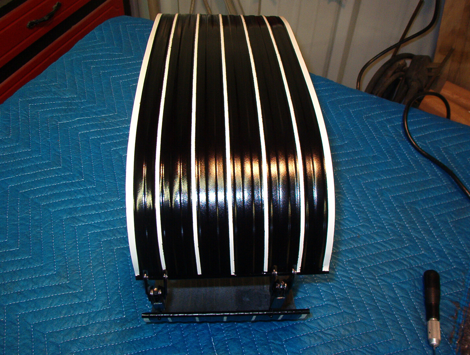

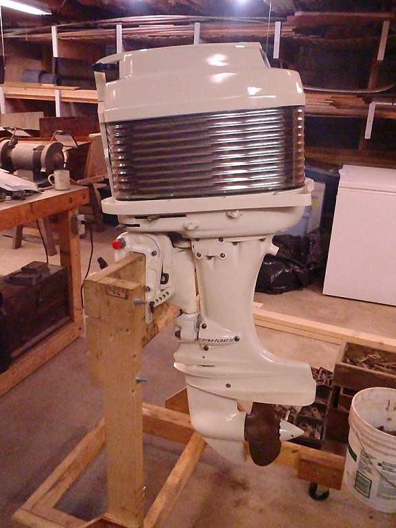

Worked all day Friday on engine cover but when I pulled off the stripe tape it pulled off the white.(get out the laquer thinner)
Today it came out better, used some heat from heat gun to remove tape.
Gotta do some light sanding to clean up small tape ridges and then time for clear coat.

Got the Wilbelton White @ O Reilleys Auto Parts, infact primer and clearcoat. About $7 or $8 ea. Just spray light coats first (about 3 times) can go a little heavy on last coat, but don't push your luck. Took me 3 times on cowl cover, 1st time had it finished and when I pulled the 1/8 tape it took it back to primer, 2nd time got in a hurry and had bad runs in white (strip with laquer thinner again. 3rd time learned to use heat gun to warm up 1/8 tape to remove, no problem. Hope everything goes well.

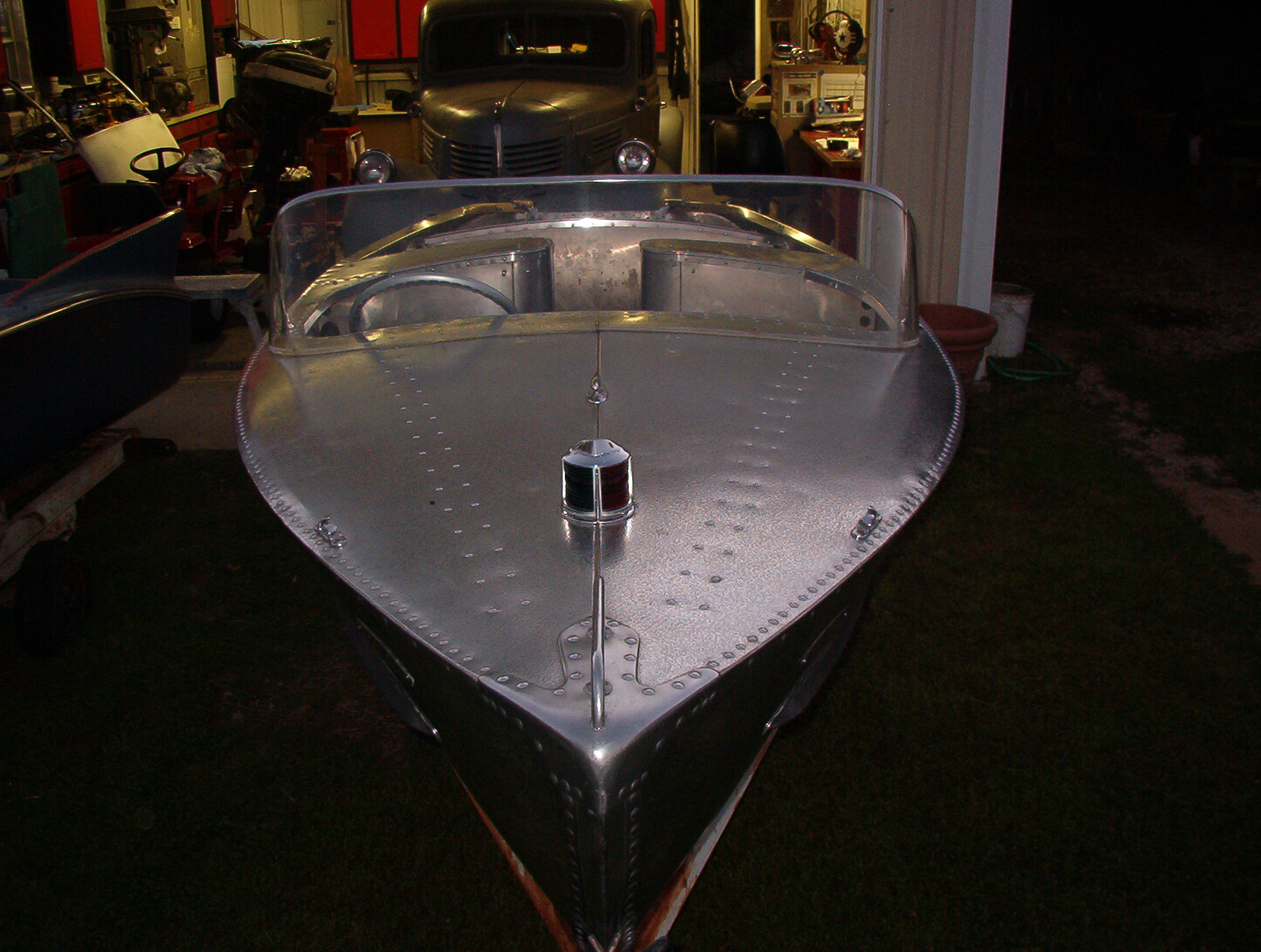

New project now, 1956 Feathercraft Vagabond ll,on with the polishing.

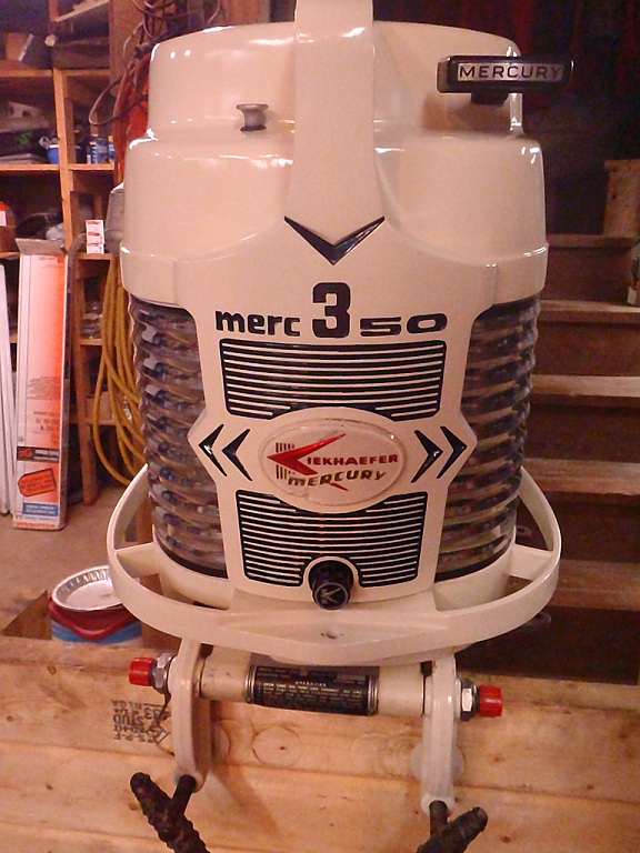

I used the Duplicolor Wimbeldon white for my 35A came out great. I got the cans at Advanced auto parts. but they only stock 2 or 3 cans per store. I also baught a case on Amazon 6 cans. I didnt do any wet sanding as it looks great right as is. Not a good pic but...
