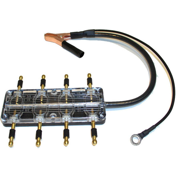

MadProp - Where does one get one of those neato testers?
Peter I have never seen one for sale anywhere, I have several Merctronic tools from my Harley shop days, we could buy many electronic testers dial indicators etc etc built by Merctronic
from the SnapOn or maybe Mac truck that came around every week
anyways I anticipated my buddy asking the same question so the last frame of the vid shows him how to make his own, the one thing I missed to improve the tester was to cut the tangs of the spark plugs so the spark is forced to jump from the electrode to your negative adj jumper bar

Here's a Super-Whamodyne spark tester mfr'd by CDI Electronics, not cheap but looks like a quality unit. I found it for under $50 at this site:
www.shopboatpartsonline.com/cdi-spark-tester-511-9766-p-78.html?utm_source=GoogleBase1&utm_medium=BaseFeed1&utm_campaign=products
$51.26 from Boatfix.com from which I've ordered many parts:
www.boatfix.com/bykeywordnew2.asp?textfield=511-9766&texttype=2
The other site has decent prices but haven't heard much about them, anyone done bizness with them?
The Good Dr. Frankenmerc made up a nifty tester, just a line of spark plugs welded to a metal bar. Use a ground strap with clamp, from the bar to motor. Break or grind the side electrodes off the spark plugs, and if the spark can jump that gap it's plenty hot.
Here's a very simple KD Tools spark tester:
www.amazon.com/KD-Tools-2757-Calibrated-Ignitions/dp/B0002STSB2/ref=pd_cp_hi_0
I made some inexpensive substitutes for this tool with an extended-tip spark plug w/ground electrode removed, and big clamp. Works OK but a tester with multiple taps would be a lot easier to use if you're working on Fours and Sixes.
Cheers...........ed

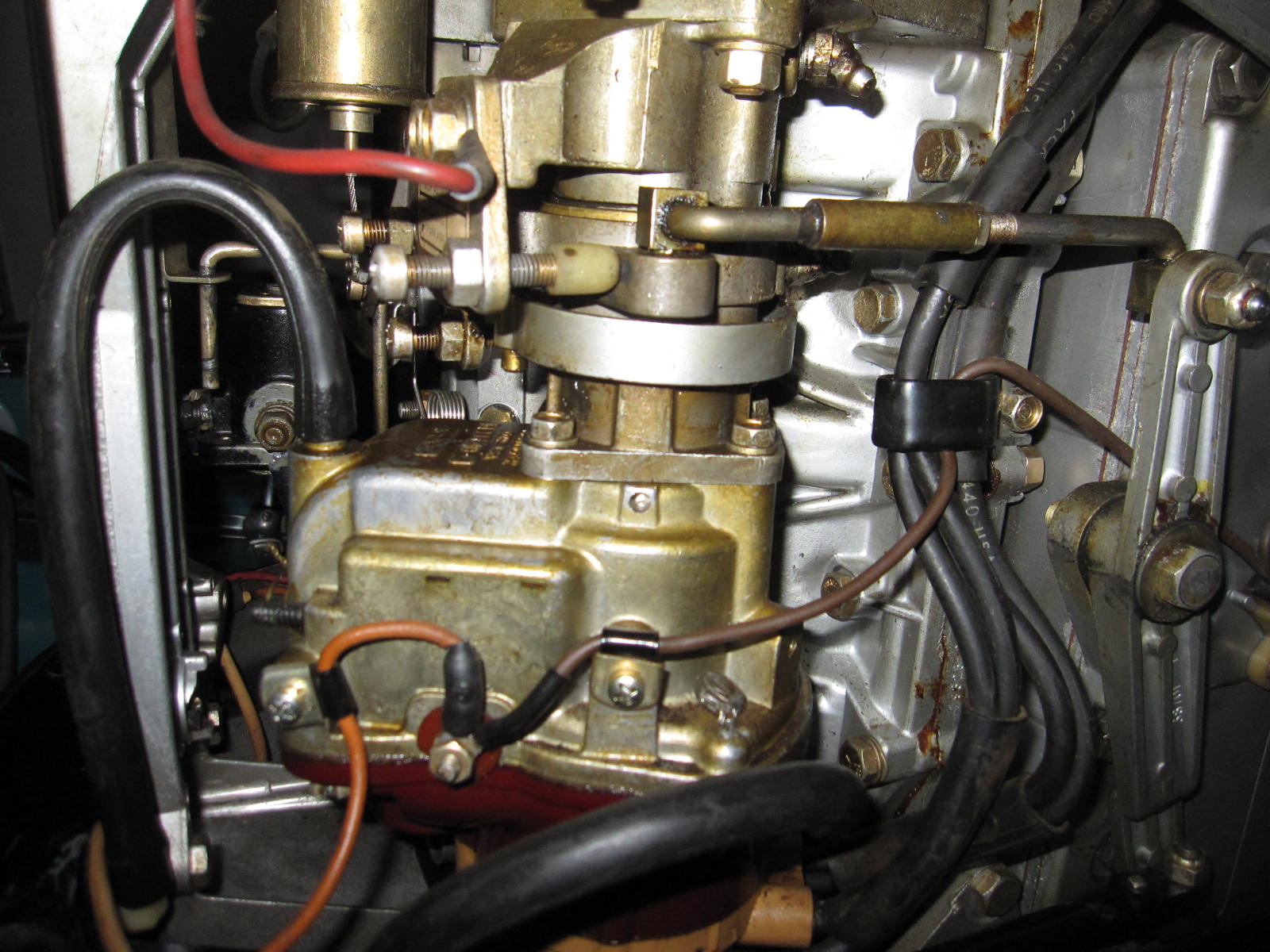

If you remove the throttle stop/idle stop/spark stop plate at the front of the mag, you'll find getting to the back bolts on the mag a lot easier.
Note that you shouldn't mess with the screws on that plate, they're secured by lock nuts for that reason (until it's actually time for an adjustment!).
The plate is held on by (2) bolts at the top. In your picture of the mag, there's a non-factory red wire being secured by one of the bolts. I'm assuming that's a ground wire installed by a previous owner.
If you still have trouble accessing the back mag bolt, pull the distributor's swivel/link rod assembly off the throttle arm. It's held in by the 1/4-28 nut and is a body-fit type, so the best way to get 'er free is to loosen the nut until the end of the threads is flush with the nut; then carefully tap the nut until the link rod assy breaks free from the throttle arm.
After that you should have no trouble getting at those pesky mag bolts.
HTH.............ed
