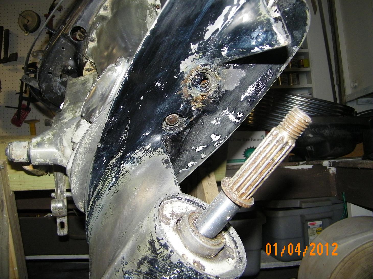

Look past the crappy appearance, in the process of stripping the paint. Is there supposed to be some type of screen over the hole for the water inlet. The po had what looked like a shower drain stuck on with silly cone.

Is this a joke you guys are playing on me? I'll use it but thinking of another way to attach it. Maybe tapping a small hole in the area somewhere and putting in a short screw.
Re:Mark 58AE water pump inlet 14 years 10 months ago #53850
Nope, they're telling the truth! It was originally held in place by tabs. You'll see the slots for the tabs once you clean up the area around the hole...

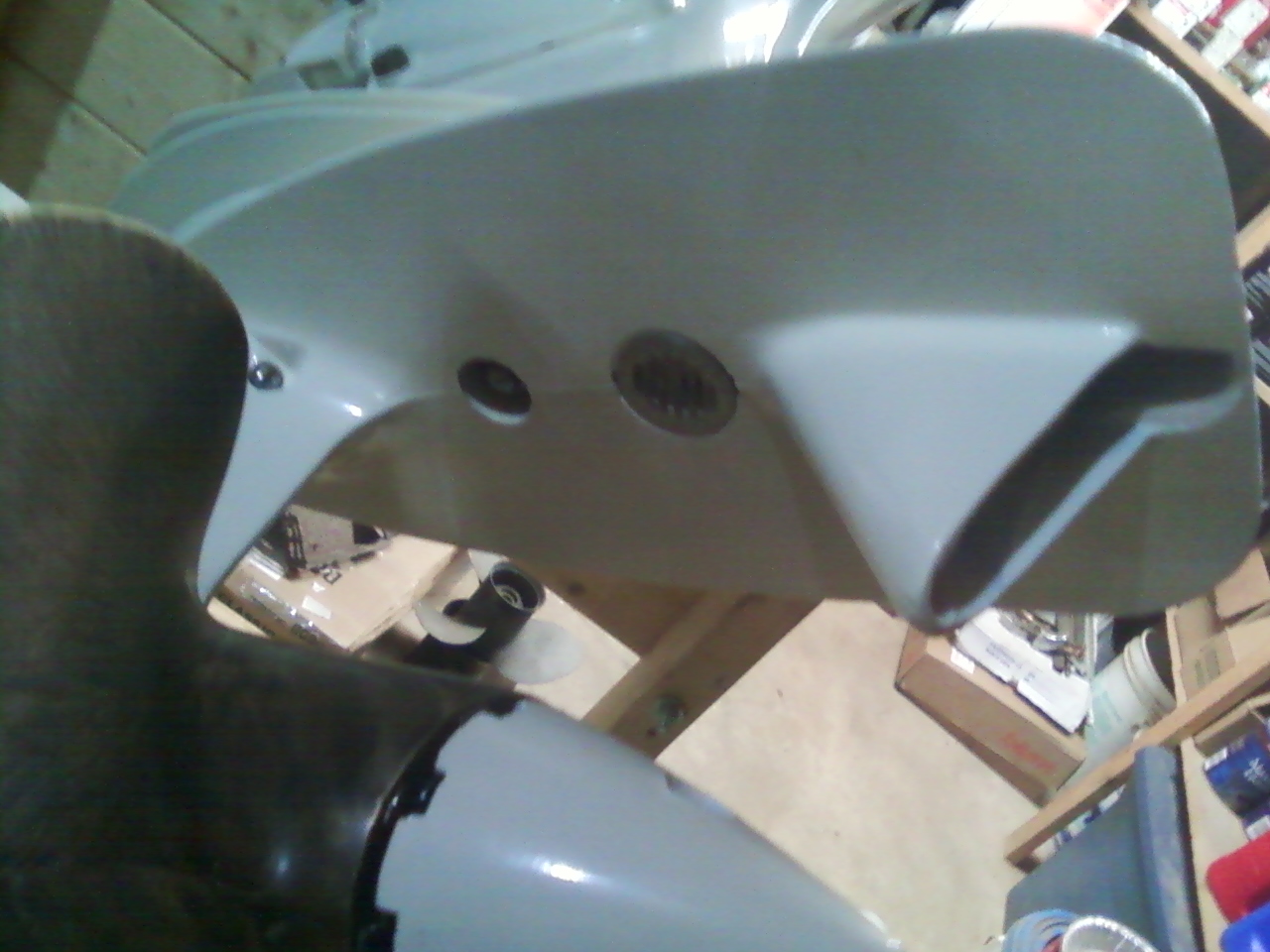

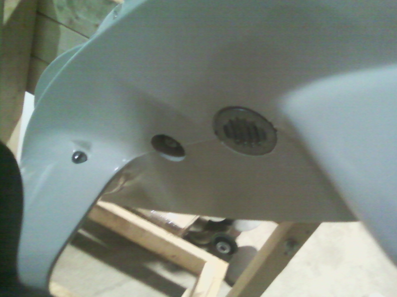

Here is my Mark 35A water pick up/ screen held on with two tabs that are twisted to tighten up top.
