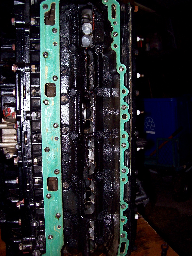

I got a screaming good deal on a set of gaskets off EBAY for my inline-6 a while back.
,....and the crowd asks,"Which inline-6???"
:laugh:
Anyway,...I finally got around to opening the set.
The gaskets are a bright, almost florescent green, and the fuel pump diaphragm is bright red. There are also some real light gray gaskets in the kit.
As I said, I got the set quite cheap, and now I know why.
I haven't found a gasket yet that fits. They are all too large.
In other words;
If you put the port-side baffle plate to block gasket on the block with one cap-screw in the lower aft corner, the lower fore corner hole for that cap-screw is a wee bit too far forward.
And the misalignment gets worse as you progress up the side to where the holes in the gasket for the top cap-screws are about a 1/2 of a hole too high.
I thought that maybe it was just a fluke - a one gasket oops - but the transfer port gasket has the same problem & the fuel pump kit doesn't align with the three mounting holes either.
I believe that somewhere I read that these gaskets are Italian made knock-offs, but I can't say for sure.
I suspect that whoever is producing them scanned an original, but didn't quite get their scan sized corrrectly before they programmed their cutter & started banging these sets out???
Sierra Marine is coming out with some gaskets made out of the same green gasket material, but the Sierra gaskets fit properly.
So,...Just beware - When "It's too good to be true $$" things like this pop up on EBAY,...It probably isn't going to work out.

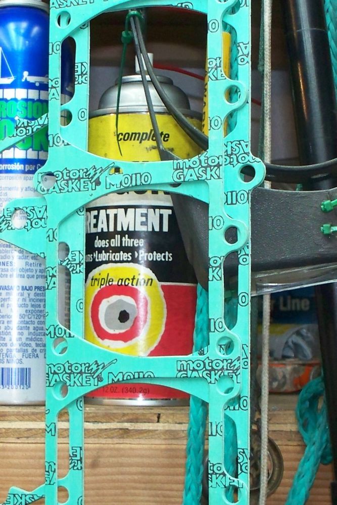

Here is a pic of the green gaskets I got.

I have attached a picture of the faulty gaskets to compare to what you guys used successfully.
Please let me know if these are the same brand as what you guys used.
Thanks,
Thom

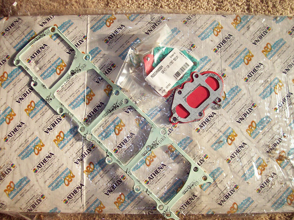

Re:After-Market gasket 14 years 10 months ago #52311
At first glance that does appear to be a DIFFERENT gasket than the ones I got. I will check today, the name on the gasket material does not seem right compared to mine.
I do have the same green rope though. :)
Re:After-Market gasket 14 years 10 months ago #52312
I stand corrected, attached you can see the same intake cover gasket as Thoms and indeed the writing on the gasket is the same. Also shown are the fuel pump kits with the red membrane. So, it seems we are all talking about the same kit. Athena is a LARGE gasket supplier in Italy and as you can see by the backing cardboard they were shipped to me on they were made exclusively by Athena for Pro Marine. Once again, I did not have any problems with the gaskets. I purchased on ebay as well.

Those are the gaskets I have and used, at least they look remarkably close. Mine had Italy somewhere on/in the package as well.

It sounds like I shouldn't toss the remaining gaskets, and go ahead and try them on future builds.
When I get the next inline-6 block on the bench I'll snap pictures of how poorly several of these gaskets fit. Maybe most will work fine.
