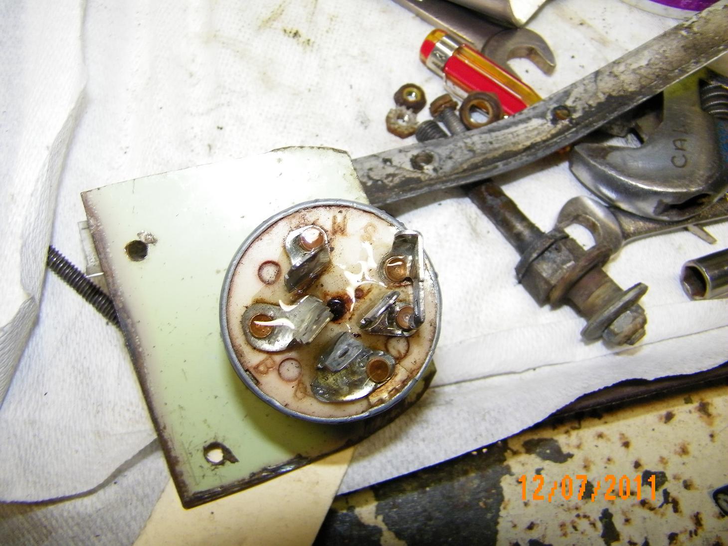

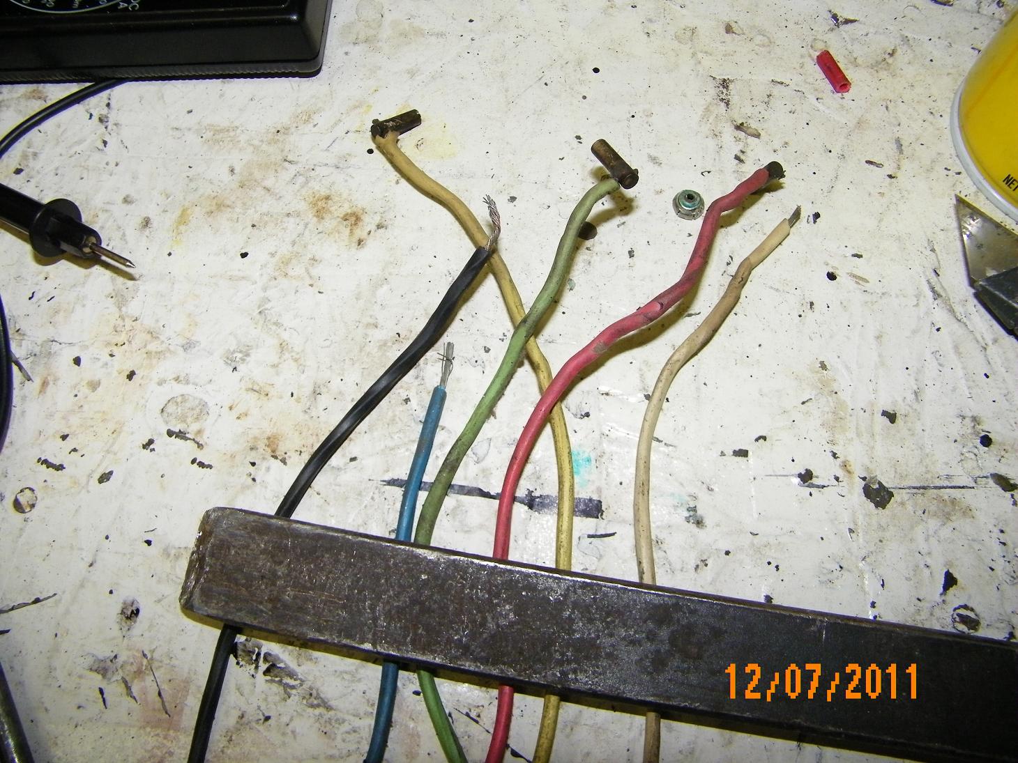

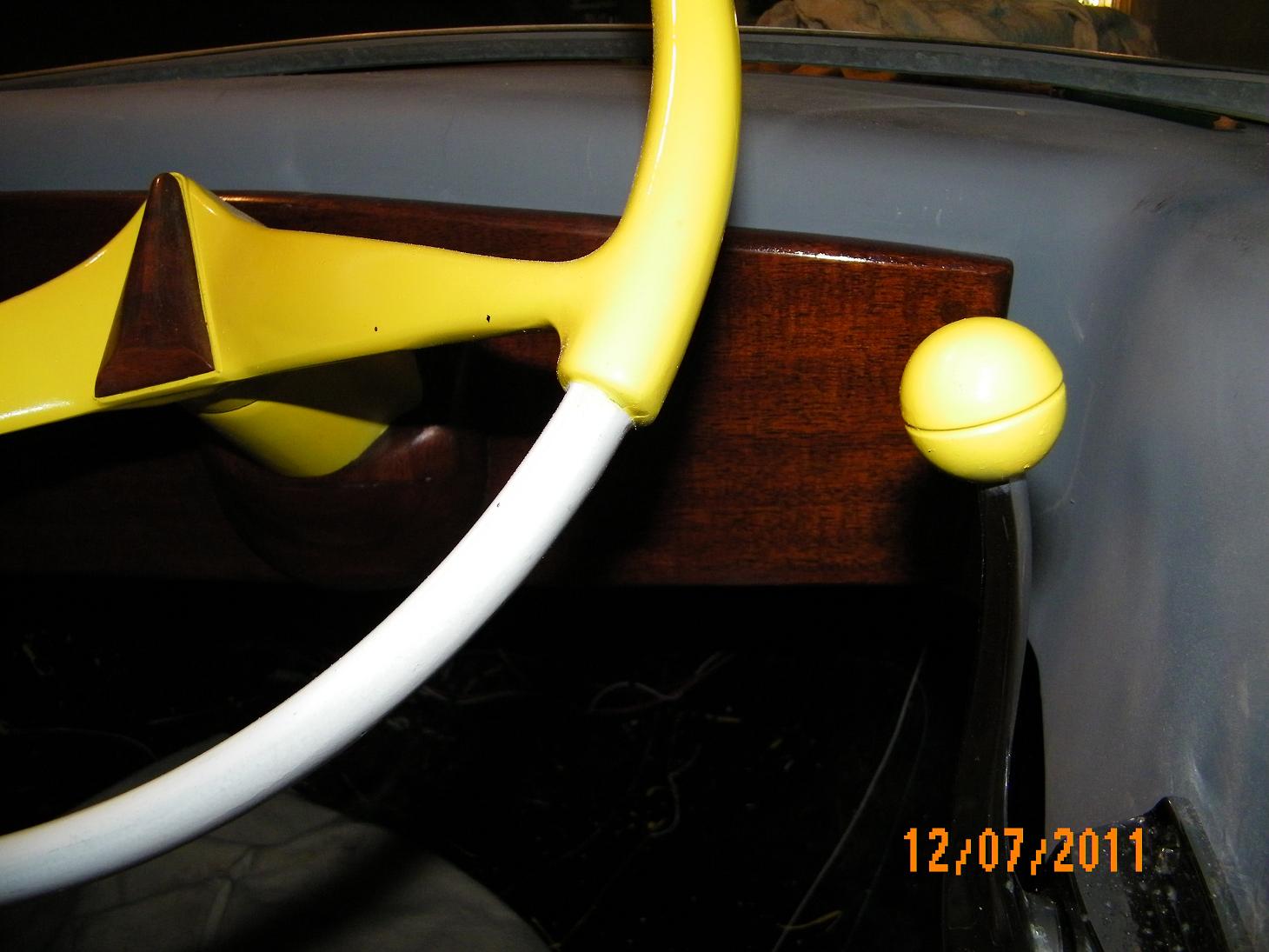

Another query on the wiring for the controls. Going to put a different key switch on the dash. There are six wires in the harness going to the shifter/ignition. I traced them with an ohm meter and here's what I came up with.
Blue-choke (thank you madprops)
Green-hot from battery
Red-to solenoid
White and yellow both ground to the motor and the Mag.
Black- I cannot find anywhere it terminates and get no reading on the meter.
My key switch is labeled B-G-M-S-Blank
B would be Green wire?
S would be red wire?
M would be either white or yellow? (shut down)
G would be either white or yellow?
Blank could be the Acc lead?
Here's where I plan to mount the key and choke.
Re:Two subjects on Mark 58 14 years 11 months ago #51953
Cal, I believe black is ground in all mercury controls

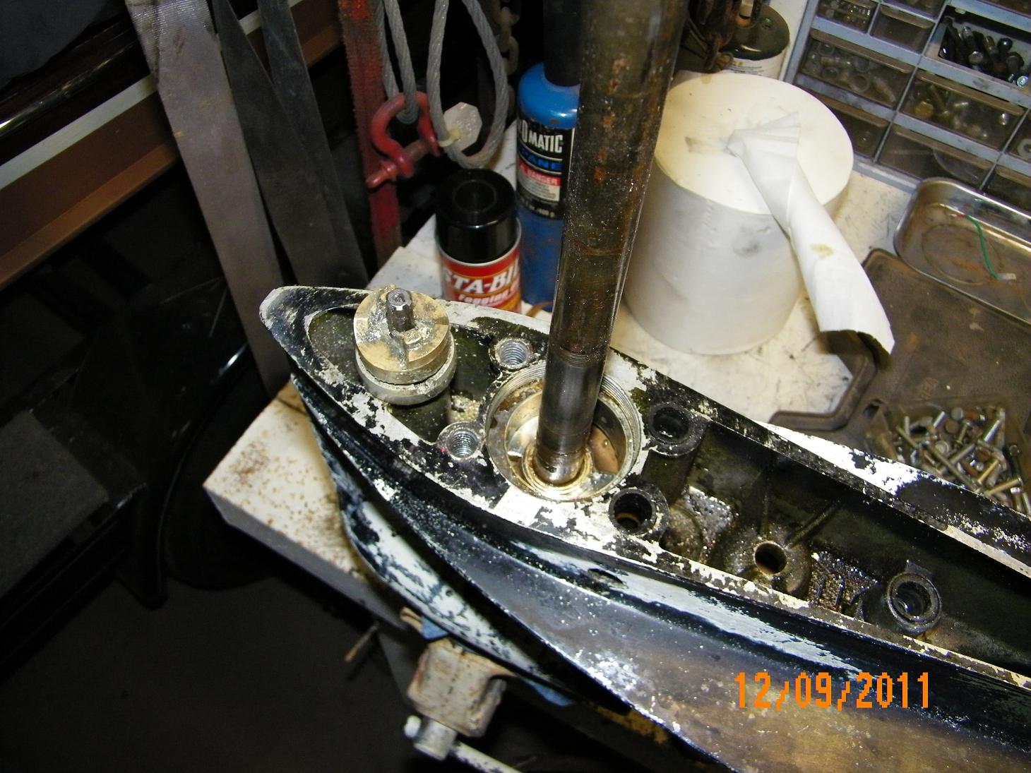

OK, I'm gunna keep pickin' your brains. Dropped the lower unit to pull the impeller, came upon this little jewel, not like the omc's I'm used to working on.
Does this thing unscrew? if so counter clockwise like a normal thing? Spending some time looking for a pin/spanner wrench to fit it.
Another thing, What's this screw for, will the lower blow up if I loosen it???
Re:Two subjects on Mark 58 14 years 11 months ago #52032
standard thread rotation, you need a tool, you can buy one from one of the members (John Macintosh) on johnsoldmercurysite.com
you can also make a tool from a adj spanner wrench drilled with a couple case hardened bolts driven in the holes
the screw you refer to is a grease cover plug
to install a new impeller

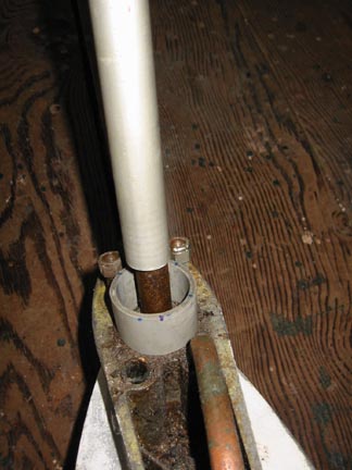

I use the cutoff end of an electrical conduit...I use a hose clamp to compress the blades then press the impeller into the conduit....using a felt marker clock the conduit with the installed impeller then I use a pipe that will slide over the drive shaft to drive the impeller into place
Re:Two subjects on Mark 58 14 years 11 months ago #52033
yes it does and that screw is the vent for the grease fill.
Re:Two subjects on Mark 58 14 years 11 months ago #52040

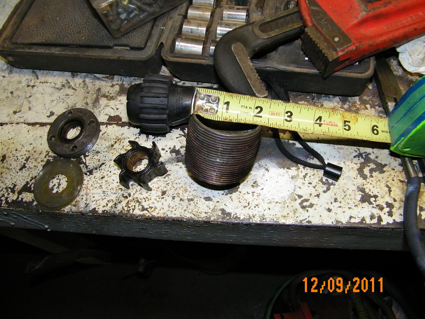

Re:Two subjects on Mark 58 14 years 11 months ago #52088
OOOOOPS... I read the last few posts too late.

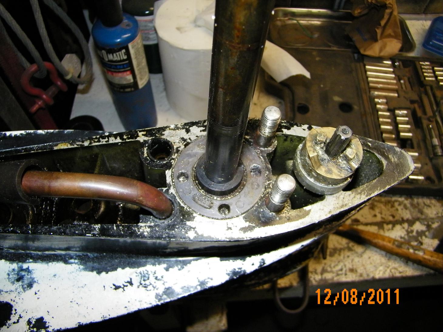

If you can put up with my lousey pictures and do not look at my spatter welding, I'm not a welder believe me.
Maybe I was lucky and everything was pretty well soaked with oil and there is no corrosion.
When I read the last few posts I already had the impeller out, darn...
I found an old 2 1/4" nipple in an old bucket, welded two 1/4" bolts in it, if welded is the proper term, more like attached.
The size is perfect to fit the holes on the cap.
A little carefull turn and the thing came loose without even so much as a protest.
The impeller is soft and supple but I'm changing it anyway because it has a pretty good set to it. Part # 18-3007.
Look past the junky toolwork bench after all it is work time.
The home made "tool"
Everything needed to do the job.
Inside is not scored or scratched.
The copper cooling tube was packed tight with seaweed.
Re:Two subjects on Mark 58 14 years 11 months ago #52103
  • ed-mc
  • Posts: 1482
  • Karma: 235
  • Thank you received: 131
That impeller was definitely a goner!
When you reassemble, spread a thin coating of Permatex #3 Aviation-Type gasket dressing (the stuff in a brush-on can) on the pump cover threads, this will seal them and keep Nasty Stuff out.
In the future, if the cover is ever hard coming off, a slight application of heat will release it easily.
Wish the ones I have would come apart like that, they're all Salty Dogs out here and require Heavy Artillery to dismantle!
Cheers........ed

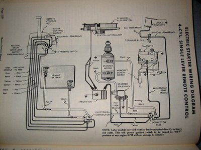

I'm beginning to wonder if my "Mark 58AE" is a real one or a conglomerate of parts. The black top, white shaft, black bottom. The mark 58 is stamped on the white transom bracket like normal but it seems that the wiring schematics that were linked here for the marks don't follow through with what I have. I have another shifter set with cables (green type) that I think I will trace wires on and see how different they are from what I have with the black shift setup. Going to take me awhile to work this out. Would there be a separate schematic for the 58, I see references to the rectifier and to avoid reversing battery terminals but no wires leading to or from it, No mention of magnito or do they just call it the distributor? Time to put on a google search again.
Re:Two subjects on Mark 58 14 years 10 months ago #52229
Cal
I posted the wiring diagram for your motor on the that Mercury site where you requested the diagram
the mag has 3 wires 1 is a ground strap, the mercury tilt kill switch , the other a KILL wire beige/salmon color wire to the key switch...I think check the schematic I posted for you

Re:Two subjects on Mark 58 14 years 10 months ago #52232
Cal you do not need the mercury Kill switch to run the motor
I will look in the junk pile I think I have a spare you can have
Im the one that posted the wiring diagram, on the other site
Re:Two subjects on Mark 58 14 years 10 months ago #52234

Madprops, I don't plan on rollling over anytime soon so the switch won't be necessary, thanks anyway. I think I have my wire route and colors figured out now. With a combo of the pictures and schematics. Did a lot of turning and switching and pickin' with my ohm meter on the old and new ign switches. What threw me off was one of the schematics mentioned positive ground so I did a lot of back tracing to make sure my wiring would be correct. The black shifter case and levers will be up for grabs for anyone who wants it sans the ign and choke buttons.
Re:Two subjects on Mark 58 14 years 10 months ago #52286
Cal its not for roll overs, its for hitting submerged obstructions, it kills the motor in the up position so you dont over rev it and it starts when the motor drops back down
