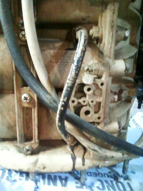

Hello,
I am going to replace the Fuel lines on my Powerhead. I am not sure what this line is and I can not find much about it in any of my manuals, How should I check it and is there any specific line type to use on this?
Thanks
StashM2
Re:1959 Mark 35A Powerhead ?? Bleeder Line?? 14 years 11 months ago #51690
it directs pooling oil away from the main bearing area , there is a one way check valve at one end fitting
you can replace the hose

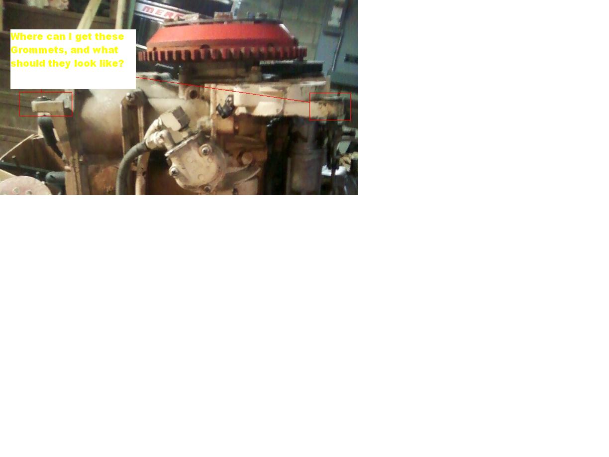

Also looking for the following.
The grommets for the top cover bolts go threw are shot on my engine is there a source for these? Also what should they look like? Mine has random spacers (nuts and cut tube)to make the cover fit properly.
Thanks for any help on this.
Re:1959 Mark 35A Powerhead ?? Bleeder Line?? 14 years 11 months ago #51738
the rubber bushings with the metal guide tube in them I have not ever seen for sale on ebay or anywhere
ask Joe Poole Jr, they may be available??
Re:1959 Mark 35A Powerhead ?? Bleeder Line?? 14 years 11 months ago #51742
does anyone have the dimensions I don't have any on my 400 except one rubber hose I just tighten till it fits
Re:1959 Mark 35A Powerhead ?? Bleeder Line?? 14 years 11 months ago #51748
www.fergusonpoolemarine.com/
Joe Poole IS the go-to-guy on hard to find Merc stuff, IMHO.
To be fair, Thom (Dr. Frankenmerc) has been known to come up with some rare finds as well! ;)
Note: I don't mean to "slight" anyone or leave any body out, just passing along folks I've had personal experience with, okay!?
Re:1959 Mark 35A Powerhead ?? Bleeder Line?? 14 years 11 months ago #51788
  • stashm2
  • stashm2's Avatar Topic Author
  • Posts: 666
  • Karma: 25
Thanks Everyone,
I contacted Joe Poole and he was able to help me on this part sounds like they are fairly scarce so I decided to buy some.
