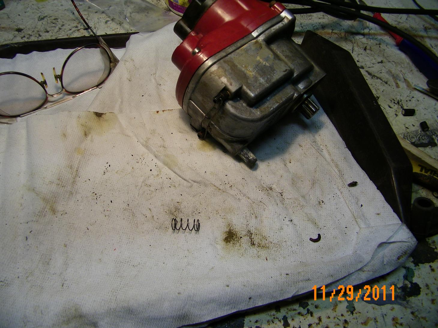

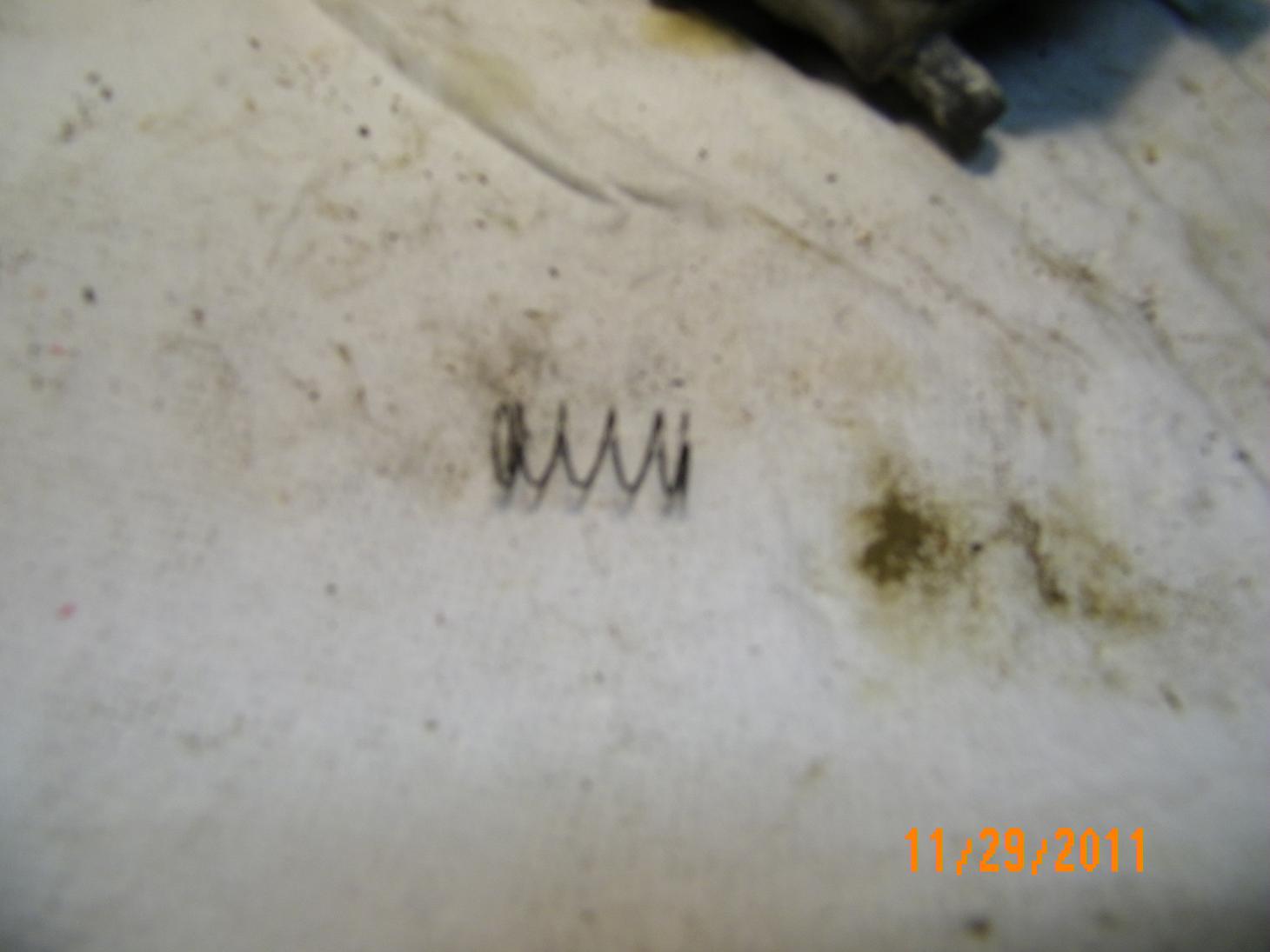

Put the magnito back together after polishing the points and cleaning everything up. Replaced all the plug wires and related procedures. This spring is laying on the tray. I checked the limited list on the manuals but do not see it listed or shown anywhere. Anyone know where it came from or did it just fall from a shelf on my bench.

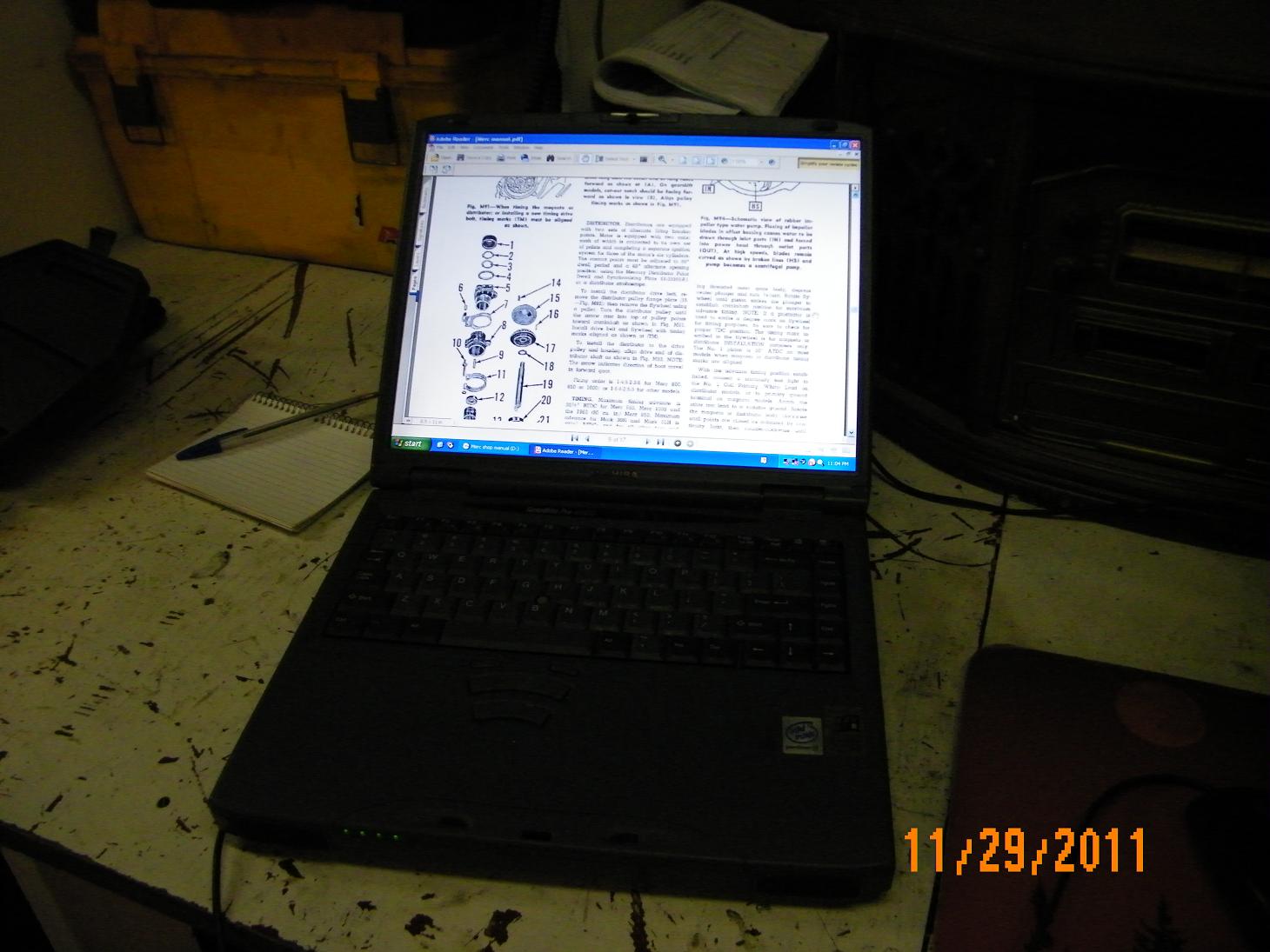

My beater laptop with the manual pictures, spring not shown.

63..: I just opened one up two days ago , will go to my workbench , 1st guess is under the center brass strap , that goes over to the CENTER coil wire carbon pickup .? I also have a SELOC manual here.
NO , I dont see any round spring in my unit, nor on page 5-16 of the SELOC, book... for TYPE I Points system.

that spring is not part of the unit.
