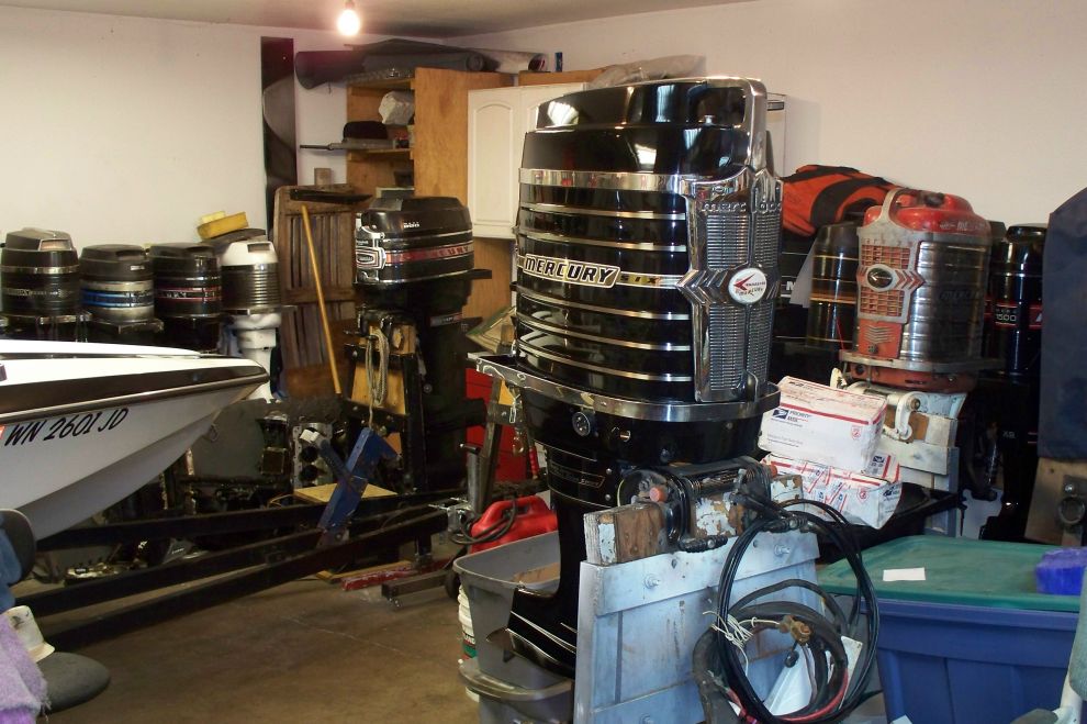

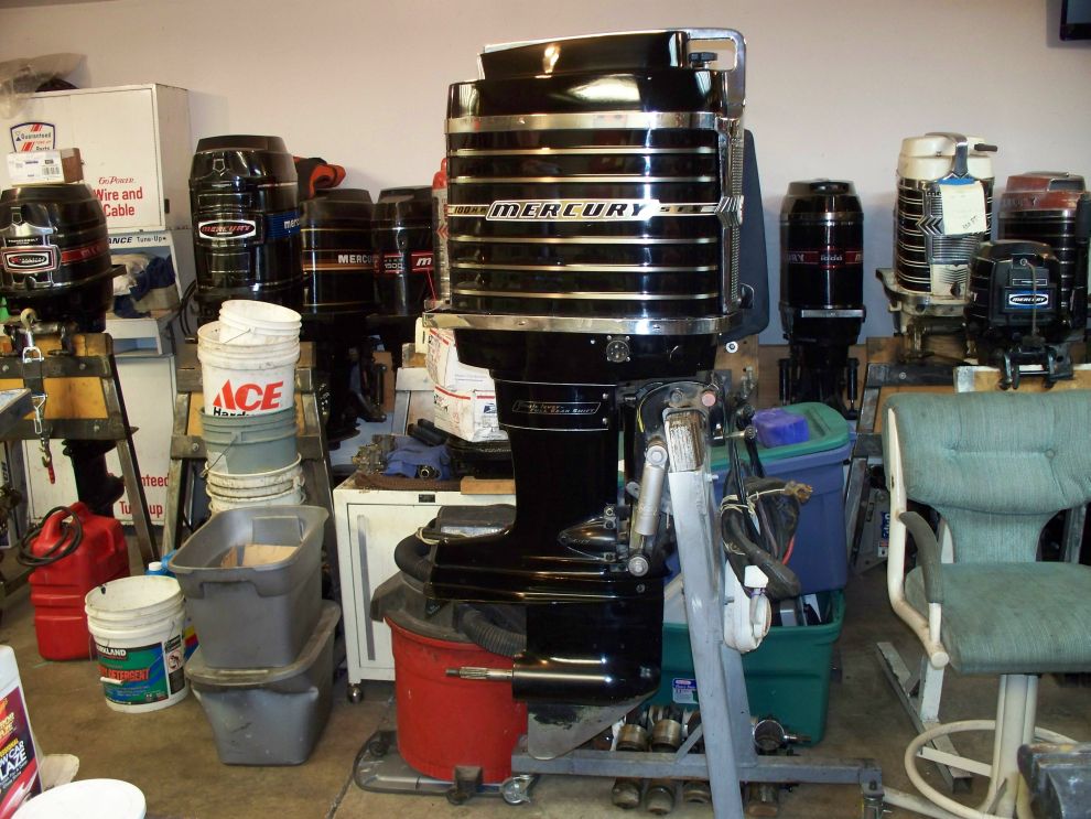

In 1962 Mercury painted the Merc 1000 Phantom Black, but continued to paint other models Cloud White.
The Phantom Black was such a hit with customers, that in 1963 ALL Mercury outboards were Phantom Black.
Last week Conrad, (Milkdud), shared a craigslist ad for a Merc 1000 short shaft that he had spotted. It was located in eastern Washington state, about 3+ hours away from me and over some snowy mountain passes this time of year, and 'several' states away from where Conrad is located.
Conrad asked if I thought it had a trim tab water pick-up, based on the poor quality pictures on CL.
I agreed with Conrad that I suspected he was correct & asked him if he wanted to buy it and have me ship it.
We both knew that on top of the asking price, ($500 for the boat motor & trailer), was way too costly for a Mystery Meat Mercury, but I asked anyway.
Conrad agreed that it wasn't cost effective.
I didn't feel like messing with the logistics of trying to tow a heavy old boat across the pass and on the freeway for over 4 hours on tires that hadn't turned since the 1960s, so both Conrad and I bagged the idea of buying this old Merc.
Realizing the old beast was probably one of the first Phantom Black Stacks, based on the possibility that it had a trim tab water pick-up,...I just couldn't stop thinking about the thing.
I called a pal that lives in the same city as the Merc and asked him if he would go across town and check it out for me.
He did and his pictures confirmed my hopes.

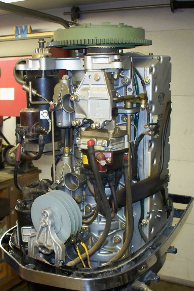

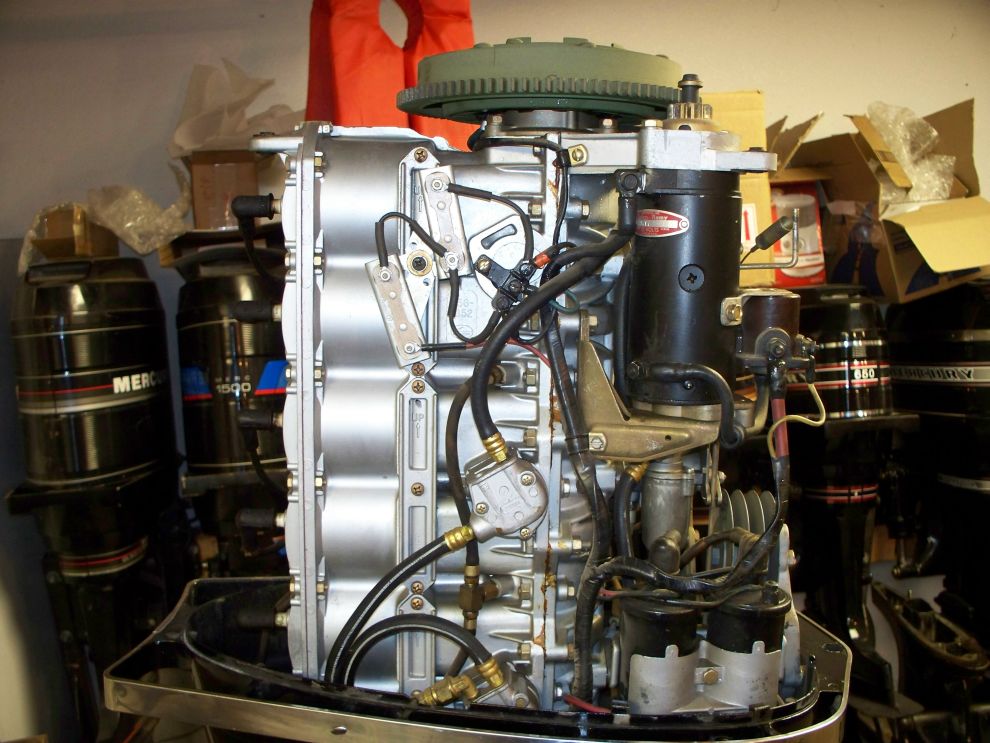

Not only was the beast one of the first Merc 1000(s), it was pristine inside and out. It was owned by a 93 year old grandmother that had asked her grandson to sell the old family pleasure boat.
She is still alive and told her grandson to sell the,..."1959 home built boat with trailer and 100 h.p. Mercury outboard. Been setting in storage and last used in the 60's. Boat needs to be totally restored. The boat is a 18' long. Selling for my 93 year old grandma, she said in it's prime it pulled 6 professional skiers at one time and also went salmon fishing in the ocean.",...
Initially the grandson did not want to sell the Merc separately from the boat & trailer, but I explained where I was located and the danger as well as difficulty and potential consequences I faced when considering towing the assembly across the pass.
Eventually I was able to bribe him into selling me just the Merc, controller, and any hardware I could talk my pal into stripping off the boat.
He volunteered to help strip parts off the hull with my pal just as soon as my pal showed up with cash in hand.
An hour later the Merc was mine.
I met my pal today at a half-way point and took possession of my prize.
It is absolutely gorgeous and completely original.
Not only does it still have the seal on the crankcase - it still has the factory seal on the distributor.
I removed all the spark plugs and tilted up the beast.
Then I squirted Marvel Mystery Oil into all the cylinders and after a few hours I began very slowly turning the crankshaft.
It turned freely and smoothly throughout the entire revolutions.
I added fogging oil and continued to slowly rotate the beast.
(I wanted to try and lube up the potentially very dry cylinder walls and rings in an effort to avoid scoring the cylinder walls. So many cool old Mercs that were left unused for extended periods of time have been 'ruined' by scoring the cylinders when the new owner simply hooks the motor to a battery and spins the beast to either try and start it or try and do compression readings without first carefully lubing the cylinders)
Currently I am just letting the oil mixture soak in for the next few days.
Then I'll probably do compression tests, spark tests, etc, etc.
For now I'm just slowly trying to get some white over-spray paint off the beast's entire exterior.
Someone either spray painted the boat or the building it was in at some time in the past.
The white paint is really stuck firmly to the Phantom Black finish, but it is coming off - slowly - very slowly, but surely.
Sorry about the 'novel' but I am really happy to have snagged this piece of Mercury History.

Congrats on a great find Thom, looks to be a real treasure there!

beautiful find Thom.

wow thom,thats a true beauty,and wow its clean,very nice find ,let me know how well it runs,although thats a given,with you working your magic on it,john

WOW..I'm too JEALOUS to be HAPPY for you! That IS a BEAUTY. :)
I found a similar early one years back in FL. I took it apart to reseal etc. A few interesting differences in the early ones.
Reed blocks are brass, Pistons are two ringers but the rings are thicker than the later two ring pistons. The rods must be slightly different forgings as they have machined beams that gets the whole rod to the width for the crank throw, later rods are only machined to width on the ends with the beam untouched. The early ones had the chrome top cowl trim and faceplate rather than the later aluminum. Obviously the water pickup is different.
Hard to believe that you got this whole, real deal, full size,
1 inch = 1 inch for less than HALF of what the K&O toy Merc 1000 goes for, the last one I saw sold for north of $1000.
Originally I was looking for the toy and realized I could get the "big toy" for less.
Nice score..

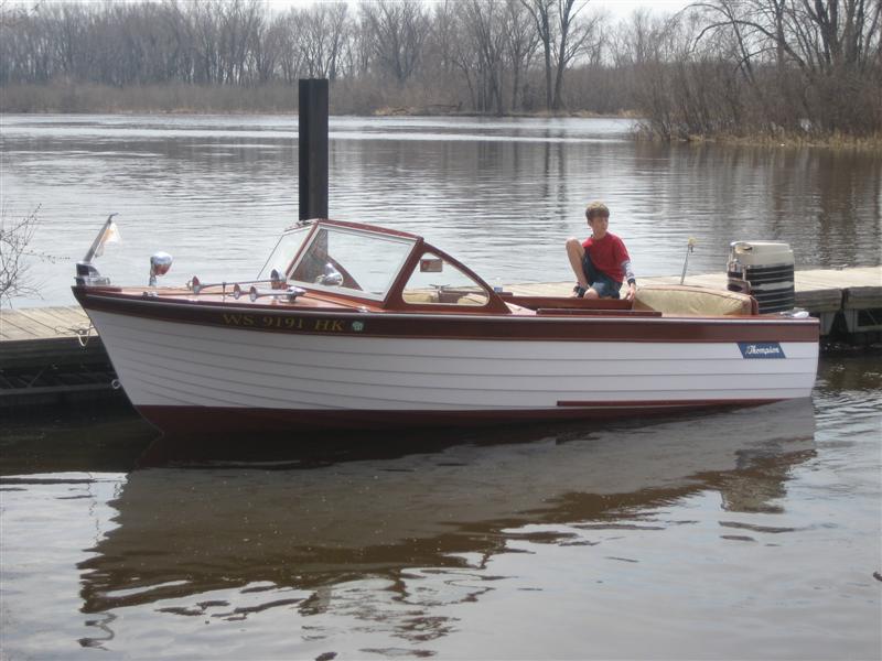

I have a 1963 Merc 1000 but she is not very pretty yet. She may find a home on the back of the 1959 Thompson of Peshtigo 18'-8" Off-Shore Cabin Cruiser.

Looks like it came right off the showroom floor. Beautiful find and worth the effort.

GULP,...
I guess I'm still on the hunt for the correct faceplate then.
This Merc was missing the faceplate, so I dug through my bins of faceplates and found the one you see. It is aluminum.
I will have to go back and dig through all the 'faceplate' bins and see if the correct one is in there somewhere, but I'm pretty sure I don't have one.
Thanks for the kind words everybody. I totally agree that such a find is rare and incredibly awesome.
This is as close to winning a lottery as I have ever come.
Thom

Thom, nice lil merc..... hey try some clay on that over spray, get it at most auto part stores. I have taken off alot of over spray-splater on several veh. I have owned, didnt hurt tha paint at all.
Re:The first Black Stack 14 years 11 months ago #51460
  • ed-mc
  • Posts: 1482
  • Karma: 235
  • Thank you received: 131
That clay stuff really works! I used it years ago on my '90 King Cab before selling it, the finish was full of tree pitch and other nasties and the clay took it right out. Smooth as can be, with the buffing cloth just sliding off the hood afterwards!
The abrasive effect of the clay removes defects but is so mild, when used with the spray wax/lube, that it can't possibly hurt the finish.
Thom, I checked the Shelton Wally's and they have a Mequiar's kit in stock, under $18:
www.walmart.com/ip/Meguiar-s-Smooth-Surface-Clay-Kit/16386193
Lemme know if you need some extra elbow grease!!!!..........ed
