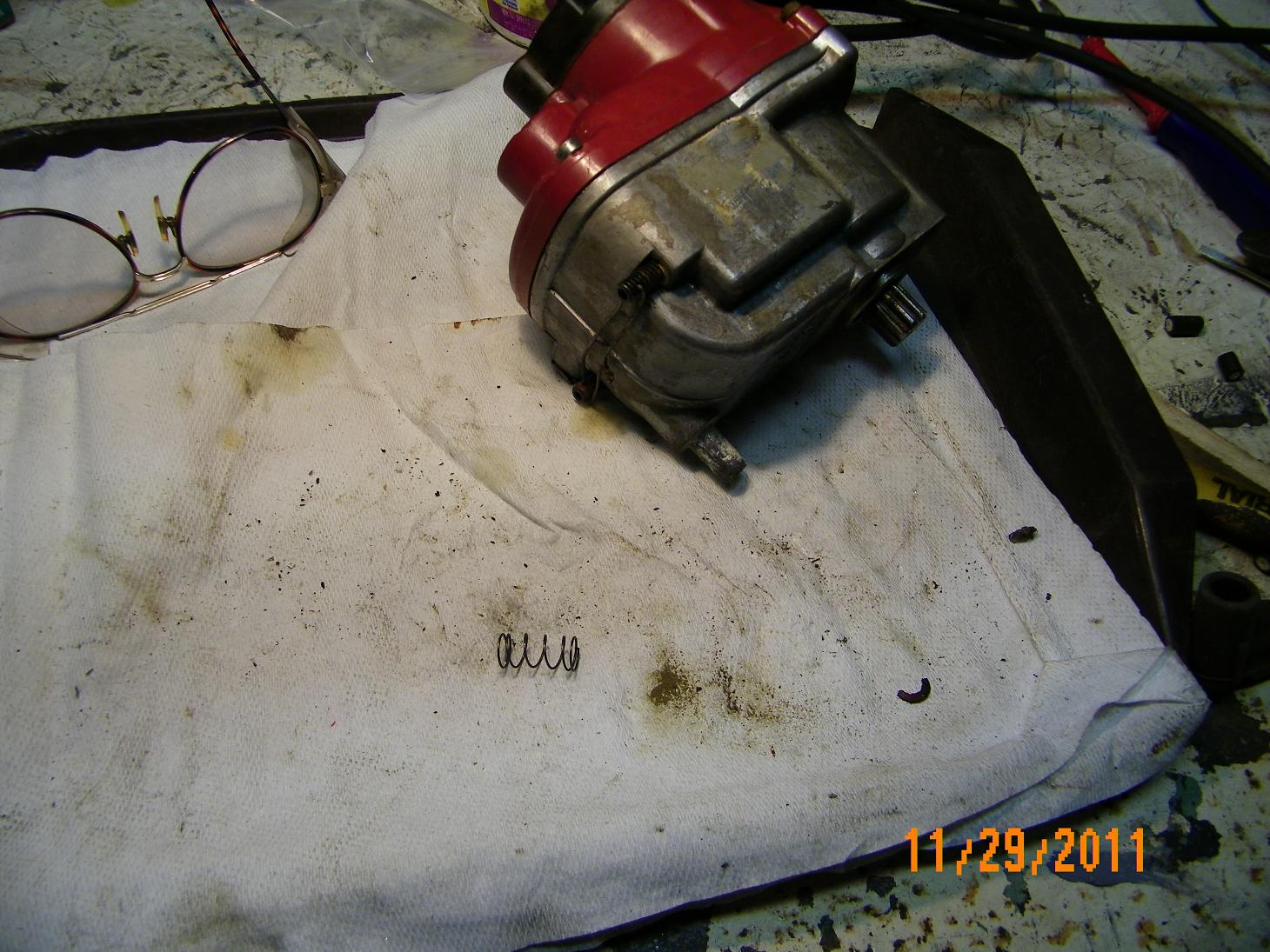

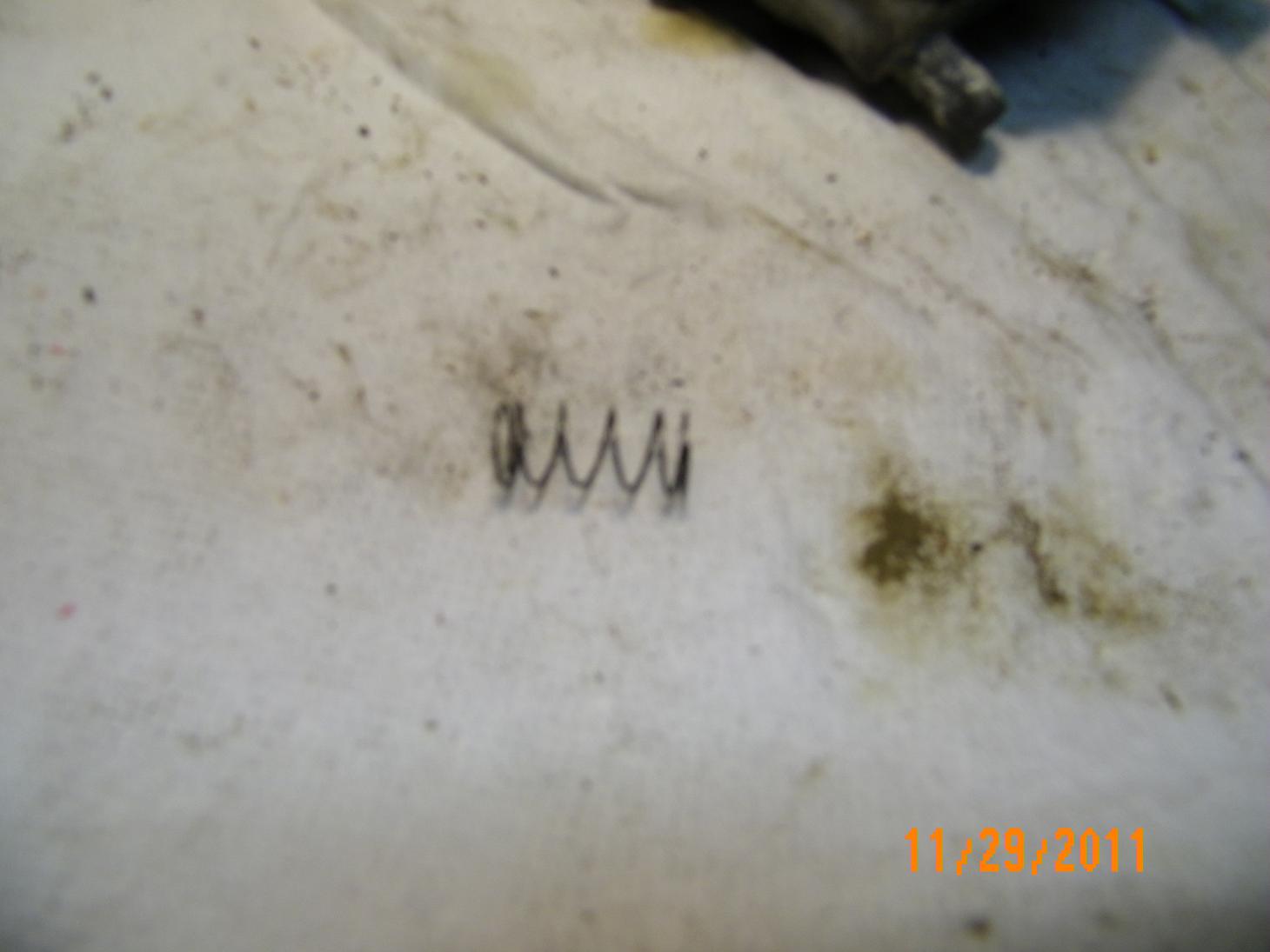

Re:plug wires 14 years 11 months ago #51371
Joe, thanks for the tips. I checked everything out as you said, the o rings are flexable and tight, the carbon rods are good, the screws are snugged up but I ran into one problem and don't know if I forgot a part or this spring fell from my bench.
I'll post another query about it also.
