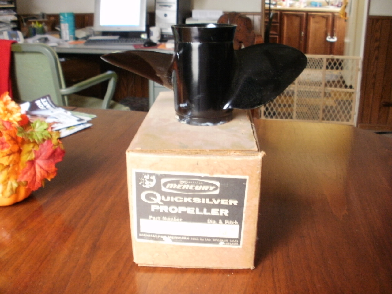

Sent you a PM on this, did you receive? I have a new-old-stock Merc propeller still in the box, Merc #48-56234-A411 It's a 2-blade aluminum cupped prop, 11" x 13 pitch. $50 + shipping.

K.M. : YES, Just sittin down now to go thru mail replies.. I believe
the 13 " pitch is going to be a tad small , for what I was hoping to use... I always hit the Sat am Flea Mkt & I did score a N.O.S. black prop , excellent price 13 spline, BUT it is a tad big for the 50 hp,,,, So will need to trade or sell that one.
