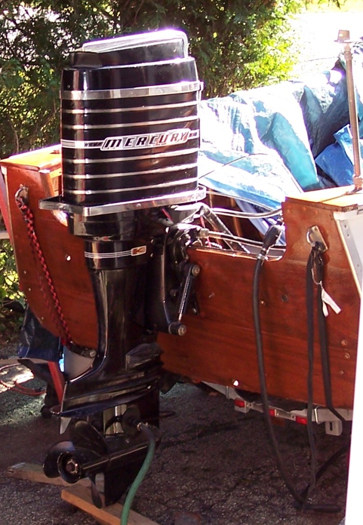

Anyone among us that has painted their cowl wrap? How did you go about it? Remove the decals of course. But then did you tape off the unpainted 'bands' being oh so meticulous then paint, or some other way. Did you polish the stainless bands first then tape & paint? Or did you just beg Doc Frank for an NOS wrap (still in the packing plastic of course. For Free of Course). I suppose its the tape and spray, but I figured I'd ask.
PS.... did you know that tack rags leave a residue that causes paint to bubble? I do now........

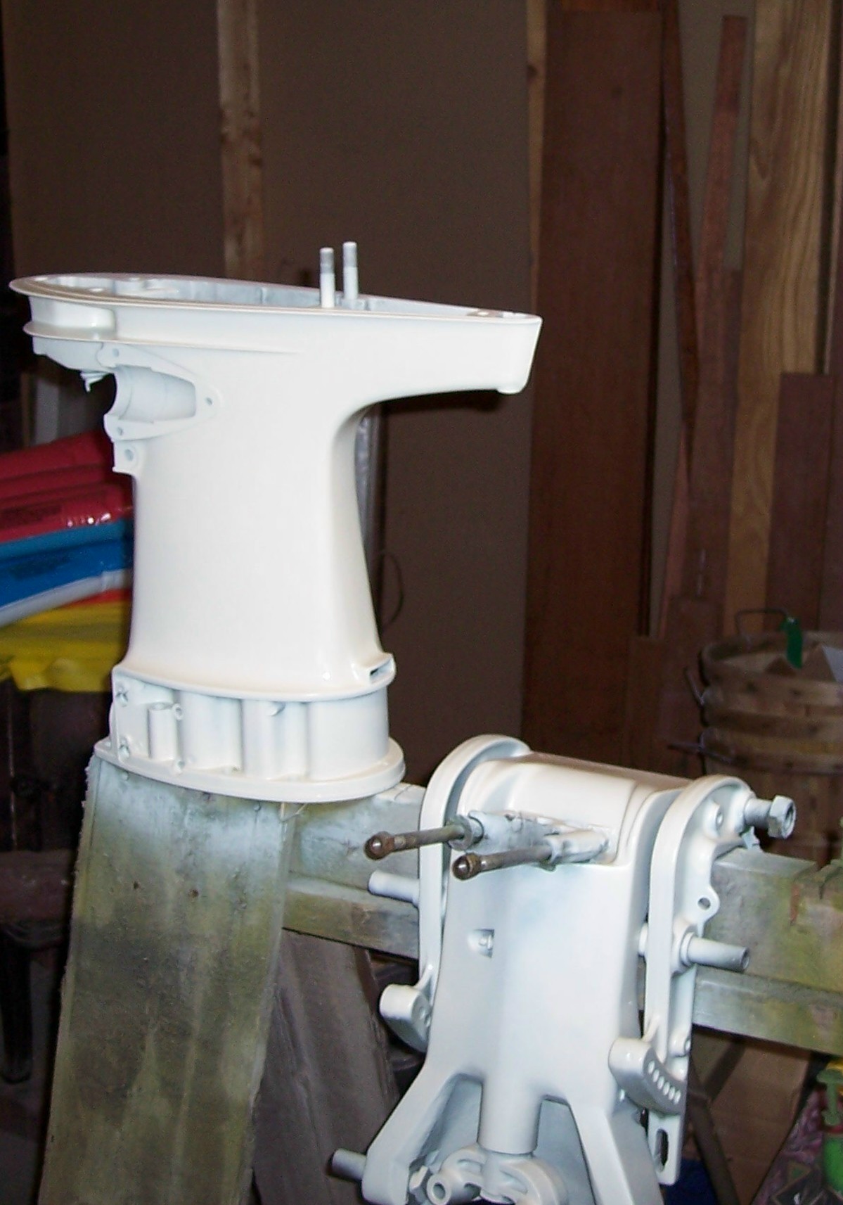

And here is my tip of the day for painting the mid. Bolt it to a piece of plywood. Frees up both hands to work on the piece and then you stand it up for painting.
and then there is the gratuitous cool old hull
Can you tell I don't want to go to work?

That is a painfully cool old lapstrake Peter. I like the idea of the plyboard for painting too. I hung the mid and its parts for the Merc 800

We hang everything to paint, much easier getting all areas covered.

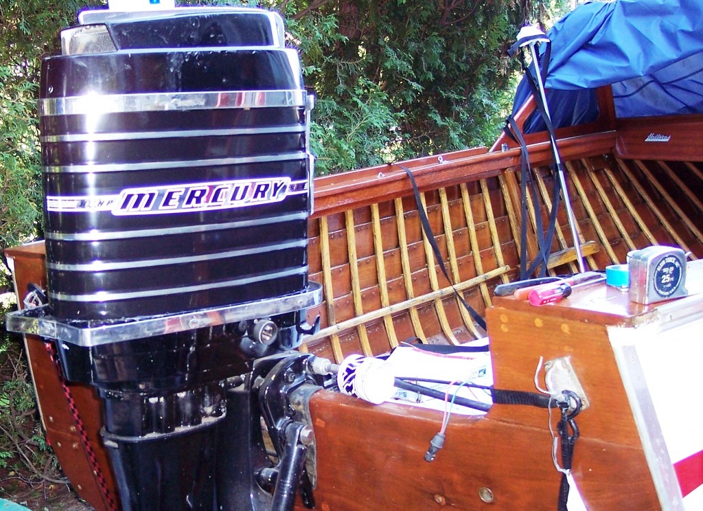

Thanks guys! Excellent feedback! Hope to be posting pics soon of the painted pieces.....
Well, not the cowl, that will be later
