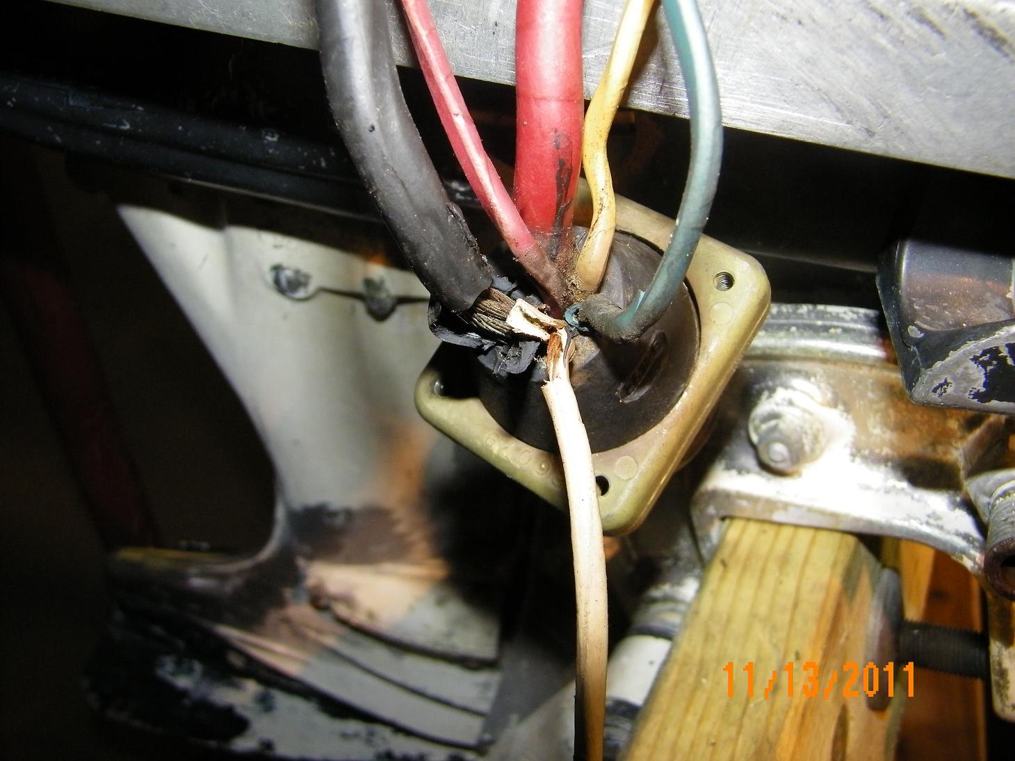

Ok, I'm going through the wiring and finding that all of it is rotten and brittle. The wires are bare as they go into the rubber connector mount on the engine. Is this fixable? I found another harness on a site but it is for a newer model and wondering if it would fit. The original part number is 26129. I'm looking at part number 23920.

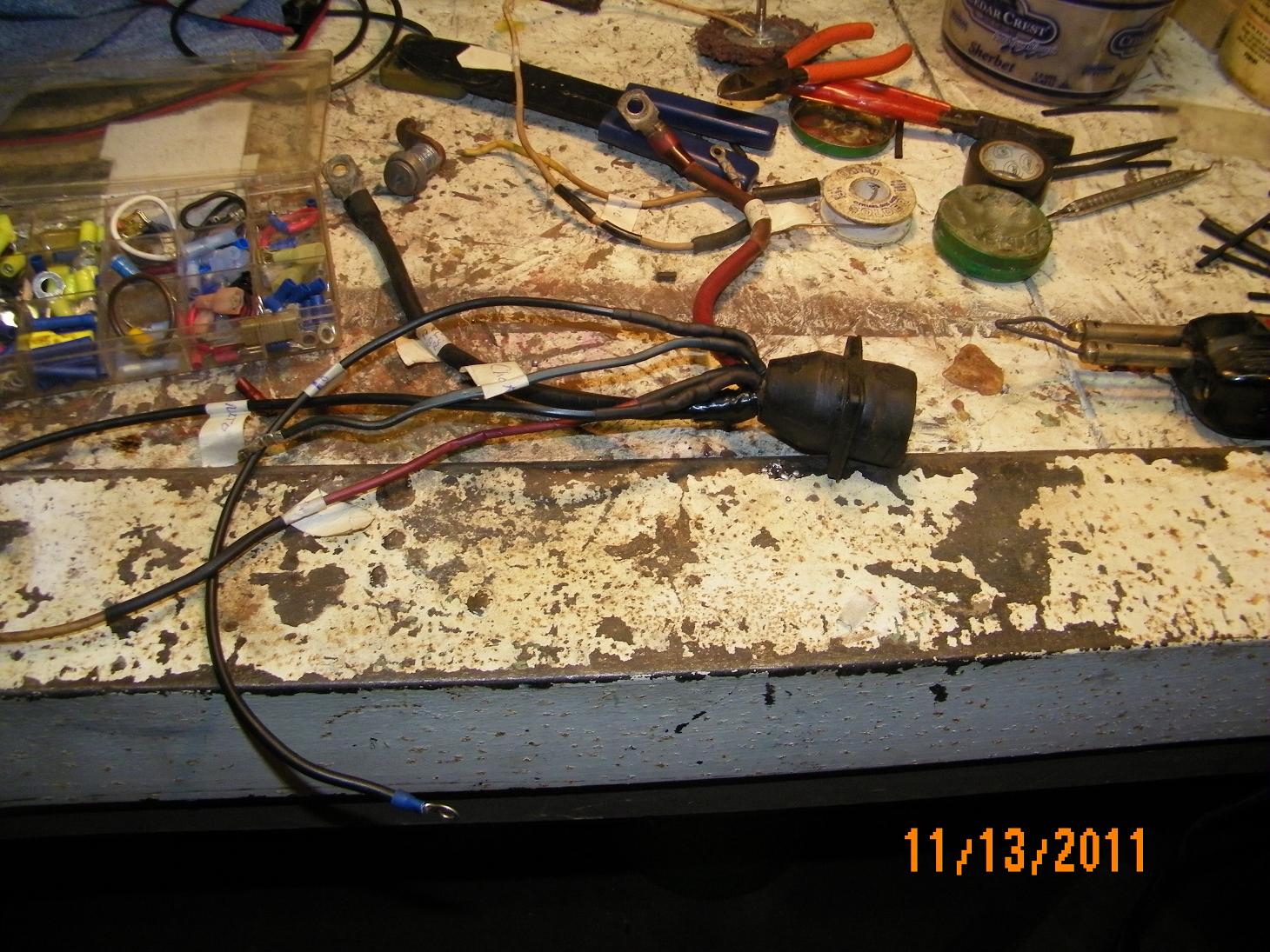

Seems like Jonrude and Merc use the same type of wire. I had to rewire a 55 rude with the exact problems this Merc has. I'm trying this trick I've done before that worked.
Here is the rotten wire harness.

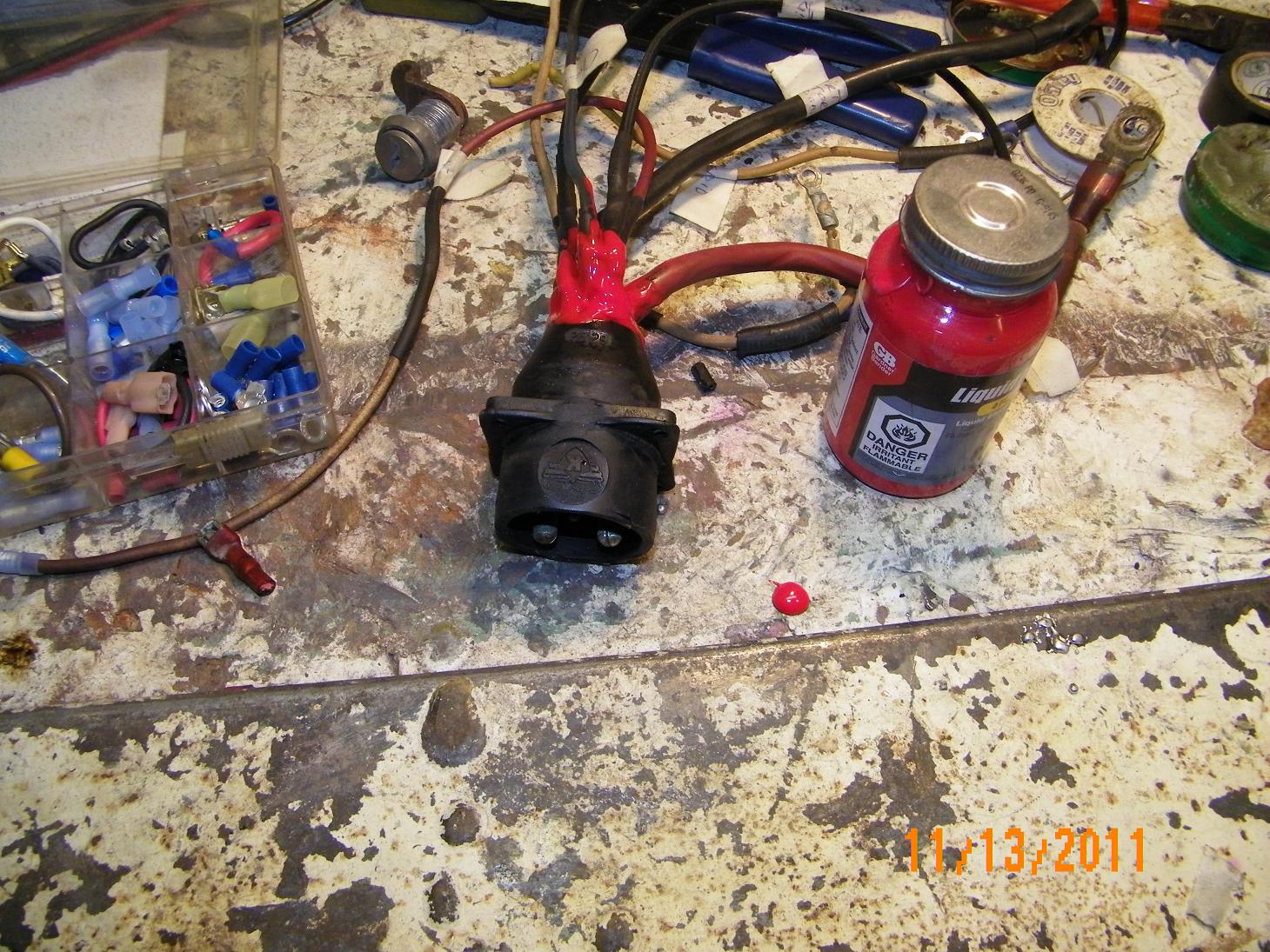

Took a dental pick under the mag glass and cleaned out all the crumbling gunk. Put heat shrink tube on the wires, double layered tight to the fitting.
For extra measure added liquid rubber tape to seal the whole works and keep it from pulling apart. Had to replace two wires that were crumbling and put new terminals on the others.
