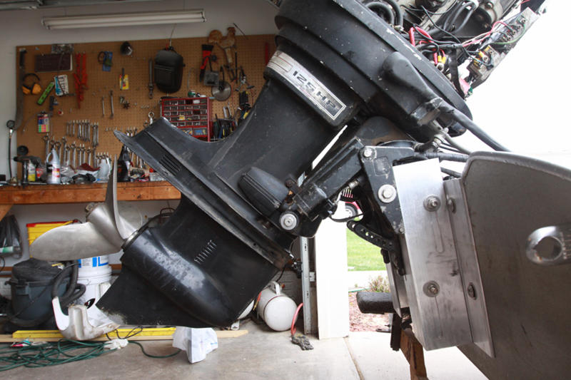

Well made my own jack plate out of 4x4/.25 angle aluminum and mounted the 1250 to the Carlson Contender.
Went out today and damn Thom you were right that 99 cube 1250 will flat out walk by my 93 cube 1100. The mid range punch is impressive.
Ok the question???
How to rebuild the transom swivel? It it the shaft or the bushing that wear?
This thing gets squirrly approaching 60 mph and its mostly due to the slop on the swivel area.
Conrad
Re:1250 Runs Nice 16 years 6 months ago #5007
Conrad I had 2 old mercs with sloppy swivels one a 4 cly & one a 6cyl in both cases it was the bushing worn and no problem with the shaft except one bushing was worn so bad 1/2 was missing and the shaft had wear from the failed bushing
milkdud eh ;)
edit: nice job on the jackplate, have any closeup pics?
Michael
Re:1250 Runs Nice 16 years 6 months ago #5018
Is that the stock lower unit? What kind of prop is that?

Yes its a stock lower unit. And that is a small ear chopper prop made by mercury. The small ear's were made for the inline 6 motors.
Ill take another pick of the jack plate tonight
Conrad

Yep I have a kill switch on it now. Boat ran away from me once at WOT. NOT GOOD.
I just mounted solid mounts and replaced the swivel with a good one. It is now tight as ever. Need to get dual cable set up soon to finish it off.
Beloit is not that far from me. I was thinking of going but not sure when it is? My boat is an ugly duckling so its not much for show. Its just go right now.
I hope to paint it someday.
