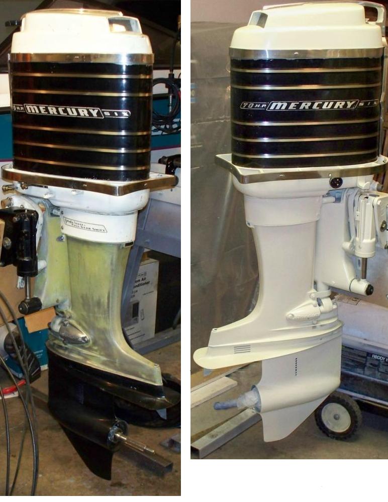

Re:1963 Mercury 850 rehab 15 years 3 days ago #49784
Randy,
Yes - your 850 comes with the correct swivel assembly.
Here is an example of how it will look.
Top picture is of a 700FGS long shaft with '70s PT.
Next picture is of an 800FGS short shaft with '70s PT.
These (2) models of Merc use the same relative components as the 850E-1 (your motor).
I did both retro-fits.
Thom
and,...Both have been upgraded to mid'70s solid state ignition too.

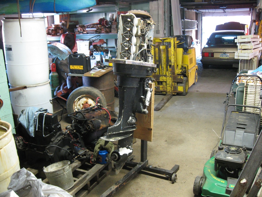

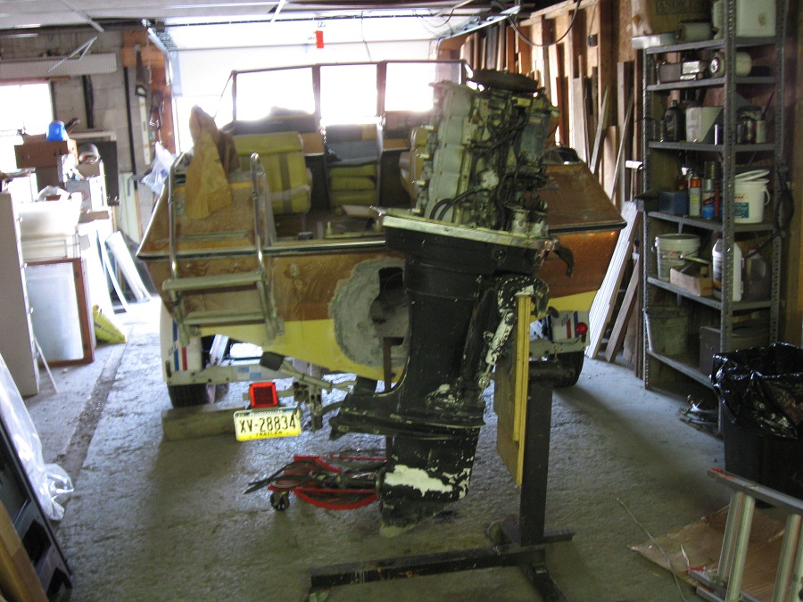

The prop came off without a problem, someone put antiseize on the prop shaft, smart move. It appears to have that thrust washer you are talking about. My current prop has a chuck out of it, and its probably repairable. I'm not sure of the size, the hub is hard to read, but its stamped 19P on the outside, assuming 19" pitch? I'll have to measure the diameter.
I also got the motor mounted on my engine stand. Currently its shifted in forward, but it won't shift into neutral, I'm guessing I may have a lower unit issue, not sure yet. Is there a hex head bolt holding the trim tab to the lower unit? The hole is full of mud....Here are some new pics, thats my `79 Glastron SSV177, in the process of going from @&$ to Mercruiser.
Thanks!
Re:1963 Mercury 850 rehab 14 years 11 months ago #50640
did you retard the mag before shifting? dig the mudd out of the allen bolt with a thin screw driver.
